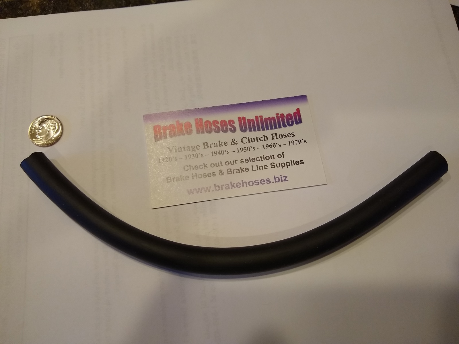

B,
I found that length of the brake reservoir hose that you're looking for. I had to buy a foot of it for my '80 KZ1000 LTD a while back and had some left over, as I recall. Let me dig through my stuff and if I can put my hands on it, it yours free for the asking! I'll PM you a little later today.
Mike

Hey, a couple final things on this,
First, Mike, thank you so much for the offer but I already bit the bullet and ordered a foot from Pegasus. Now we will both have off-cuts for the next guy.
Second, that purchase was to hedge my bet after placing an order for the stock one TexasKZ spotted on Partzilla but I just got the "Backordered (No Current ETA)" notice from them so I'm guessing that stock hose has gone the way of the Dodo.
