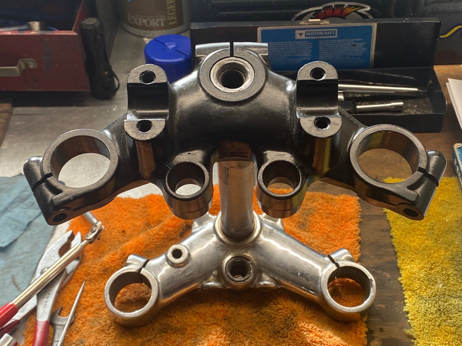

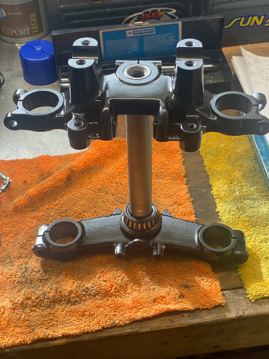

03 Apr 2022 18:43
Glad you found one. I finally found mine. I have two, shown below. The first one is from a later machine. You can see that the front/back difference between the forks and the tree is quite small. The gauge mount is different from my 650. Not sure about the second one but it has a standard gauge mount and a typical distance between the forks and the tree. The lower is chrome but the upper is black. I painted both trees.
