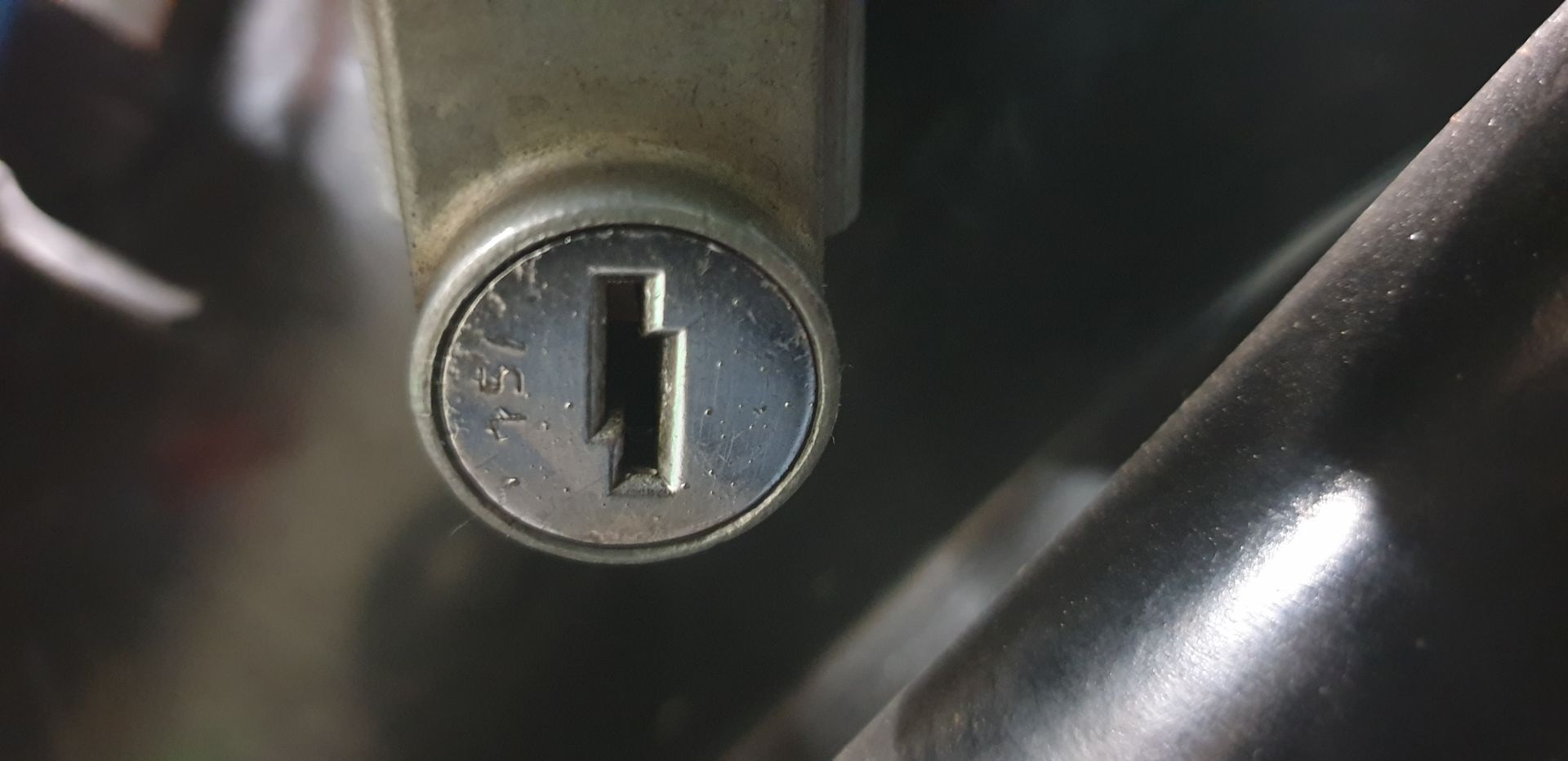

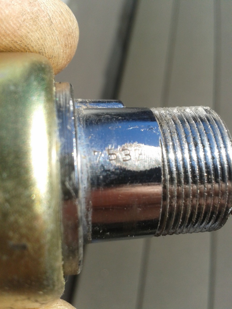

You can't access the hinge bolts or the lock barrel bolt when the seat is down and locked. The only way to raise the seat without a key is to cut the seat cover off, remove the foam revealing the nuts for the seat lock clasp on the seat base. You would only do that if the cover was wrecked or you wanted to recover it.
Sometimes the key on the ignition does not match the seat lock.
If the key number is not on the face of the lock cylinder, you can read it with a mechanics mirror on the body of the lock cylinder.
