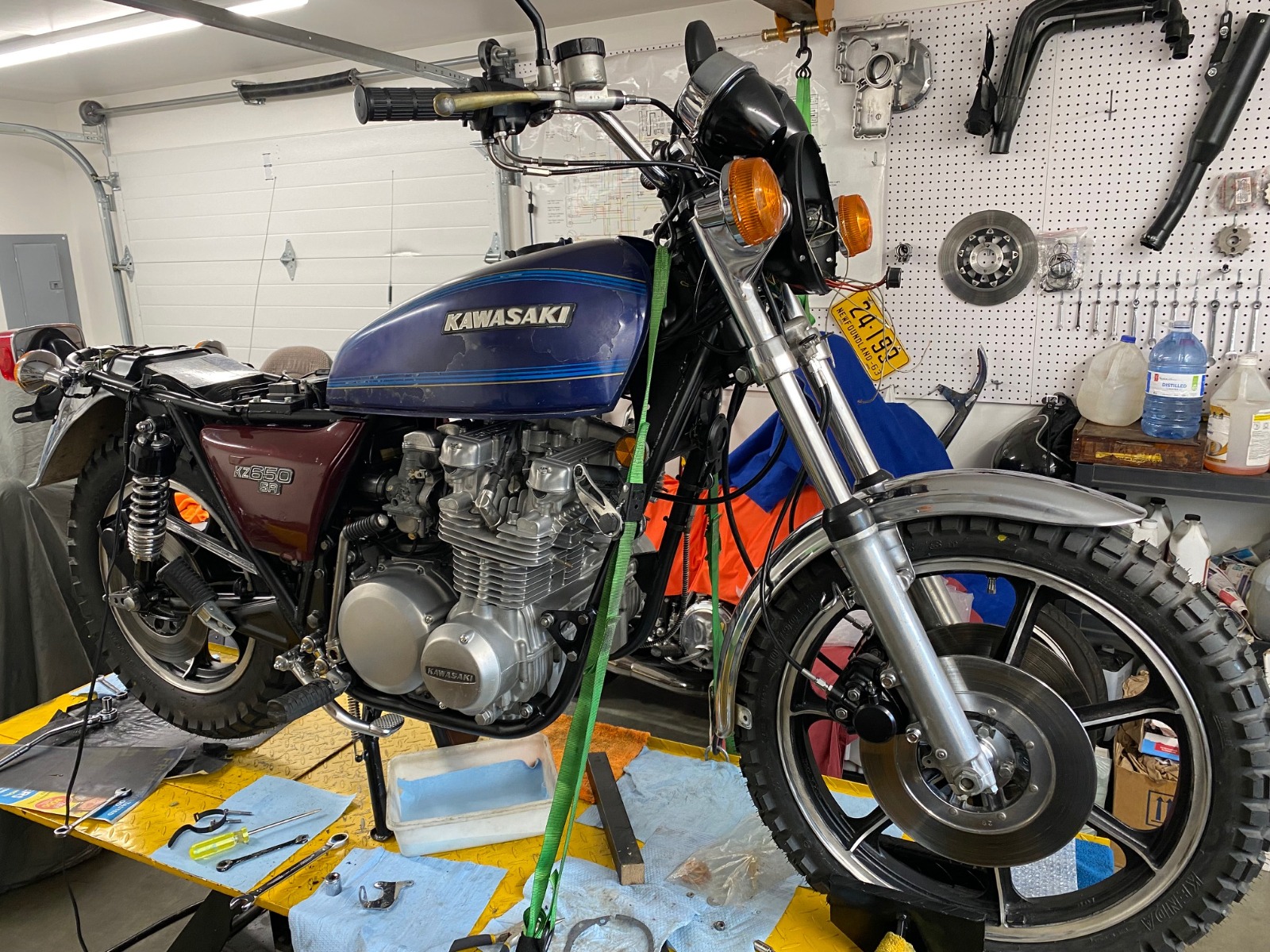

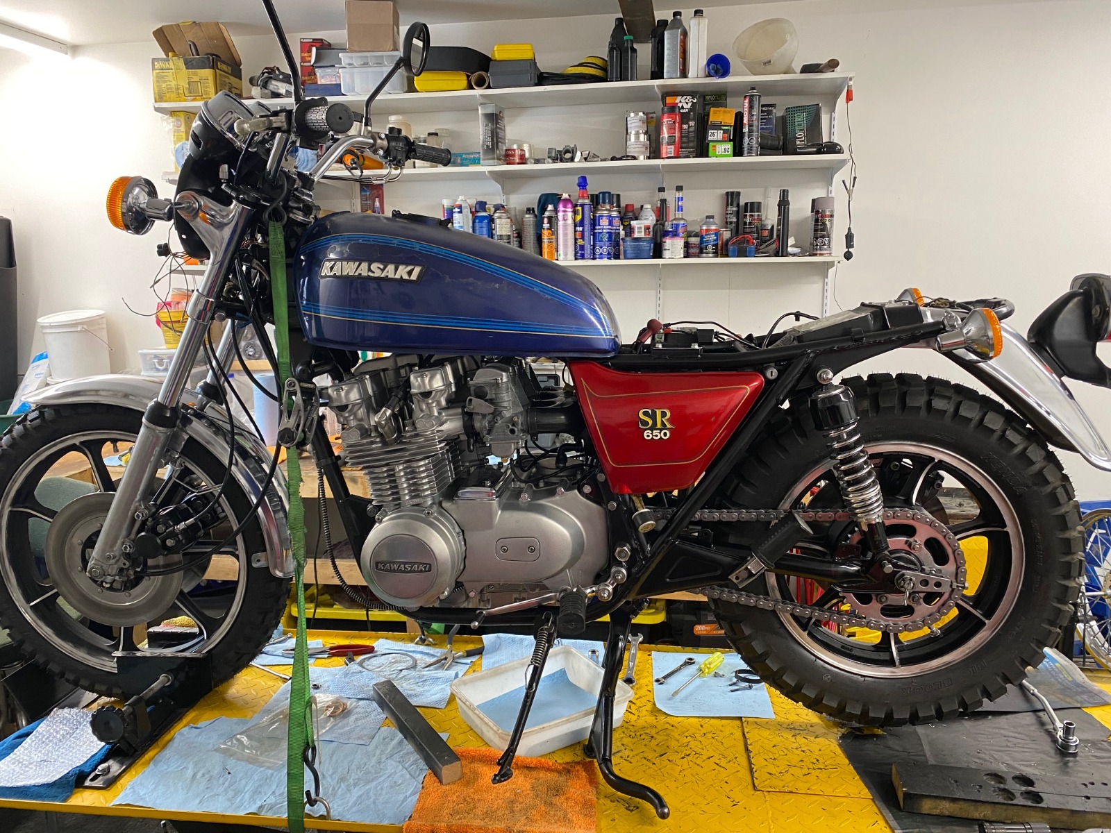

The C and D bikes both use the same rear master cylinder. The D version is known as the 650 SR. I have one.

I should have been a little clearer. When I said I have one I meant that I have the entire bike. It's a D1 that I'm currently rebuilding it, about 75% done. I don't have a spare MC.
