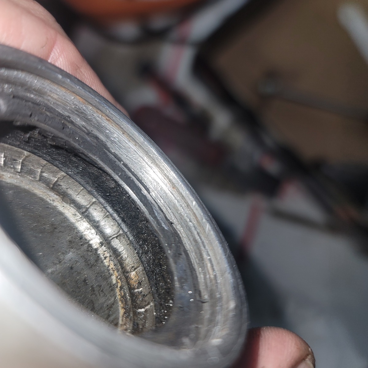

Everything has come out okay, but the fork seals are basically bonded to the metal.
I tried heating I've tried chilling I've tried scraping pliers picks wire brushes xacto knives. I've replaced fork seals a couple times in my other bikes, but this is getting ridiculous.
The only thing I'm accomplishing is damaging the tube and seat. They aren't past the ability for some buffing and polishing and a new set of seals being enough, but I can NOT get these things off. They just break apart.
before I spend 8 hours per tube just picking them off molecule by molecule, or just saying screw it and buying a couple forks, wondered if anyone knows of a solvent that will dissolve them, or maybe a trick.

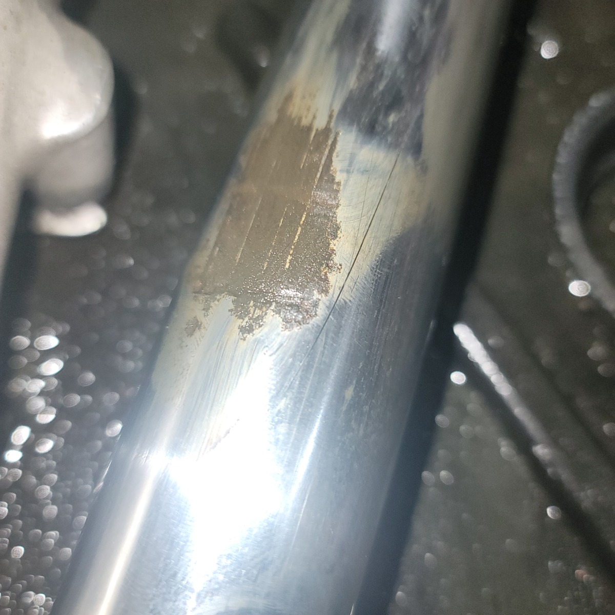

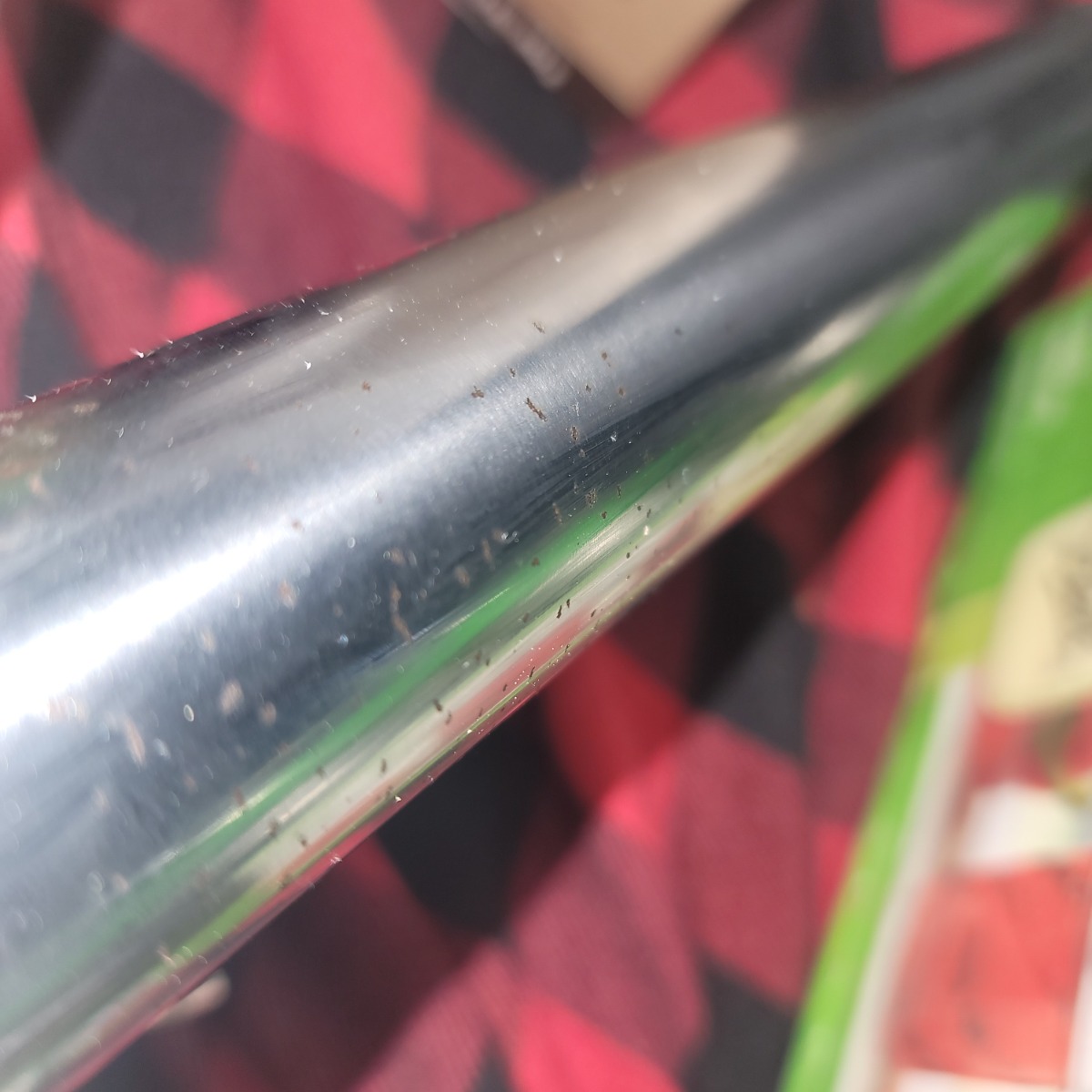

Also, the upper tube has a little pitting. Most of it is above where the tubes slide into eachother, but there is a little that goes into the lower tube when the forks are compressed. Spent some time with some copper brillo, and some fine steel wool, and got it in decent shape, but wondered if there was a fix for this. It mostly seems to be just through the chrome. I'm not big on the chrome, and planned to cover the upper tubes with a boot anyway, but wondered what people do in this case, and if I should expect some very minor pitting to effect anything? Maybe there is a paint that people use that will fill in these little pits that I can send smooth?
the other tube has a light dent in it, and it is within the travel, but for the most part sits inside of the tube probably below the seal, it does look like it was the seal seat that did it.
I guess I will need to put it on a straight edge and make sure the entire tube isn't bent, but. May have to replace that upper tube. Wondering if there is a fix for these things or if I should just get a better set? Maybe (dumb question probably) some sort of epoxy to cover the dent it's it's otherwise good?

Any pitting on the forks where they go through the seals and they'll leak. A dent tat size on the fork legs would probably mean that tube is bent, unless someone belted it with something.
I would probably be looking for either another set of second hand forks or replace the tubes, I wouldn't use the dented one for sure.....

I've never had a problem pulling a fork seal when I used heat and the proper tool.
Those fork tubes are trashed. Buy a new set from Z1E for $100 or thereabouts.

Yeah that's what I thought, I put it up against a straight edge and it doesn't look bent from what I can tell, but yeah that dent ain't good.

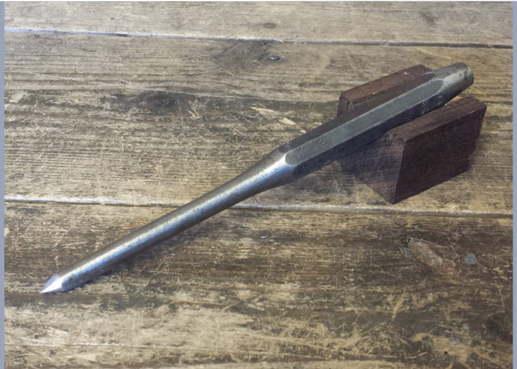

I’m sure the seal will come out. At worst and not my first choice but you can drive a punch between the seal and the lower. Pry the seal away from the outer wall it will pull the rest of the seal away from the sides. If you mark gouge up the side wall of the lower use some RTV black around the outer perimeter of the new seal. Have you tried a seal removal tool… they work similar in it pulls the sides of the seal toward the middle.

I had the same issue with my '79 KZ650. What I found was that the fork seals are made of rubber that is bonded to a steel ring, and that steel ring was really really stuck. The aftermarket seals were not made the same way. They were flexible with a spring inside.
In any case, if your seals are like the ones in my KZ650, just tugging on the rubber parts of the seal is never going to get that steel ring to move. You need a lot of force to move it.

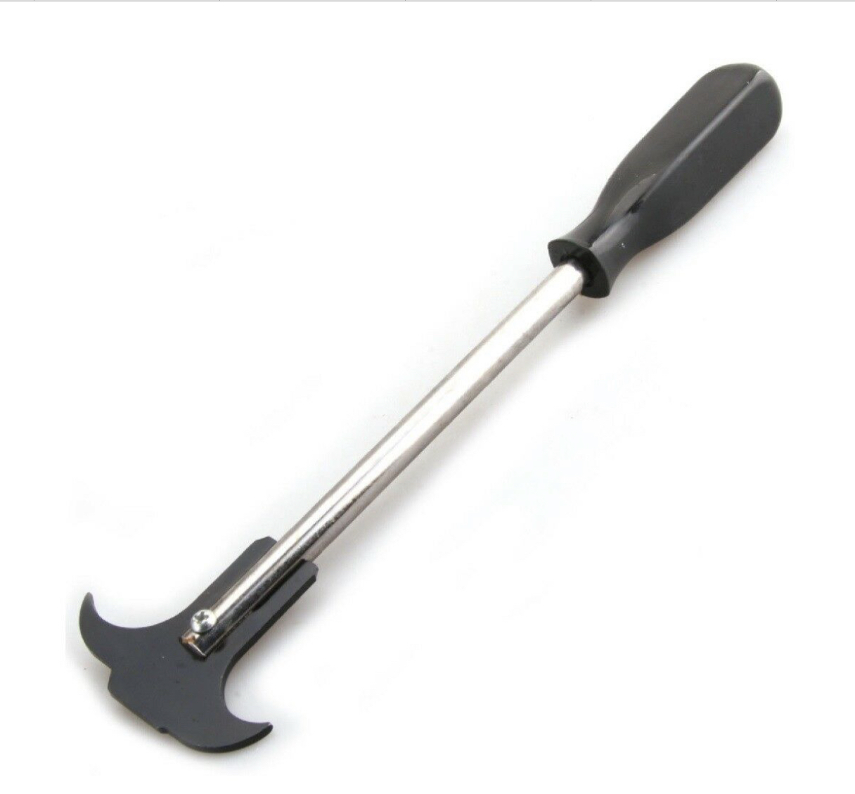

I would give the seal puller tool that Mikaw mentioned a try. It is made for this purpose and could work.
However, if I were going to do that job today I would find a slide hammer style inner bearing puller with the right diameter attachment.

I actually have one of those, and it was not coming out.
I tried that punch, and that worked. Good idea thank you.
The seals when I pulled them out a big chunk of It came out, which I thought had the metal ring in it but I did not realize that this ring was so big. On the other fork seals I've done it was not like that LOL.
So I thought this little metal ridge in here was part of the fork. So I was afraid to go ham on it but .
I got it out now

So that's exactly what was happening,
I pulled a piece of the ring out at the beginning that I thought was the only metal inside of the ring. On other fork seals I had done there was not such a large metal part
So as I was pulling it out I was thinking that the metal ring that I was uncovering was actually part of the fork so I was afraid to go to Ham on it
Anyways I have a seal puller tool, which is what I used to get the rest of it out, at first, and I was just not getting a good purchase on it and was afraid I would damage the lip of the tubes with how hard I had to pry so I just used a punch like mikaw said. I just hammered on one side and moved in a little bit until I was able to get a bend in it then I grabbed it with some pliers and they popped right out. Problem solved.
