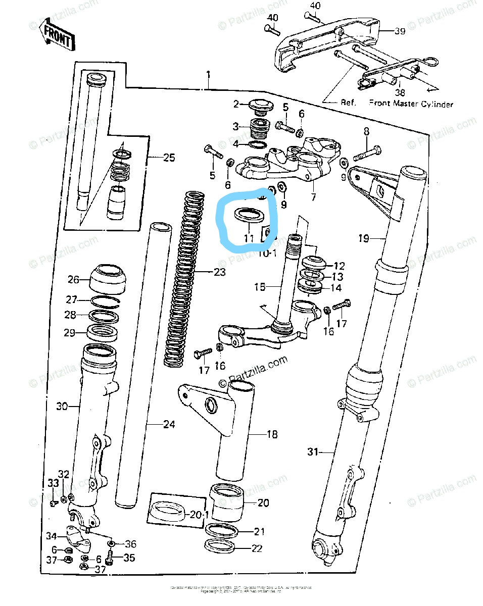

In reference to HRMs reply, this is the ring he is referring to I believe. Easy to leave it out sometimes.Rick H.

To add here, so far every suggestion is correct. There are also a rubber collar and another stamped ring that need to be installed for the headlight bracket to be tight. See red circle added to RickHs post.
