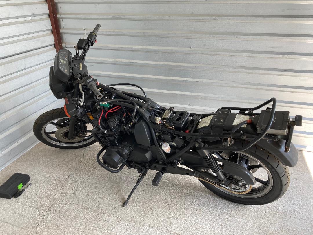

I didn't notice any different in height and the rear suspension is a little firmer but I'm OK with that. The ZRX shocks are adjustable. Here is a pic of what I had to do to my chain guard.
I'd definitely do it again.

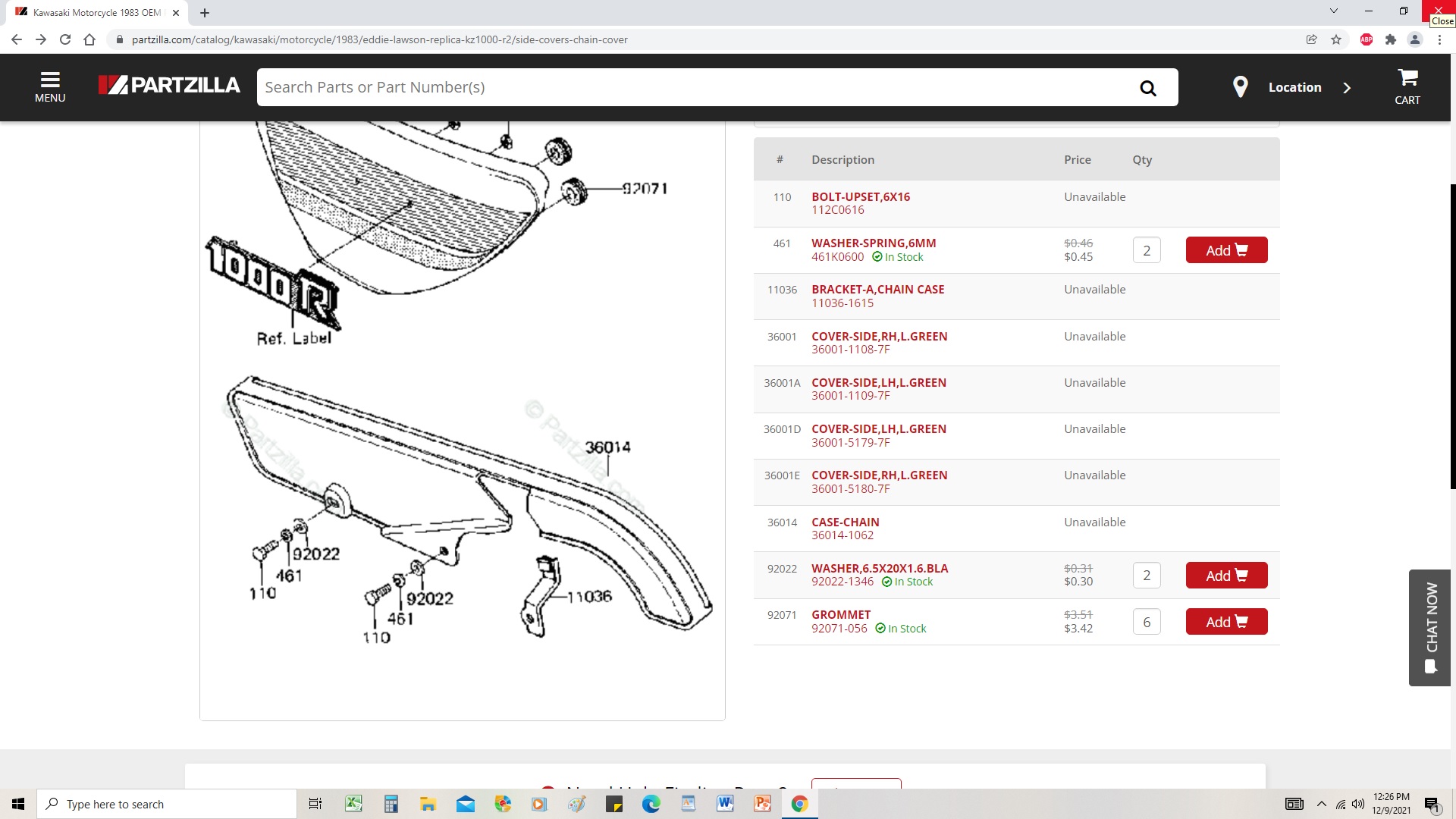

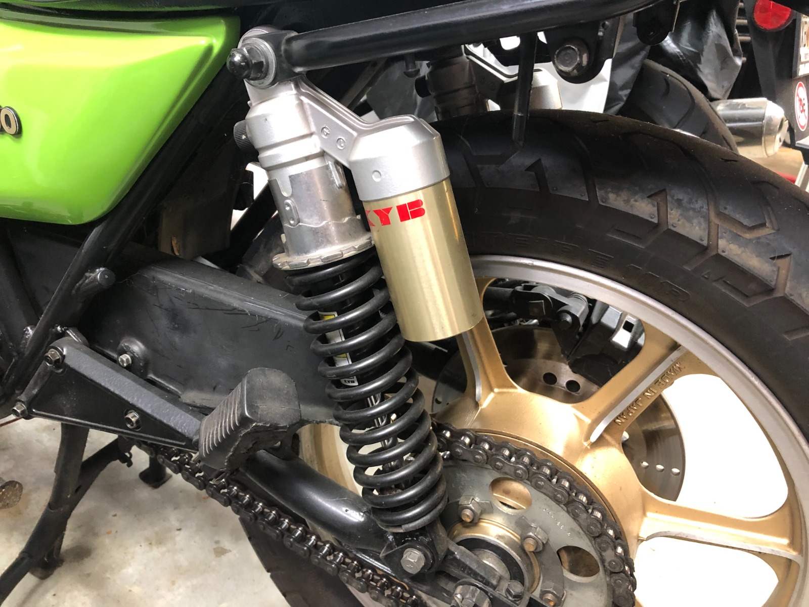

I got rid of the 40 year old pogo-stick shocks, and installed ZRX shocks on my '82 GPZ1100. Check for shock spring to chain clearance (it's real close).
You can keep most of the chain guard by removing some material, like they did with the ELR chain guard. There's even a special bracket to stabilize
the chain guard (#11036).
You can see what the chain guard looks like on my GPZ, after it was trimmed.
At some point, I will probably have the shock moved outboard, using a new mount from Z1 Enterprises (part #DC104CL. $9.95/ea.)

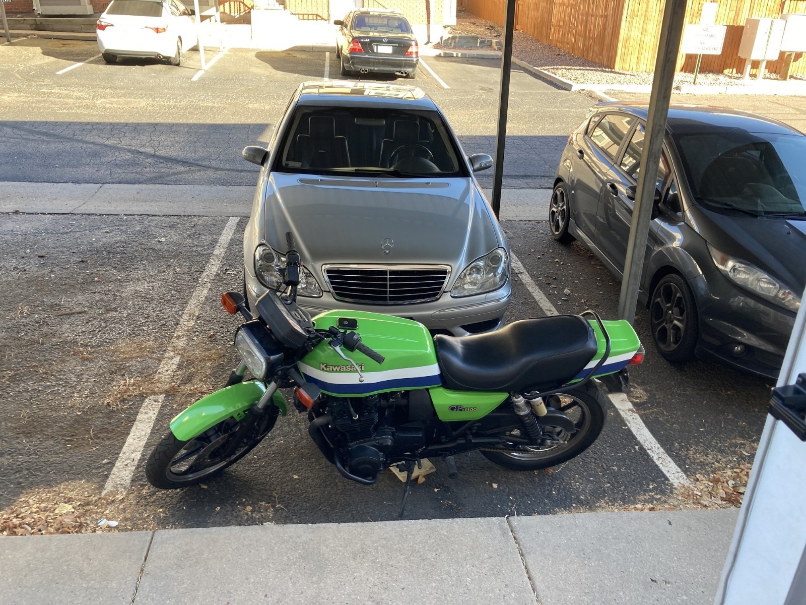

Here's a recent pic of my bike with the KYB shocks on it, and a pic of Eddie Lawson's personal KZ1000R.
You can see the special factory bracket to support the chainguard. It's an easy part to fabricate.

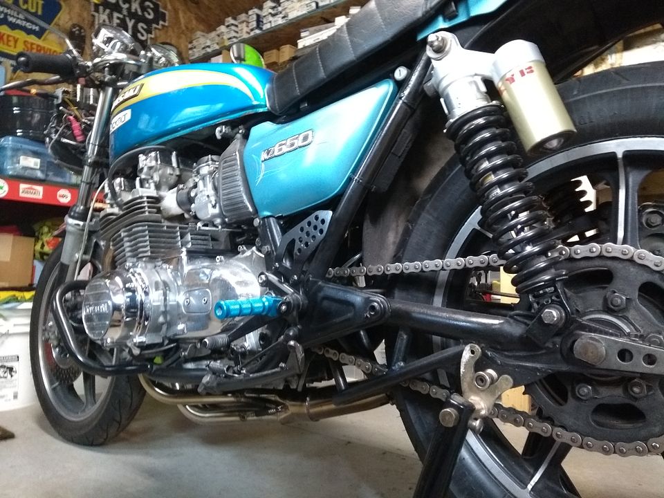

I've got ZRX1100 shocks on my '78 KZ650.
The ZRX and the KZ are both close to 500 lbs.
The shocks are longer than stock, so I raised the front end up to stock (had it lowered for years).
Ride is fine, I'd do it again.
The KZ doesn't have a chain guard:
