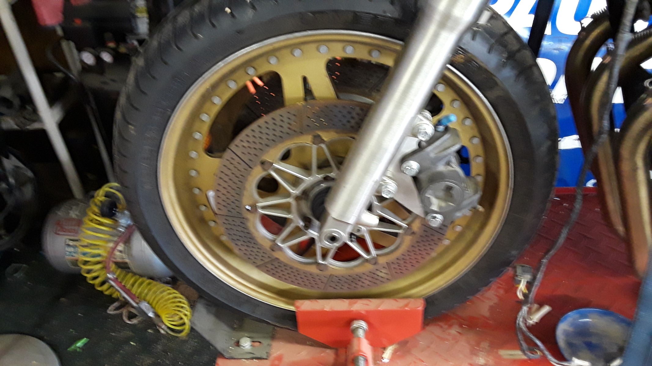

Take a tape measure out to the shop/garage & take note of the available real estate BETWEEN the forks. Is there room for the wheel?
Assuming there is, look at brake caliper diameters. Are they even close? If they're close, you're getting closer. What about axle diameter for wheel VS forks?

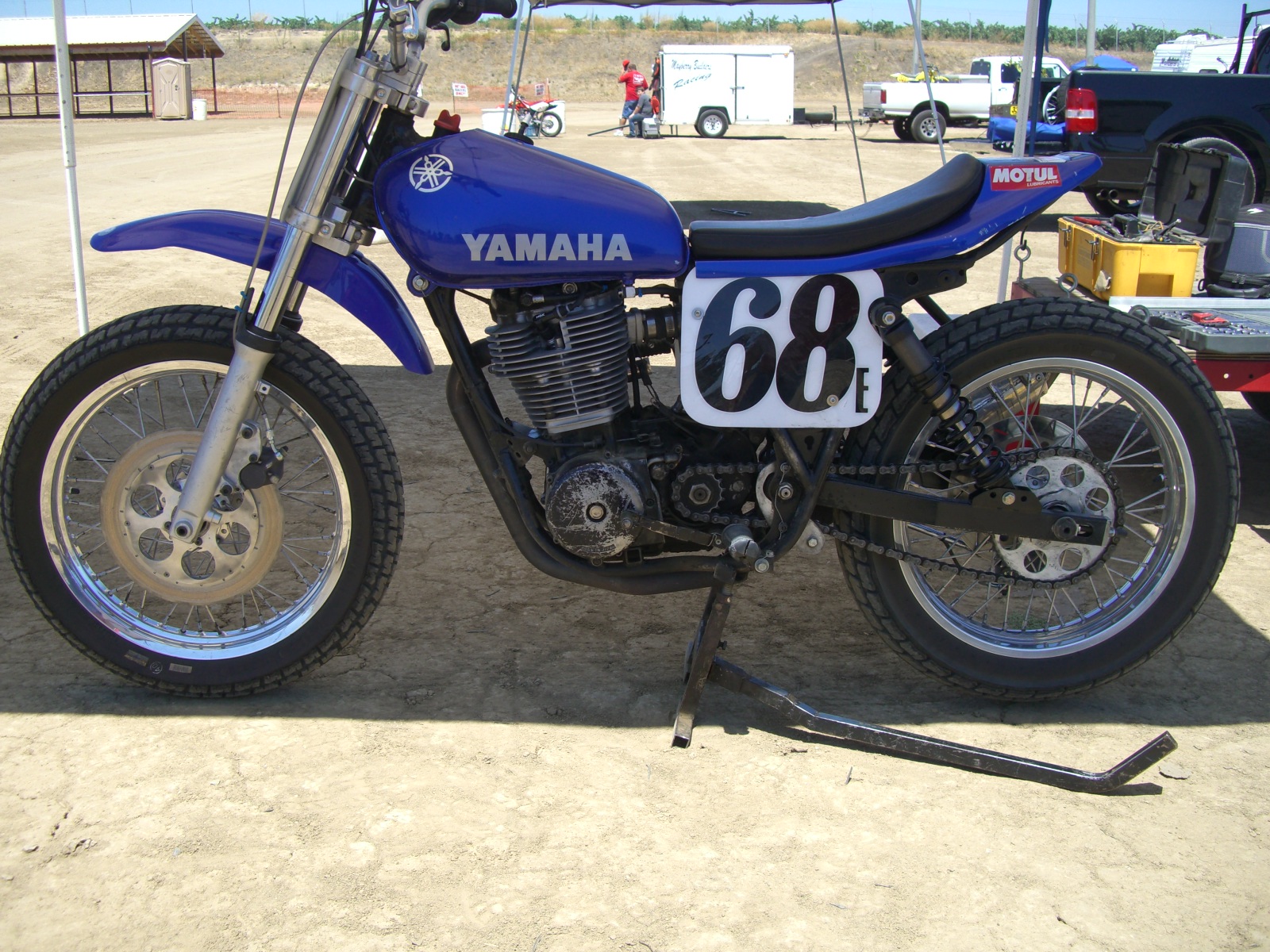

There are many things to examine, but these are the obvious. Most swaps I have done put newer forks to an older wheel. On my race bike I put R6 forks to a Yamaha TX 750 wheel. On my road bike, I put GSXr forks to my old Astralites.
Sorry for the poor pic quality above But in both cases, custom fabrication was required for caliper hangers and wheel spacers etc.
