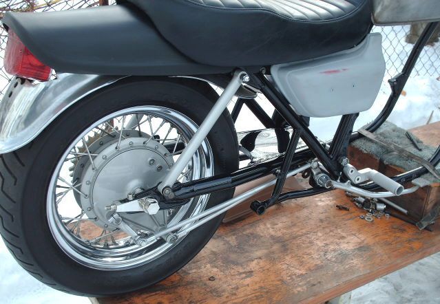

Stock swing arm, NO! 150 too wide. I lengthened a stock swing arm 4 ", wider at the rear to fit a 150 on a 4" wide hog wheel. Wait till I die! My kids will sell it for $5 bucks at my estate sale
It's only been together 20 yrs.!
