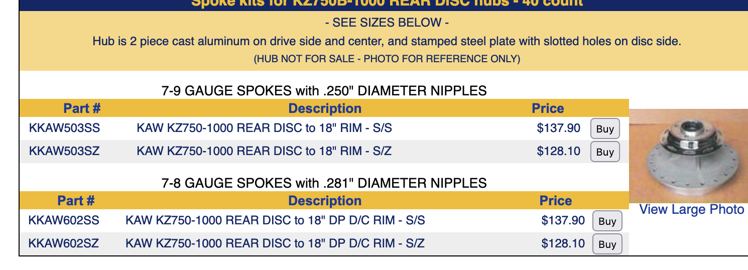

I love partzilla, but this is an example of its limitations. Partzilla lists these spokes as unique to the KZ750B, however if you visit Buchanan's, they list the spokes being the same between KZ1000 and KZ750. maybe a different factory finish to warrant different part numbers?

Thanks.  Just pointing out that Partzilla confirms that the spoke set he found should work.
I always start w the part numbers & cross-reference, then go from there.
