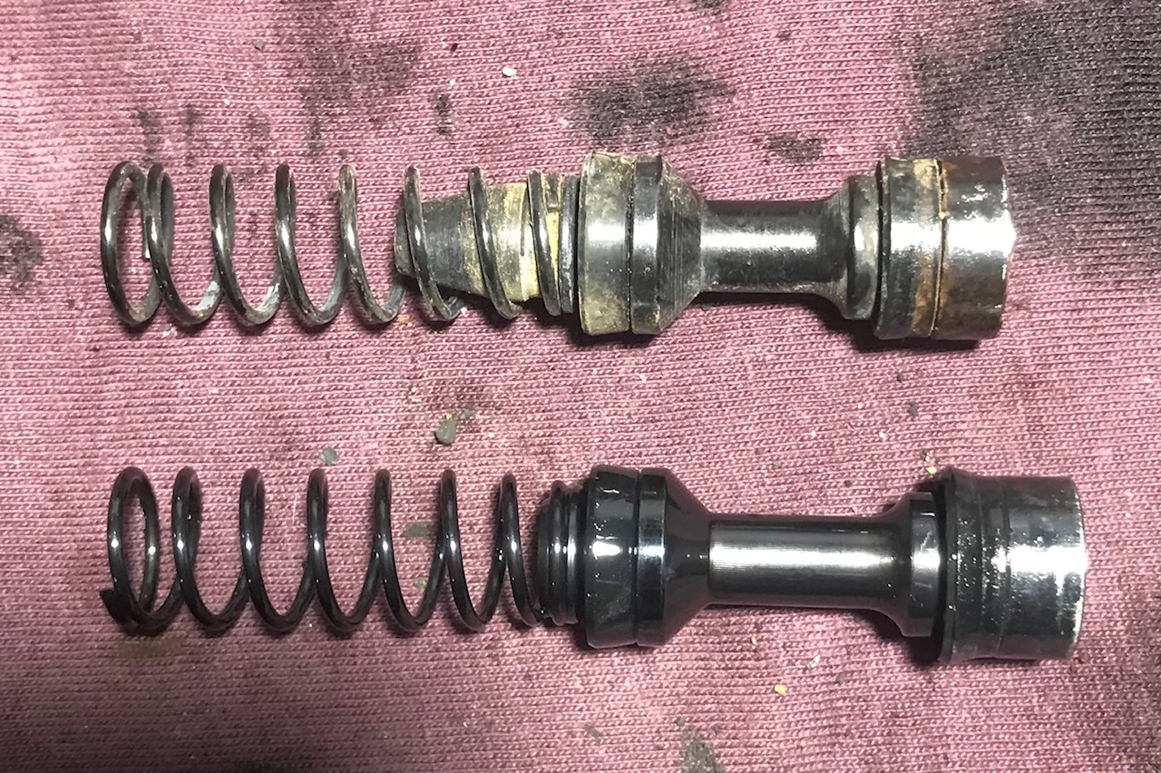

Well I think I've found the problem!
Check out the pic of the new MC piston I was (wrongly) supplied with against one from an old MC i had lying around. At least 5mm longer.
I guess it wasn't clearing the relief ports in the MC and was building up pressure, clamping the caliper on and not allowing it to release.
I'll know for definite once I have a new correct one installed but it does seem likely to be the problem.
Thanks guys for all the pointers, it really helped.

Was this the actual problem? I'm having the same issue on an 81 KZ1100 but I threw out the old plunger so cannot compare to the new one I got from Brakecrafters.

25 Dec 2021 16:20 - 25 Dec 2021 16:23
Yes it was. The brakecrafters one was too long for the mc by about 3mm, so it was blocking one of the return valves and locking pressure and dragging the brake after about 10 mins of riding.
i ended up managing to source an oem piston and seal from Vintage kawasaki in canada. Couldn’t find one anywhere else.
once fitted that sorted the problem straight away.
i would try and locate an oem one, if posible, then at least you can rule that out as a problem if its still the same.

30 Dec 2021 08:42
Thanks for the reply. I just got an oem replacement and I'm also switching hoses. Fingers crossed!!
