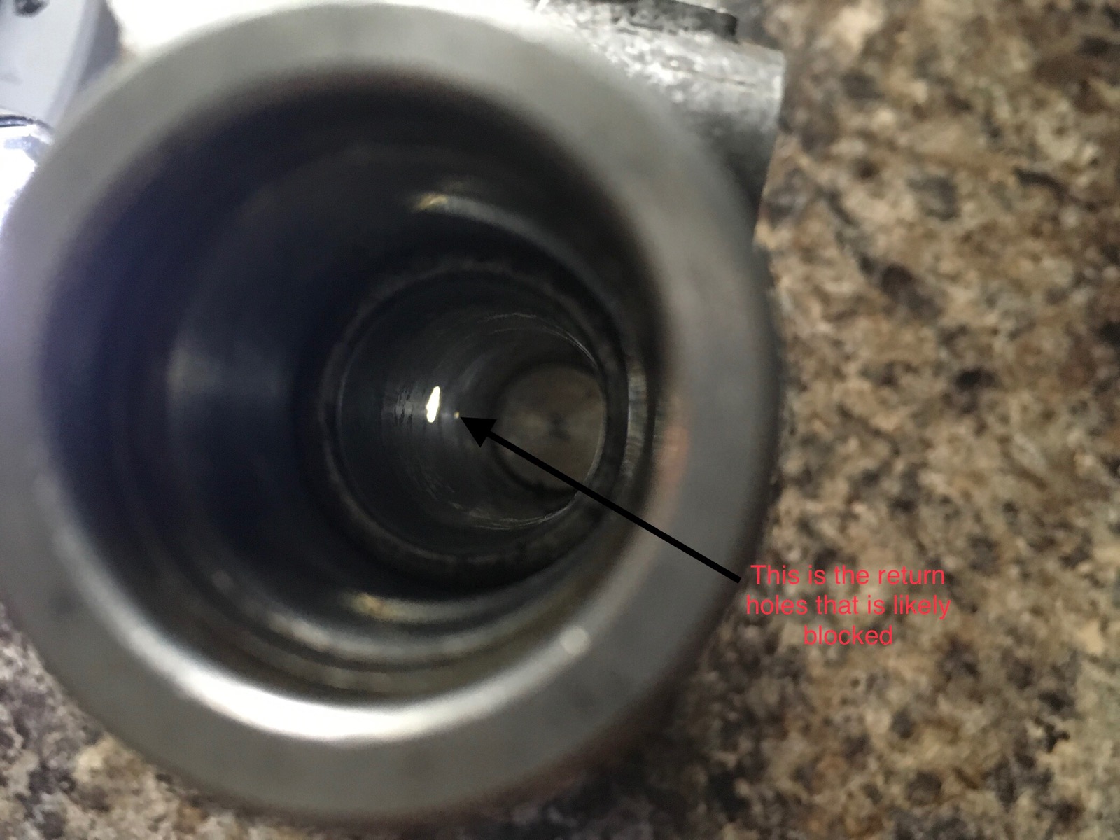

You may not have good fluid flow through the holes in your master cylinder. You will have to flush the system and ensure the holes are clean.

The equalizing port (the small of the two ports) of your Master Cylinder is plugged. When the port gets plugged, excess fluid (due to piston retraction and heat expansion) can't flow back into the MC, which causes the pad to drag, which causes even more heat, causing more dragging, causing even more heat ...... until the brakes eventually lock up. Use a guitar string to clean the port out and flush with new fluid.

06 Aug 2021 08:11
Thank you!
everything was 100 cleaned 3 years ago….
will umount master cylinder.

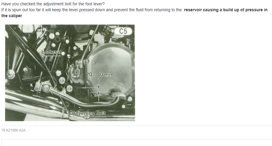

09 Aug 2021 00:41Thank you, will check these also, these can be the case, that the pedal is not fully "back", but how is the pressure building up since I`m not using the brake? vibration from driving?

I had trouble with my back brake building up pressure to where I had to pull over and bleed the caliper to release the pressure,
so I took it to the local (trusted) bike shop and the owner gave it to some kid to fix.
Fresh pads and a master cylinder rebuild later it was still hanging up, so after two or three trips back to the shop the owner decided to have a look, he started at the foot pedal and then looked at the adjustment bolt and found the problem.
That was 40 years ago and cost a bunch of time and money but was a lesson well learned.
78 KZ1000 A2A
Last edit: 09 Aug 2021 12:54 by bluej58.
Re: Rear brake calipper
09 Aug 2021 08:55
I’ve never watched my rear pedal, but I bet on a bumpy road it could get pulled up or down adding a slight amount of pressure each bump. Just a guess. I have to believe as mentioned it’s either the adjustments or the pressure relief port that is blocked.
