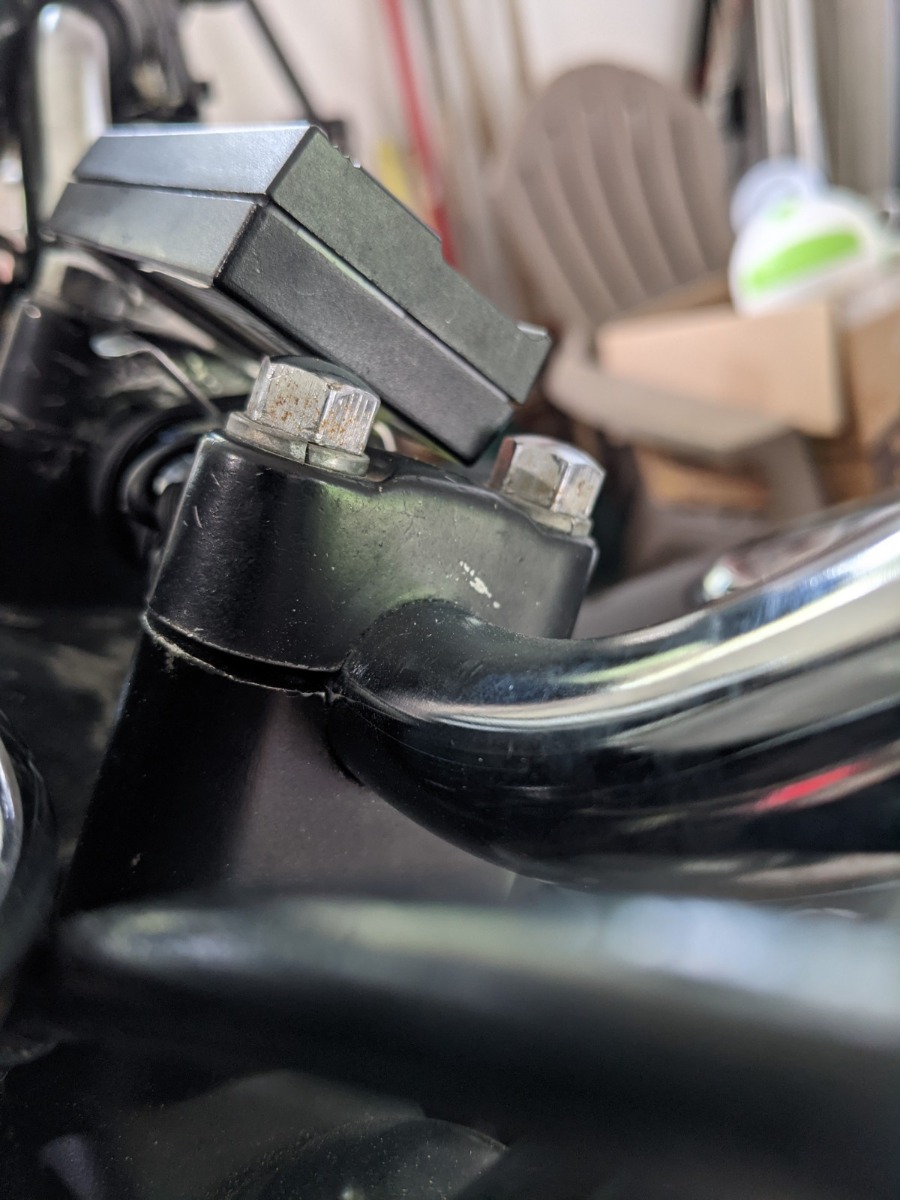

I recently replaced the bars on my 1982 KZ550 A3, and I just want to make sure I'm not riding a death trap. My previous handlebar was 7/8" diameter, and the new one I ordered is also 7/8".
I put the new bars in place and tightened down the handlebar clamps to the torque spec listed in my Clymer manual, 13 ft-lbs. However, the clamps don't sit flush against the mount underneath, there is a gap of about 2-3mm on each side. I'm not sure if it was like that for my old bars and I just didn't notice, or maybe the tolerances are a little off on my new bars, or perhaps I'm just not cranking the bolts tight enough...
It feels pretty sturdy, but the gaps make me a little nervous. Should I be worried?

A gap between the clamps is correct to allow them to grip the bars without bottoming out but the distance between the bar bends is slightly too narrow and the clamps aren't sitting square.
You really need a set of bars that have a longer straight section between the first bends so that the clamps sit level.

You are clamped onto a curved section of the bars...not good at all. Like Zed said, you need bars with a wider clamp area.

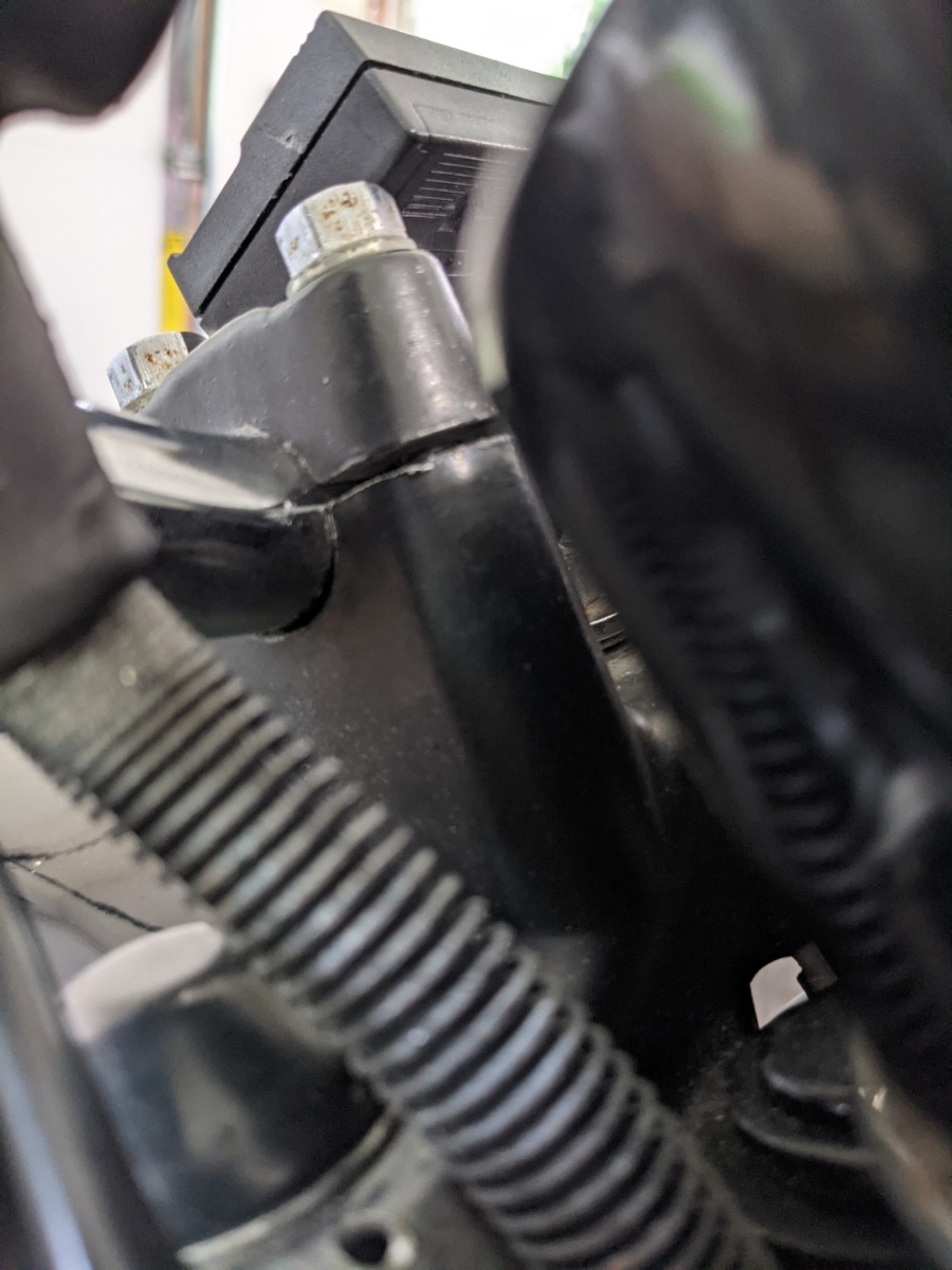

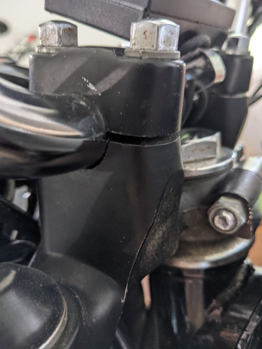

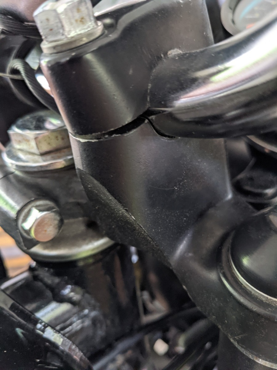

In the last picture, are those stress fractures I'm seeing in the paint on the clamp cap?

09 Aug 2021 17:43Not sure, how would I tell?Those are the wrong bars, get different ones. The clamp area is an easy measurement but as for the rest, you need a degree in three dimensional geometry.

Re: Are my handlebars secure?
09 Aug 2021 19:35You would have to clean the paint off and look for cracks. Or take the clamp off and see if there are cracks in the half circle area.
11 Aug 2021 10:29
It's hard to tell in the picture I referenced but things did look askew. Could be the camera angle. And the fractures I think I see would be at the top, not next to the bar. As Mika says, you'd have to clean the paint.
I only broke one such clamp in my life but it was for the front brake lever. It just broke without warning.
