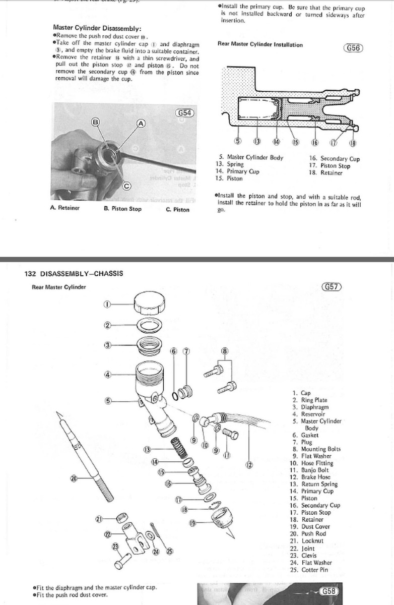

Grease gun! Compressed air contains a lot of energy...enough to hurt someone when the piston comes flying out. Grease is virtually incompressible so you don't need to worry about flying bombs.

They should pop out on their own once the C-clip is removed. There may be some crud on the barrel which is preventing the piston from coming out - clean it up as best as you can. You could try 'cooking' in boiling water for a few minutes to loosen things up.
