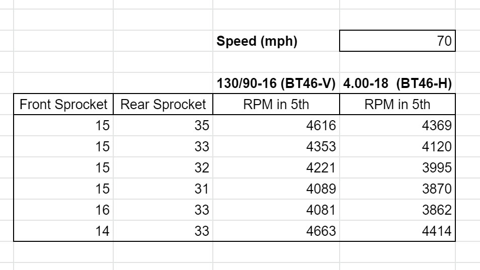

No eBay APP ID and/or Cert ID defined in Kunena configurationI'm going to order the 33. If too tall I can go with a 14 tooth countershaft sprocket or use the 16 I have.

Steve, my rear rim is a 16 x 3.00. I’m running a 130/90-16

I will be too. What countershaft sprocket are you running?

15T counter. 32T driven.

What's the RPM at 70 MPH?
Re: Wheels and sprockets
05 Jul 2021 20:31
I’ll test tomorrow. If I recall correctly I’m about 3200 at 55

With the 15/35 I'm at just below 5000 RPM. With the 16/35 I'm just above 4500. Interesting to see how they compare. The pic of a MKII with a 16 there's more room between the fender and tire. I'd like to go back to my progressive shocks while I have the RFY shocks rebuilt.

For my Z1's I'm running 16/35 and I do about 105 kph (Say about 65 mph) at 4,000 rpm, measured with a gps.

06 Jul 2021 21:42My 1978 1000 LTD has a 16” rear mag and stock is a 33T rear.
The FSM for the 78 LTD shows 15/33, which is the same as the '78 kZ1000A and Z1R. The earlier Z1/900 and later '80 MKII used 15/35. It seems like they were playing with ratios over the years, but Kawasaki didn't necessarily use different ratios for 18" vs. 16" rear wheels.
The tires are slightly different in diameter. The 16" used an MT90-16, which seems to translate to a 130/90-16. The 18" used a 4.0-18. Comparing tires, the Bridgestone BT46 currently comes in both a 4.00-18 and 130/90-16. The 130/90-16 is about 1.5" small in diameter (25.079 vs 26.496). So the RPM at 70 would be a bit higher with the 130/90-16
Noodling around with a spreadsheet, this is what I came up with for RPM @ 70 MPH in 5th gear with those two Bridgestone tires, for different sprockets. It seems to sort of compare with the engine speed numbers people have mentioned, so the math might be right.

Sprockets are 16/33.
