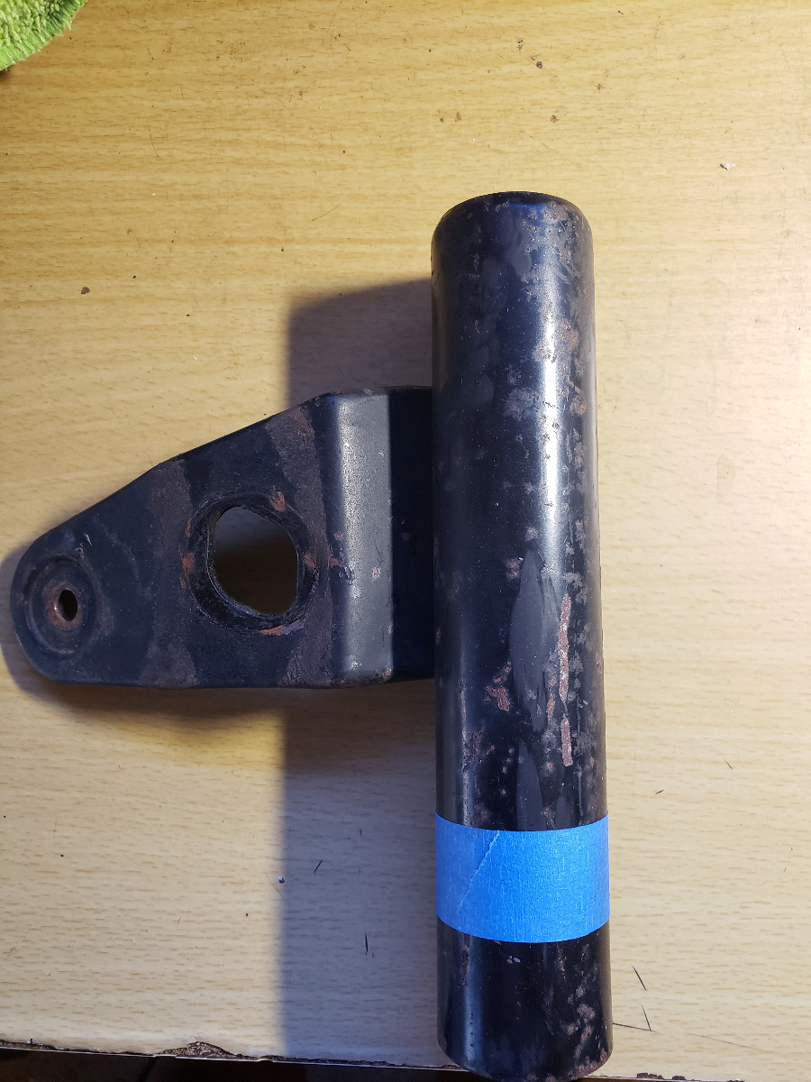

Aloha guys. I'm not sure if this topic belongs here or the electrical since it does involve headlight. anyway, here it goes.
I need some idea of what can be done. Involving welding is OK too. If it's too difficult for me to do, I can always send it out to my friend. But I prefer simpler one.
My headlight brackets are too far gone. This left one is in better shape, but my right is far worse. I been searching evilbay for the pair, or even one side of it for about 3 years now. For now, I'm going to hammer it to make it straight enough to fit my headlight. But if I can, I want a straight bracket but at the moment, can't find any.
Anybody have any good idea what to do?

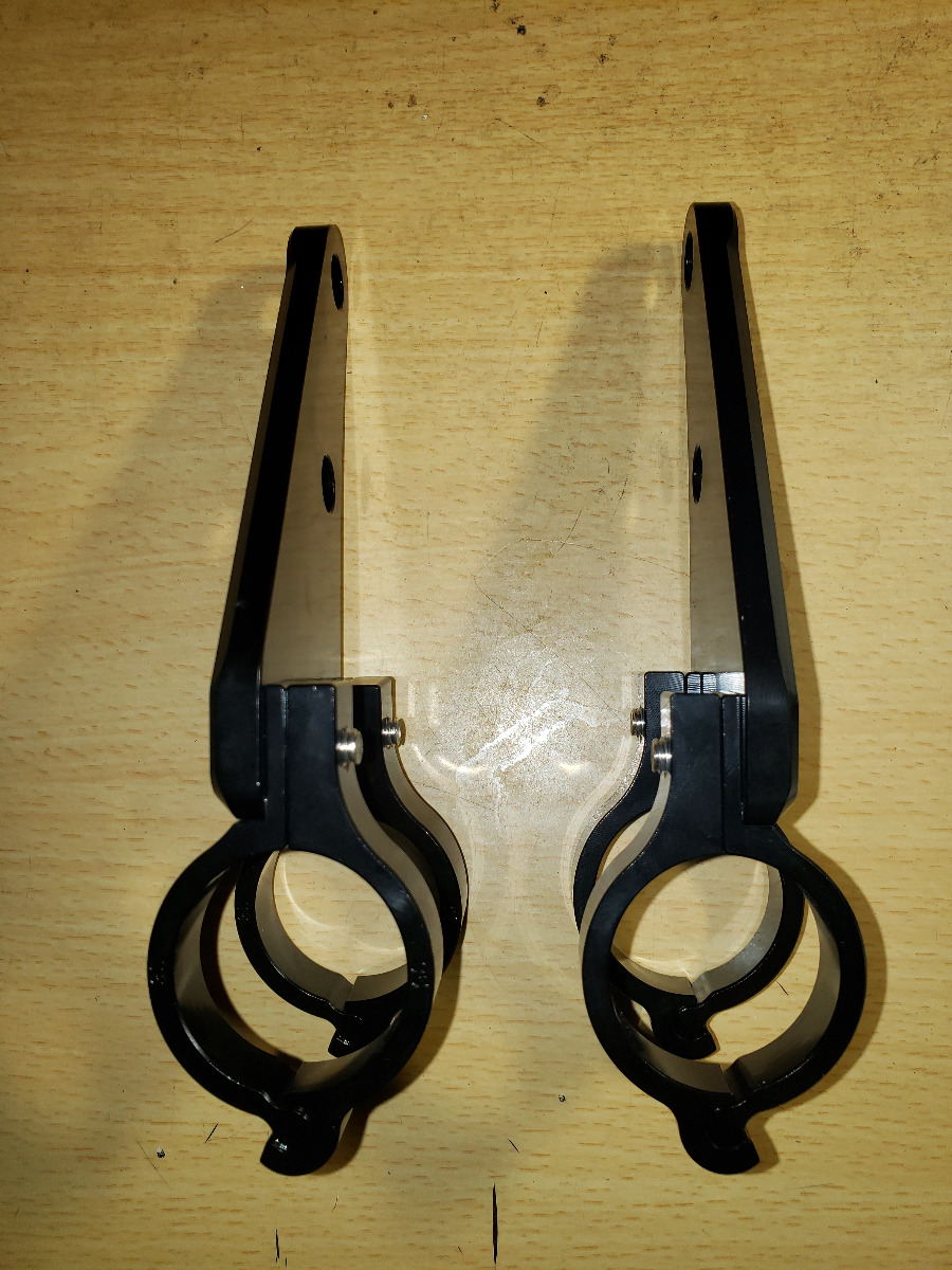

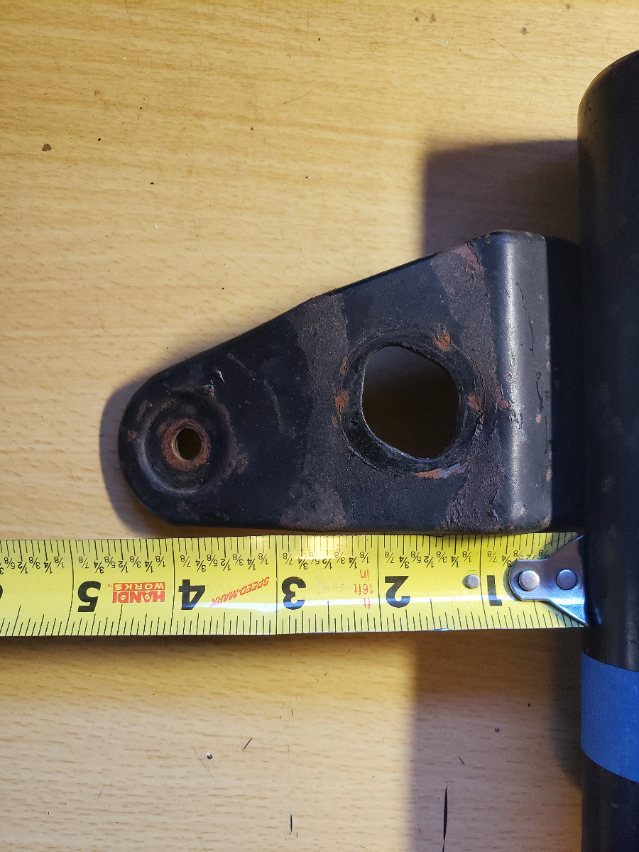

I bought this pair when I was going to do round headlight conversion, but due to many reason, I gave up on that idea and will go stock rectangular headlight.
As you can see, the stock brackets extend out to accommodate the rectangular headlight, but the aftermarket bracket is straight from the fork. I even tried on the fork to see if I can make some kind of extension, or something but the headlight is way too wide.
Found one in decent shape but it's for KZ550 and it's from Germany. About 75 USD shipped, but not too sure of the inner diameter. If I can't find any, I was gonna cut the extended part and weld it on to my bracket, but still searching for the right one.

03 Jul 2021 07:14 - 03 Jul 2021 07:23I think you could make those machined parts work. The flat mounting ear is a separate piece from the mounting ring. With some standoff cylinders and longer bolts, you could space the ears away from the mounting rings and end up with whatever width you'd like. It may not look super pretty, but it should work until you find something better.

03 Jul 2021 17:31I think you could make those machined parts work. The flat mounting ear is a separate piece from the mounting ring. With some standoff cylinders and longer bolts, you could space the ears away from the mounting rings and end up with whatever width you'd like. It may not look super pretty, but it should work until you find something better.
www.mcmaster.com/standoffs/aluminum-unthreaded-spacers/
Thanks for the input. Yes, I thought about that as well, but it needs about inch or so, if not longer, on both side. I was more worried about vibration and fork movements than looking ugly. Since it's gonna be mounted on the fork, I don't want the headlight or the mount to get loose.
Thinking of making just the bracket part of it from sheetmetal (or something little more thick) and weld it on. But I'm still searching. Not in any rush at the moment. I still need to work on tires and wheels first (to get it mounted and put it back on the bike so I can work on my seat rail section).

Headlight ears, are about the easiest things to make Yourself. I cut a 6 mm steel piece from a plate - shaped it into the inside of the ear, and rounded the edges a little. Then, I clamped sheet metal of correct thickness onto it - and started knocking the edge over the "template. Trimmed away what was exessive material, and welded to two new tubes I also had made.
No, I don't own a fancy workshop. An angle grinder, a hammer, some clamps, an old MIG welder and a small anvil were my tools.
The ears, now look exactly like the original ones, and no one could tell I made them myself.
