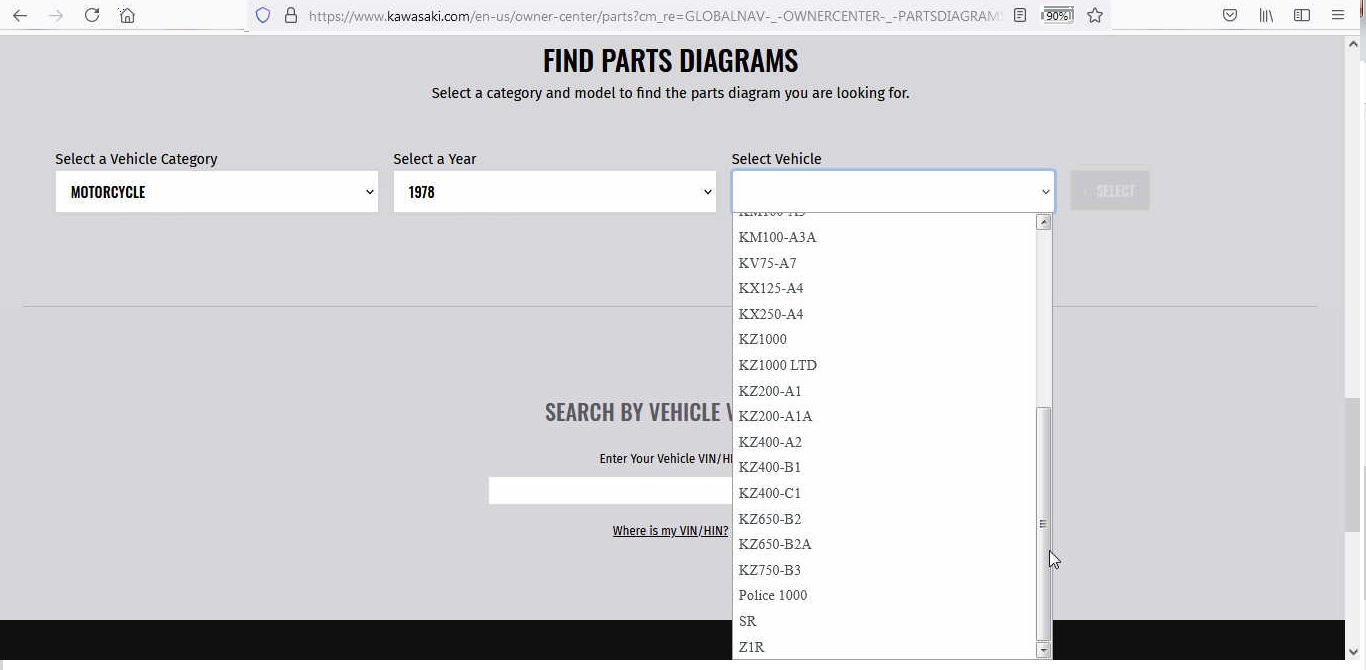

01 Jul 2021 17:29 - 01 Jul 2021 17:55I admit I certainly make the occasional dumb ass comment. However, it would seem logical for the original poster to state which 1978 Kawasaki he plans to install a front wheel on. In 1978 Kawasaki made a bunch of different KZ models ranging from 200cc models on up through 1000cc models. They do not all use the same front wheel, so specifying which model would be helpful. I looked between the lines, but did not see what model was being discussed - did I miss something? One very simple way to avoid such issues is to simply add the year and model to the signature line. That way one does not need to remember to show that information in every posting. EdIgnore ED mate, he seems to have a problem reading between the lines and adds the occasional dumb ass comment. ....

Then why not say that ED, it would have been a far more appropriate comment. I'll also point out that you aren't one of the modified guys here, {apart from your horn}, you prefer stock bikes and have made that abundantly clear. One simple way of "avoiding such issues" would be to try., like most people here, and be helpful.
Most guys here doing wheel swaps own the larger capacity Kawasaki's,{750 and up}, I did assume the OP has a larger bike because the ZX wheels are a fairly common swap / upgrade on these bikes.
