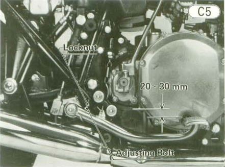

Have you checked the adjustment bolt for the foot lever?
If it is spun out too far it will keep the lever pressed down and prevent the fluid from returning to the reservoir causing a build up of pressure in the caliper

Also, be sure that the lever moves freely. The pivot can collect dirt and rust which can cause the lever to not return properly.
