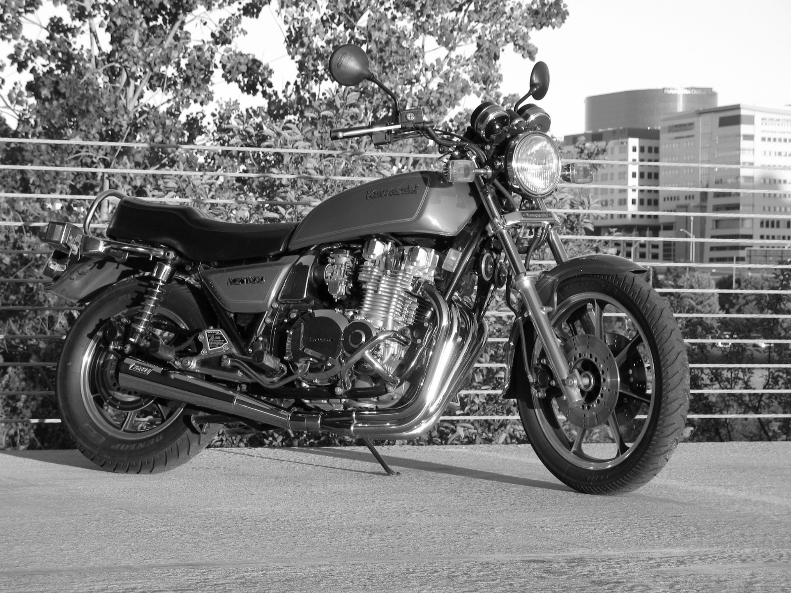

That same factory air-ride suspension was on my bike. I replaced it entirely with Progressive shocks and fork springs in 2014.
IMO the ride is better, and the bike handles more like a sport bike should. I opted to install 12.5" 12-1209B shocks (vs.13.5" 12-1207B) which dropped the seat and gave the bike a slight squatty appearance. The changeover bolstered my overall riding confidence, mostly by improving my sense of contact with the road when leaning through curves.
