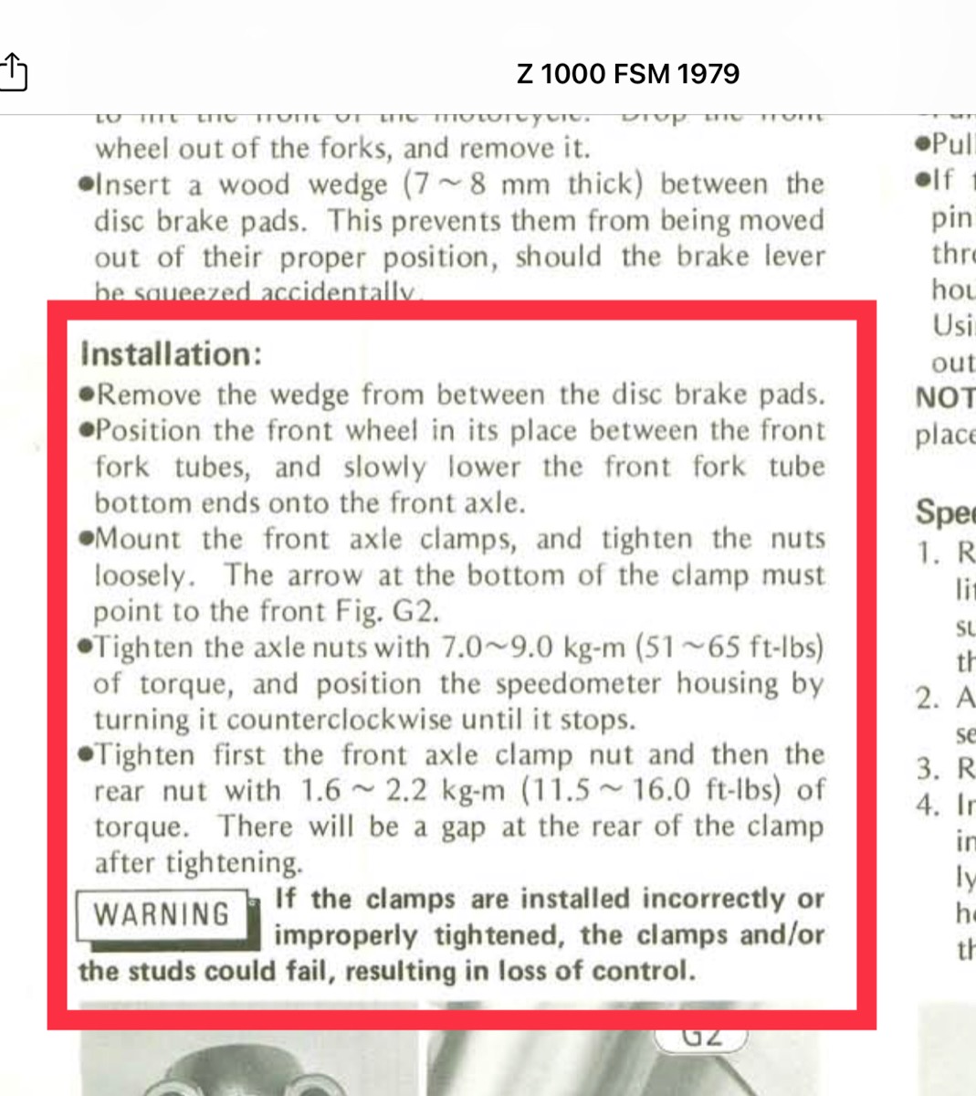

When mounting the wheel, is there a trick or technique to torquing the axle properly? Also, in what order should it all be done. the book says to tighten the axle clamp front first then rear leaving the small gap at the rear, makes sense. But do I tighten the axle first and then the clamps or vice versa?

Model and year?
the following is for the 1977 to 79 Kz1000 please check your model for torque and proper sequencing

78 650
So loosely do up the clamp bolts, then the axle, then the speedo drive(which is already in its spot, then the front clamp nut then the rear.
I did read through this but the version of the manual i have confused my little brain.

Re: Front Wheel Fit Up
08 Jun 2021 19:02
Your bike will be same sequence. Check torque value. Make sure you use a Factory Service Manual.
