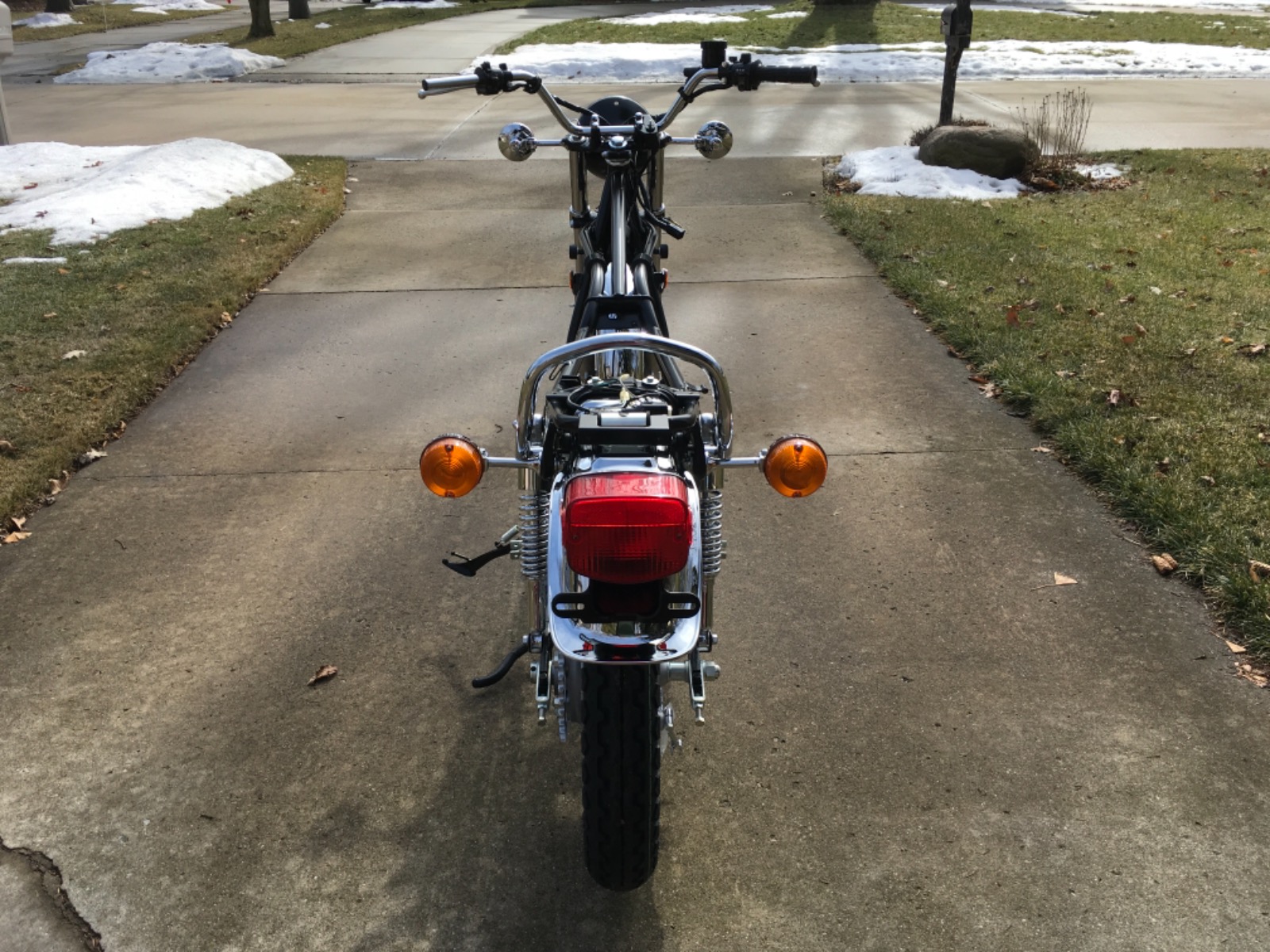

Hi Guys....this is my 76 KZ900 project. Has anyone had issues with the rear wheel being off center from the frame? The drive and driven sprockets are perfectly aligned but somehow, the wheel looks off center from the back fender and tail light. Spacing is perfect to each side of the rear fork frame but if I measure from outside of the tire to the inside of the shocks, I am out by about half an inch. Any suggestions would be appreciated...

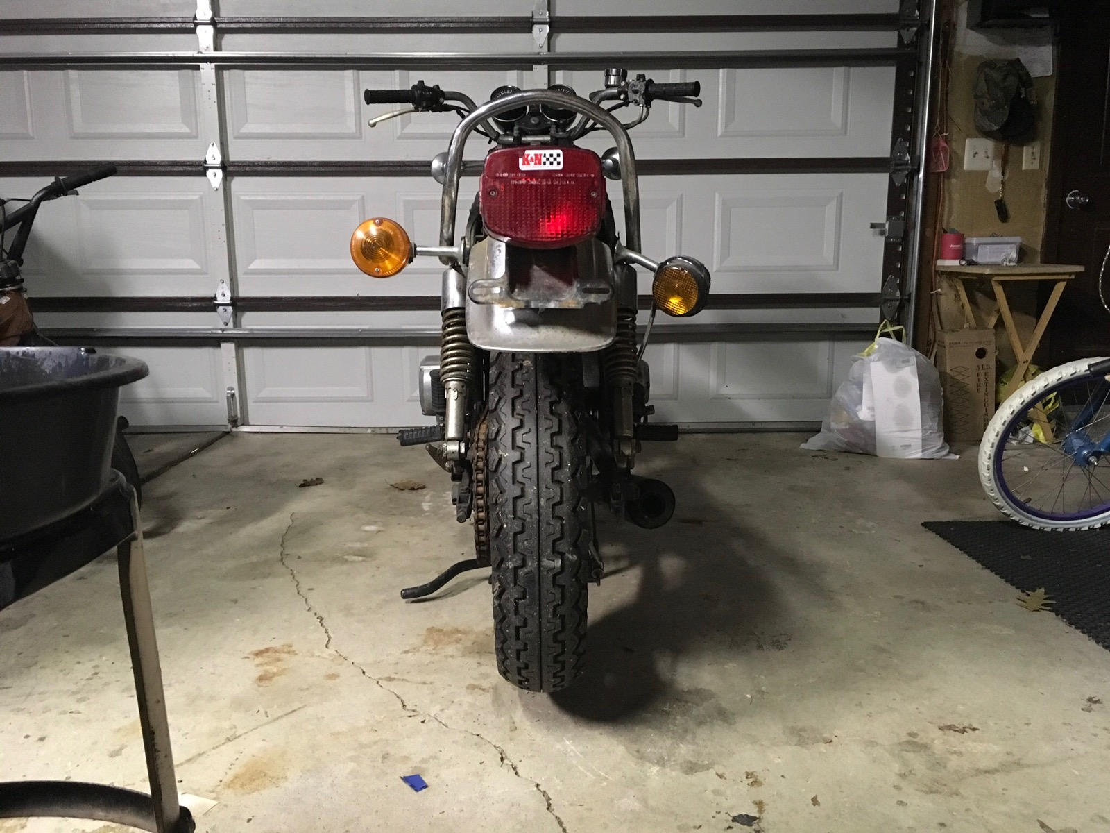

I had similar concerns. Seeing your now makes me less concerned something is wrong.
Before tear down
After rebuild
