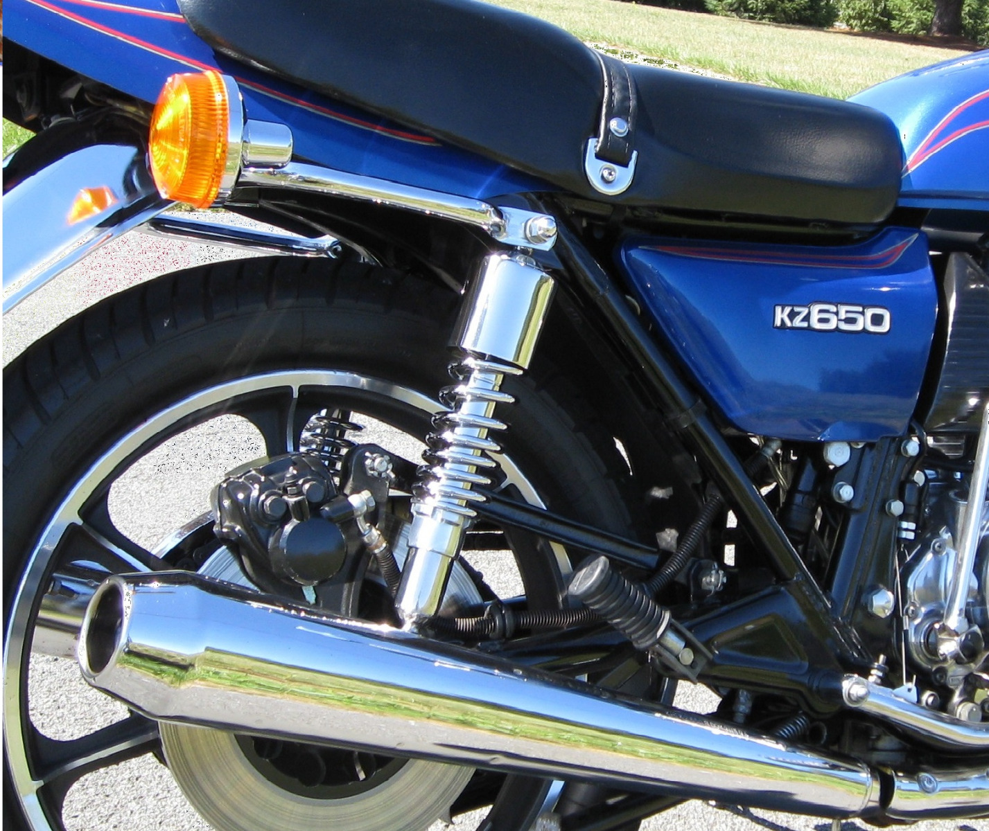

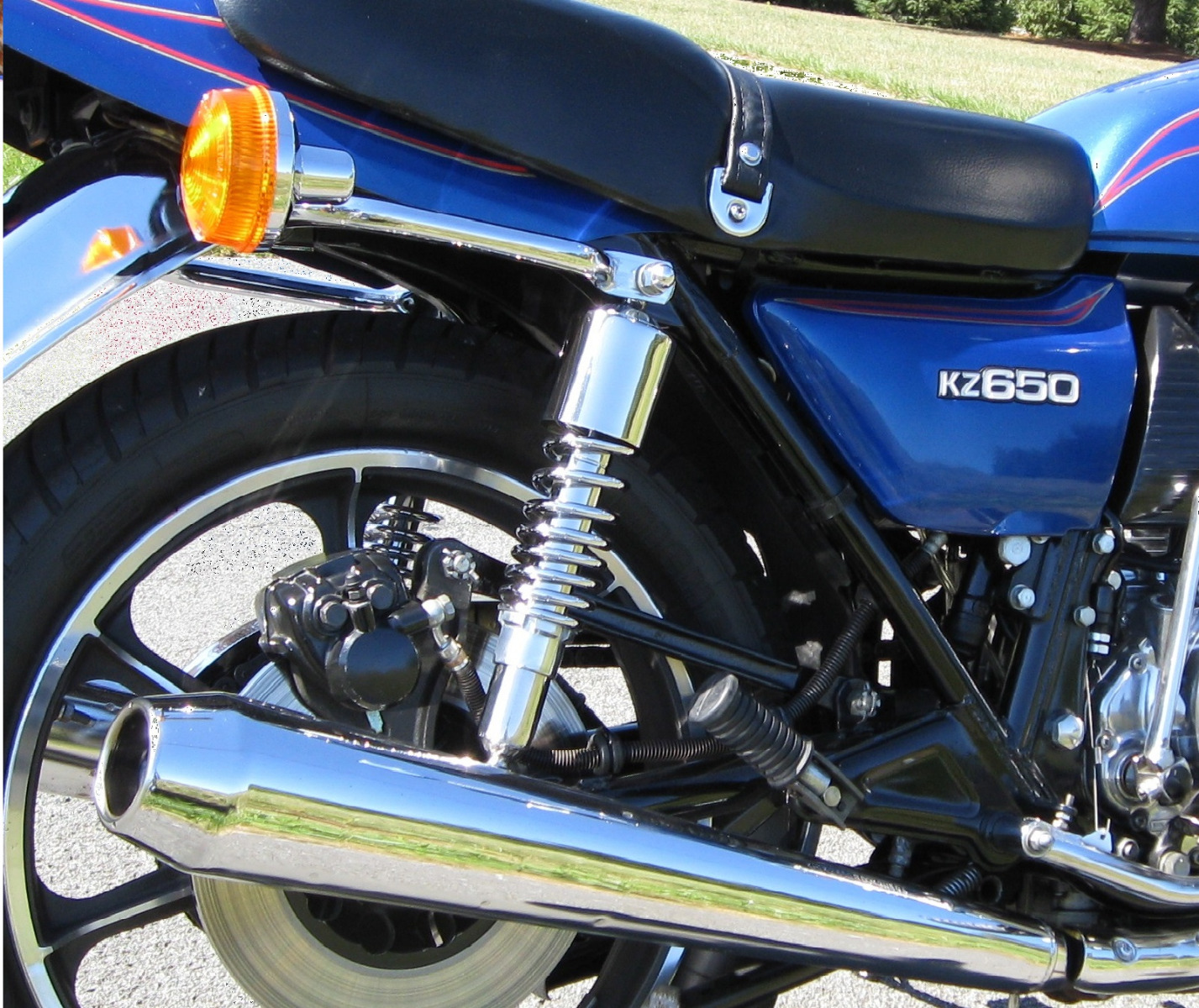

I have Hagon shocks on my KZ650. I've had them for the past 14 years (17,000 miles) and they still work and look great. They look very similar to the original KZ650 shocks, but they work 1,000 times better. Ed
