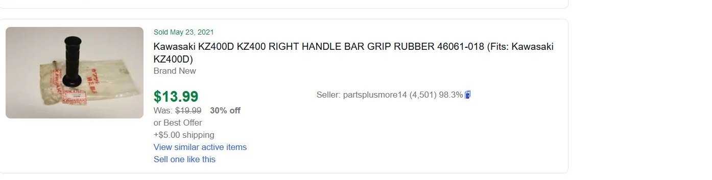

Here's a RH grip that doesn't include the throttle tube. $36 + sh.
Kawasaki RH grip

Thanks to all for the suggestions and helpful info. Especially the info gleaned from martin_csr's post with the link to the feebay listing that included the part number(46061-018) for the elusive part. Partzilla doesn't show the grip and throttle tube as separate part numbers but, it's a common part number to several '74-'80 KZ400/440 models and show it as a separate item or as a throttle tube/grip assembly. A quick search showed the part available for about $20 shipped on the auction site. It should arrive by Friday.
