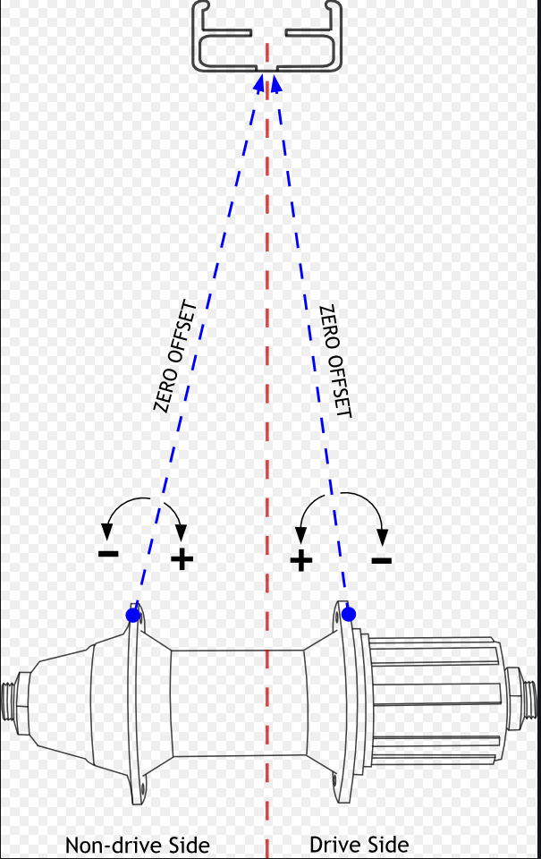

22 May 2021 06:03The front wheel is symmetrical side to side but the rear isn't. The image below is showing a bicycle wheel but apparently your bike has offset flanges which are similar since the spoke lengths are different.Thanks a bunch. That's great to know. I have to admit that actually getting the wheels done, especially the Fr, is kind of a pipe dream at the moment. Just started collecting info this week & I've been wondering about the bend angles. I don't even know what gauge the stock spokes are or how Kawasaki measures them >> the Fr are listed as 175MMX, while the Rr are 77MMX1 & 75MMX6. I assume the MM is mm, but I don't know what the X-stuff means or why the Fr are both 175 but the inner/outer Rr are different From the way Kawasaki does the diagrams it's entirely possible that the part descriptions are incomplete & some of the info was lopped off. Plus I've been wondering if it's possible some other Japanese model might use the same spokes. but it could be that these spokes are unique to the 650/1000 CSRs. The oem pickings are slim on EB, otherwise I'd go w the stock parts. which I may very well end up doing anyway after going thru all of this rigamarole. doh.
