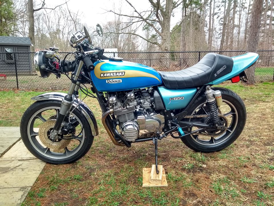

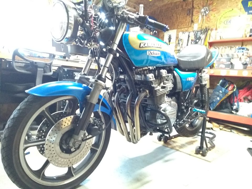

I find the mounting holes are usually in a different spot, and sometimes need to drilled.
I've got a stock 19" front fender on in this picture, with an 18" front wheel:
And here with a GPz750 front fender, 18" wheel.
Fender is wider and needs to be squeezed to fit, also new mounting holes drilled to lower it:
