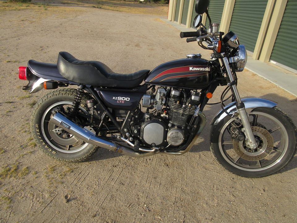

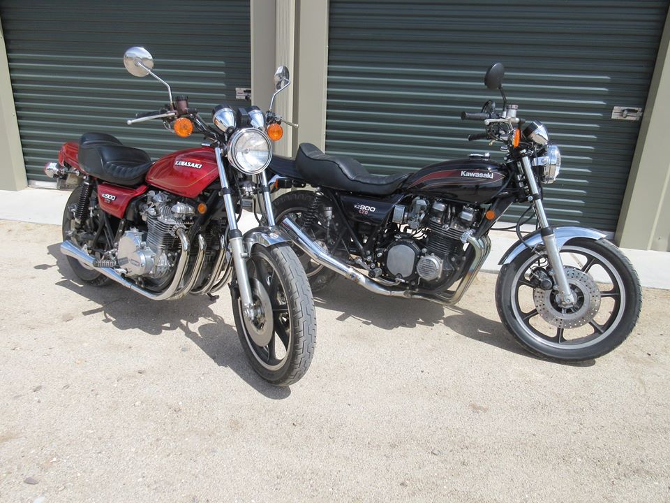

This one isn't stock. I have 2 other '76 B1's...1 all stock and another modified that I built from a bare frame and years of collected parts for a specific vision I had in mind. I have Z1R rotors on the front wheel. They are a direct swap from the Enkei's to the Morris wheels. The Z1R's matching rear rotor will not fit the Morris rear wheel, so a caliper change is necessary. I can change calipers w/o changing MC's. That's why I'm trying to avoid a MC swap. I also have a '77 1000A-model frame on hand for another build, so I have options. My 1st '76 B1 I bought new from the dealer when I was about to graduate HS back in the '70's. It got stolen in '83 or '84. I vowed that day to build another one from the ground up. The blue one pictured is that yet ongoing project. The body is an unfinished repaint of a '77 LTD that I got from a friend that was in a bind. Motor is from a '79 MKII. (I opted for that motor because it's more suitable for a big bore build that I have in mind). The new bike I recently acquired is not yet pictured. Anyway a while back I saw someone that fabricated a bracket to convert the different MC's w/o having to cut or weld. I have the other brake pedal/pushrod etc. I just can't remember where I saw the article, to see if he had a pattern for the bracket. I may never completely finish this project to my overall vision, but it is a fun good running rider and an awesome journey. Thanks anyway. I'll make it work.................Safe ridin'!
