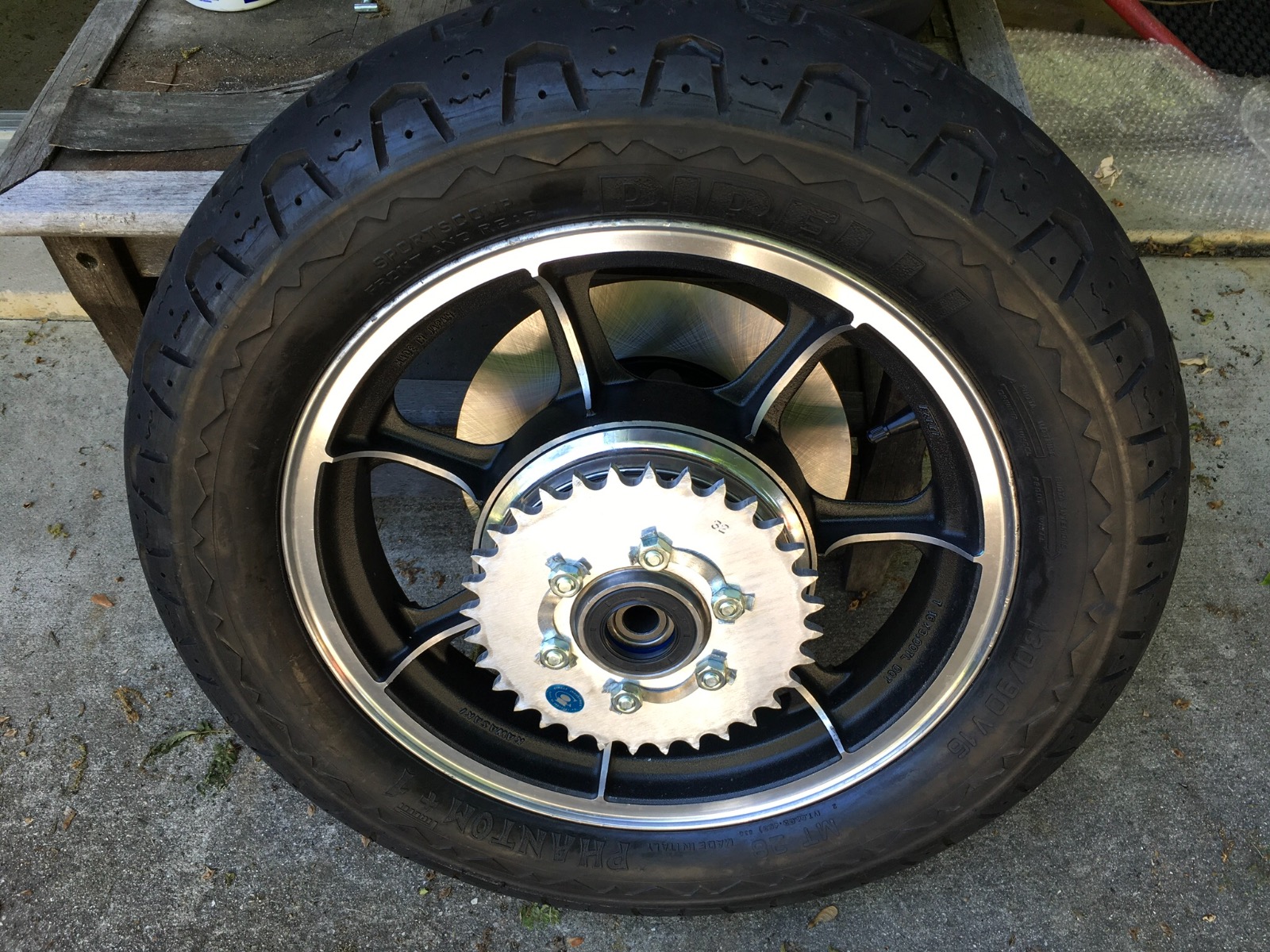

15 Apr 2021 08:59
Marty,
Im almost 100% sure the rim I posted is not a Morris. First indication is the Morris has an additional ridge around the outer most diameter. Second the Morris has the valve stem centered between the spokes. Third and most distinctive the Morris has an “M” in a circle cast into the rim at the valve stem location.
Re: 1979 KZ1000 LTD Front Axle Clamp Studs
15 Apr 2021 09:03 - 15 Apr 2021 09:05
My 1978 Kz1000 LTD has the additional ridge like the Morris. So I’m not sure what rim is (was) offered
Last edit: 15 Apr 2021 09:05 by Mikaw.
