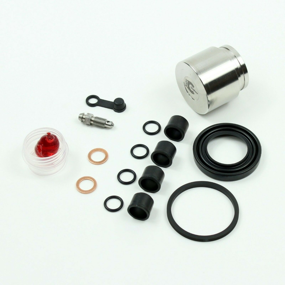

I just bought a 76 style rebuild kit from brake crafters. Highest quality parts I have seen so far to date. The piston is 306 stainless steel. And the rubber seals are thicker than oem. Not sure if they sell a Z1 kit? as the pistons are different size from the 43mm x 40mm KZ900. But they go good with a fresh glass beaded caliper housing.

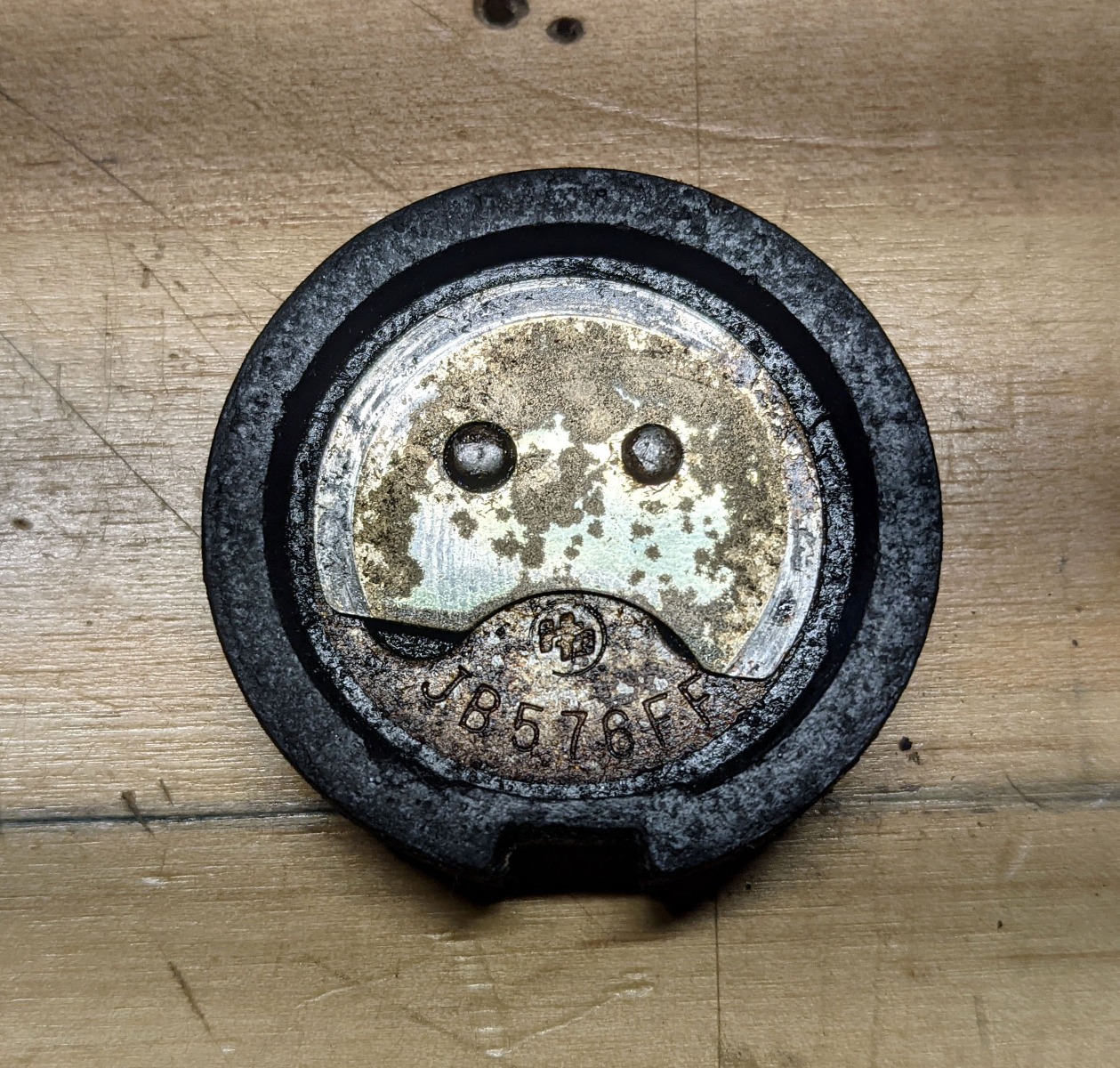

On a related note... Again this is for a 1974 Z1. I pulled the original caliper apart. I found that the pad, the one that is supposed to float and slide in the mounting bracket, was really really really stuck. I had to put the bracket in a vise force it out using a socket and some other bits I found on my bench. This caliper was definitely not working.
I didn't take a picture, but for reference it's like this.
I assumed this was caused by rust, but I was surprised to find that there is no metal to metal contact there. The pad material wraps completely around the sides of the backing plate, and only the pad material is touching the bracket.
Why did it get so stuck in there? Did the pad material swell? Most importantly, how do I avoid this in the future? I doesn't seem like you can grease the pad itself without risk of the grease getting on the face of the pad.
I've never seen anything like this with the later '77-'80 style calipers, and I've rebuilt a pile of those.

Metal/sintered metal pads will do that esp if stored in damp or high humidity conditions.

02 Apr 2021 07:29I'm not sure that's it. The pad looks to be an original Kawasaki part. Oddly, the other pad mounted to the caliper is an SBS brand pad. But if the stuck not-floating pad is a factory part, it should be an organic pad and not sintered. Kawasaki didn't switch to sintered until 1979 as far as I know.Mc wrote: Metal/sintered metal pads will do that esp if stored in damp or high humidity conditions.
The caliper piston seal was leaking. There was crusty dried brake fluid eating the paint on the bottom of the caliper. Maybe the brake fluid swelled the pad material and gummed it up?
Here is the stuck pad.
