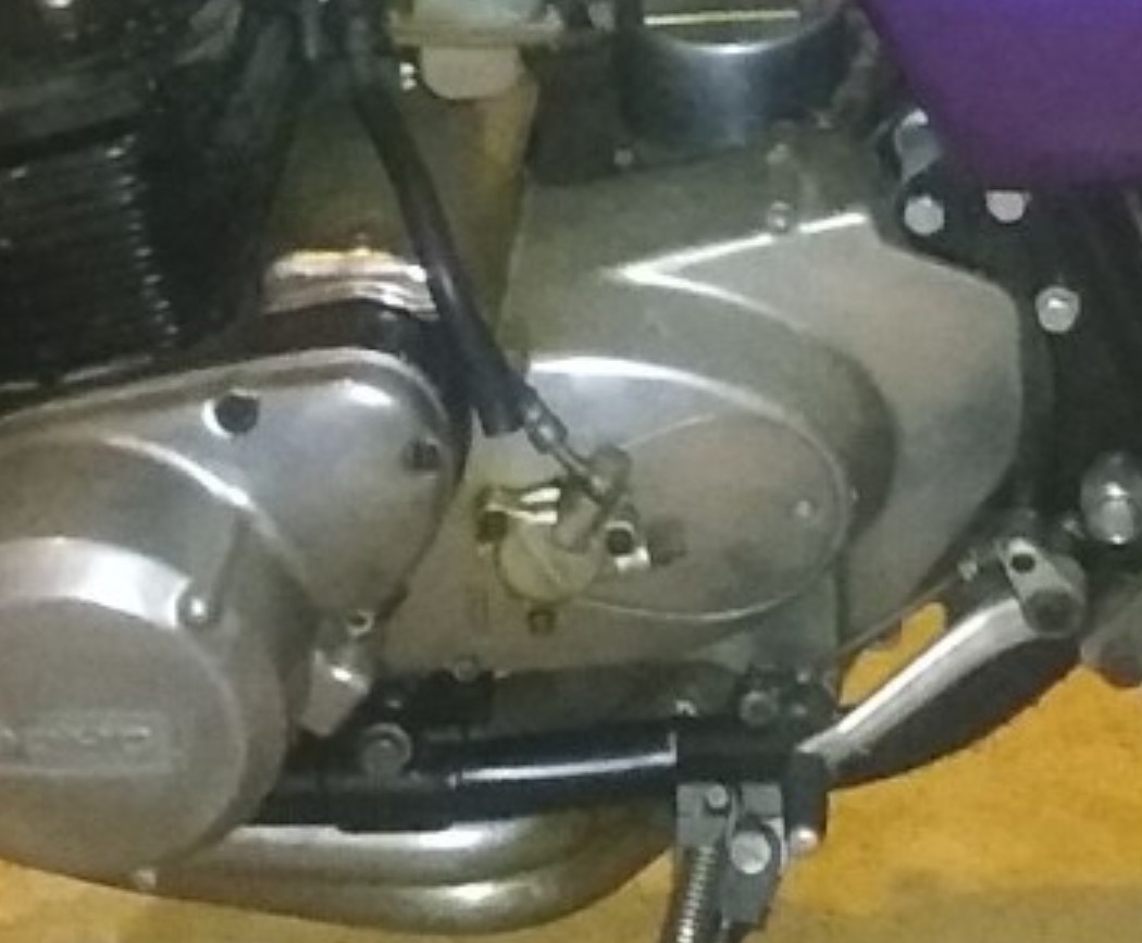

Just noticed a fairly suspect looking hydraulic clutch mounted to the outside of the sprocket cover, make sure you have a working clutch.

Check the profile of the tyre's KZ, the large profile gives them away, they are 16 inch wheels, very similar looking to early GSXR but they are definitely GPZ1000rx wheels {gixxer are 18's} , the OP has also used the 1000rx forks as well as the 1000rx front and rear brakes. The hydraulic clutch is a common mod , looks like he maybe using a GSXR hydraulic unit, its a relatively easy conversion, I have one of those GSXR units laying around in my shop somewhere, I was going to use it on a 750 honda but sold the bike......

yea ,I was wondering about the cable going to the sprocket cover, what the hell that was...so its a hydraulic clutch conversion... Regarding the 16 inch wheels, what is the consensus here...16 inch wheels better or worse than the 18 inch wheels? Pros/cons of 16 inch wheels vs 18 inch wheels? I like the look to this bike...I'm just on the fence...not sure if I should jump on it or not...
