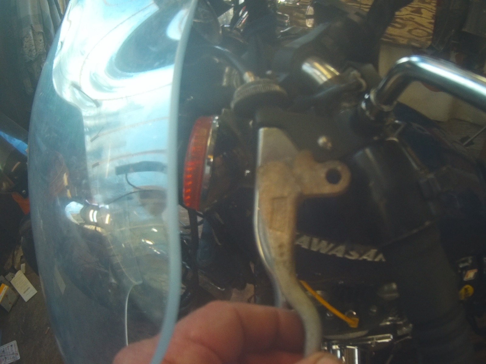

No eBay APP ID and/or Cert ID defined in Kunena configurationWon't fit. Look closely at your perch. I bought this for mine. Not perfect but a close fit.
The perch I got from Z1E. It was supposed to be correct.
I bought the new one but will have to get a teflon shim so it won't rattle.

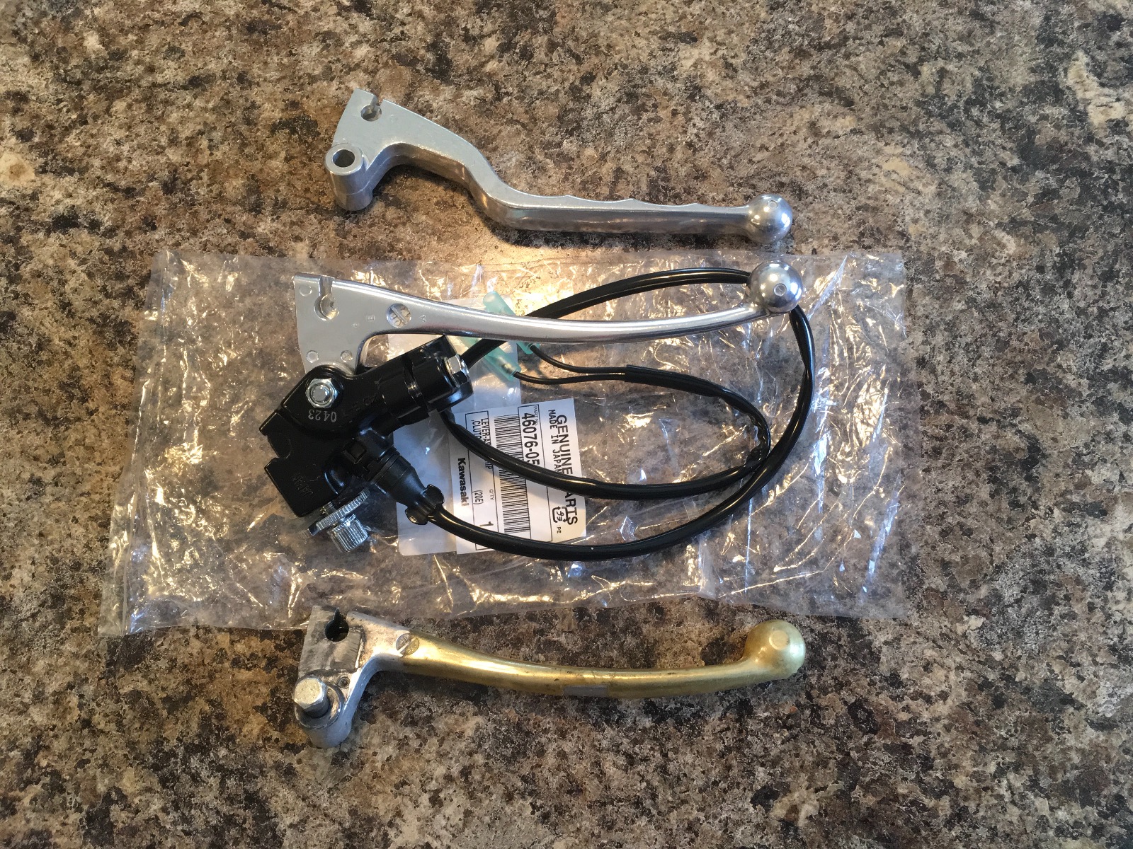

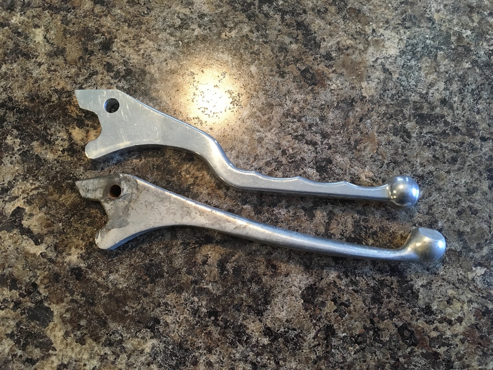

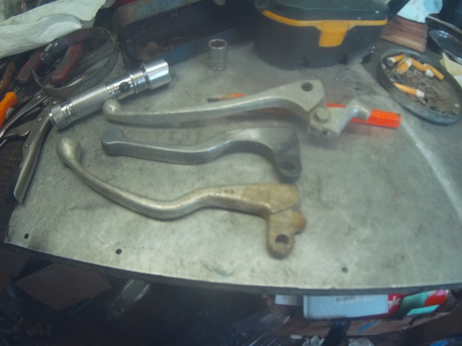

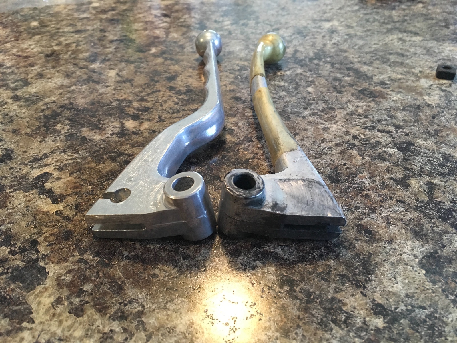

Steve with all due respect I say they fit. They might need a bronze bushing or a Teflon washer to make them as OEM. They will fit and work. See photos... Used OEM on the bottom, NOS middle and dog leg aftermarket on top.
Here are some side by side comparisons.

Looks too fat to fit my Z1E perch.

14 Mar 2021 13:21SWest wrote: Looks too fat to fit my Z1E perch.
As per Partzilla the Z1 uses a different clutch lever.
www.partzilla.com/product/kawasaki/46092...93e63e80ae632c606de5
Kaylinator was looking for levers for his Kz1000A. I pretty sure the 1976-‘77 Kz900’s and 1977-‘80 Kz1000 are all the same.
Maybe someday I’ll get to your level and own a Z1.
