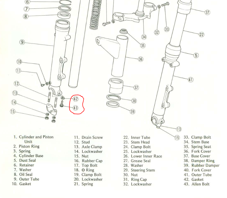

Did you replace the crush washers # 42 with new ones?
they can leak like crazy if not done right.
Note; this is a drawing of a kz1000 fork but I believe the 750 uses them too and I'm pretty sure that a brake line crush washer is what you use.
but make sure
but make sure
