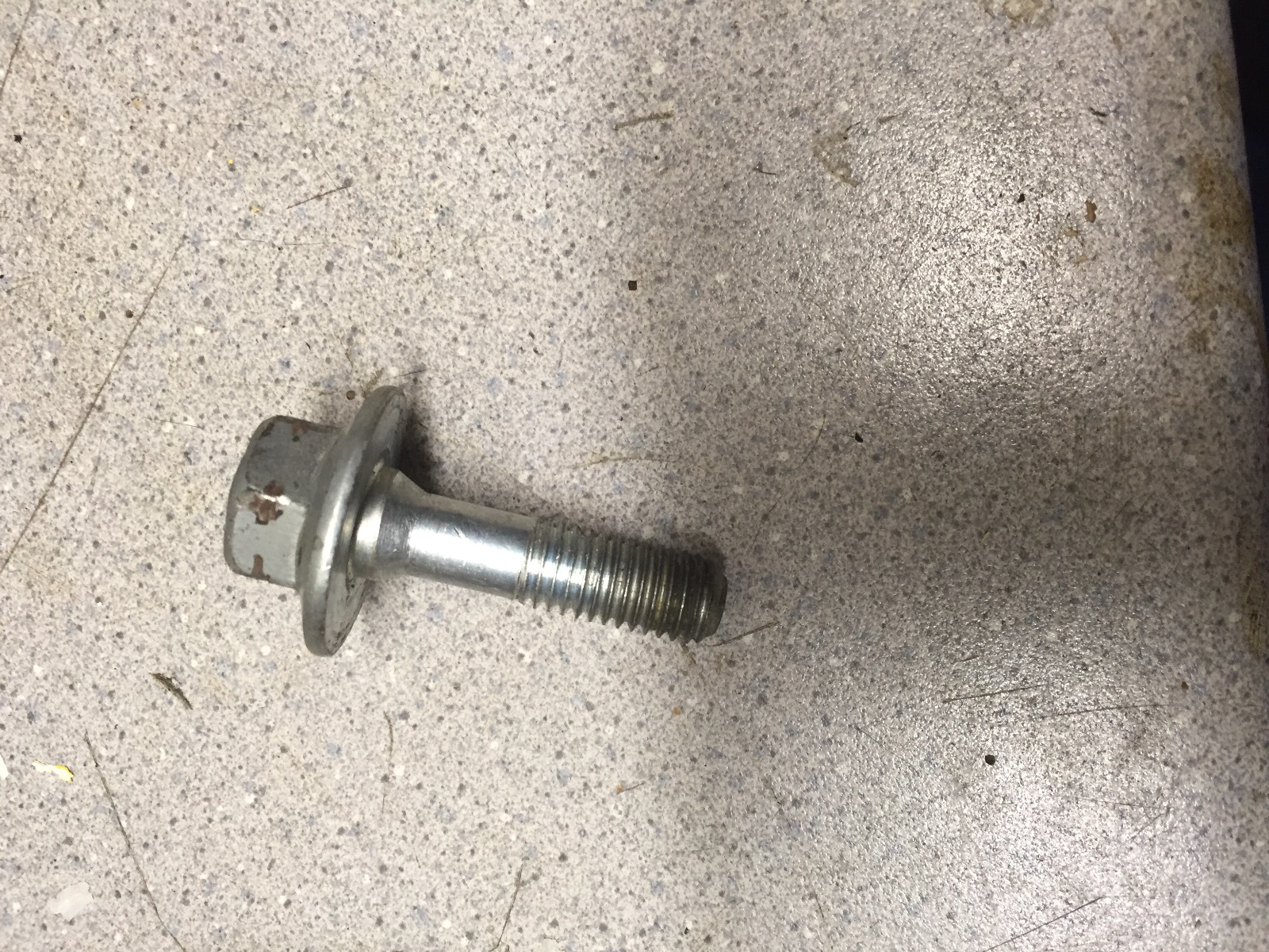

No one has responded to this point. I for one do not know the answer, but from parts lists for you year and model indicate a bolt of 10 x 39 or 10 x 35.
I do not know this for a fact but some online sites indicate that for this size bolt made use of 17 mm heads, others indicate 14mm or 16mm as head sizes for this size bolt.

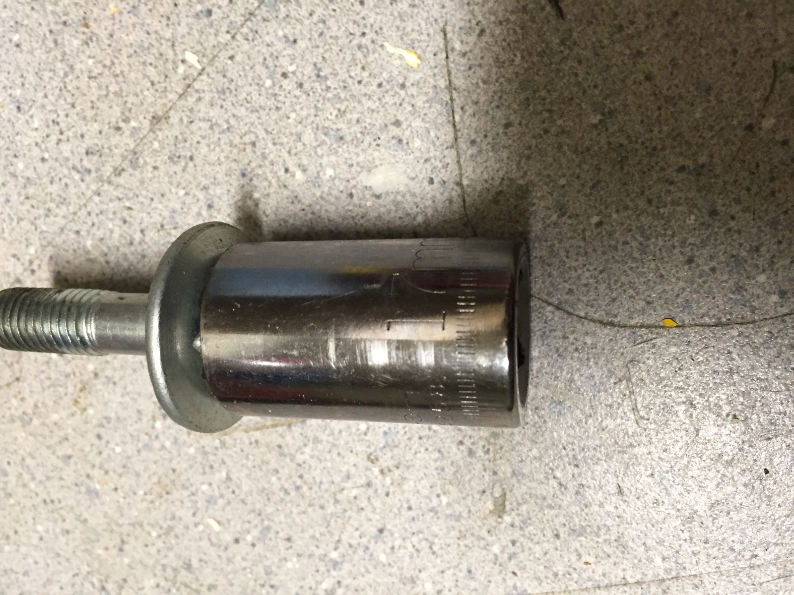

According to Partzilla, all of the 1000 and 1100 engines in 1981 and 1982 use the same 10 X 39 flanged bolt. The one for my LTD fits a 17mm socket perfectly.

No worries. The splines on the shaft and sprocket do all the heavy lifting. The bolt is there only to keep the sprocket from sliding off the splines.
