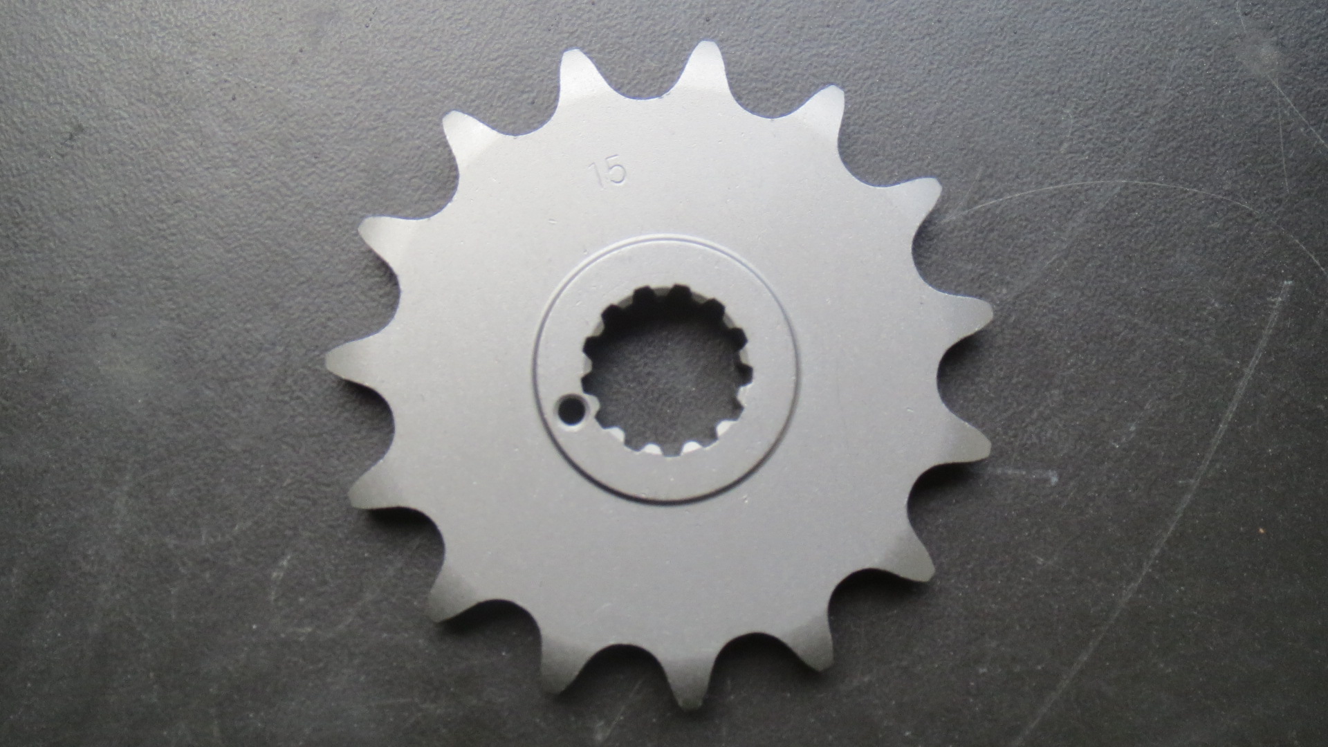

Did you change front sprocket? I believe the factory sprocket has a flange that goes toward the engine. A flat aftermarket sprocket needs a separate spacer.
Mike
Mike

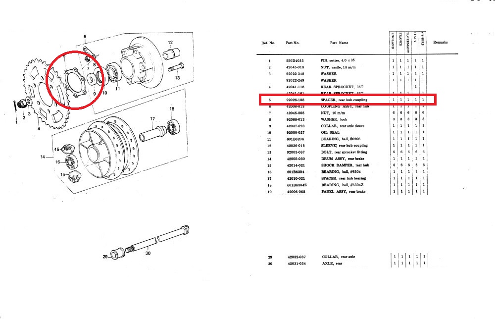

Look at item 31 on this diagram. its used with O-Ring chains. also check out your front sprocket as Krazee1 mentioned
www.partzilla.com/catalog/kawasaki/motor...rear-hub-brake-chain
EDIT, its also recommended that the sprockets be change when you install a new chain.

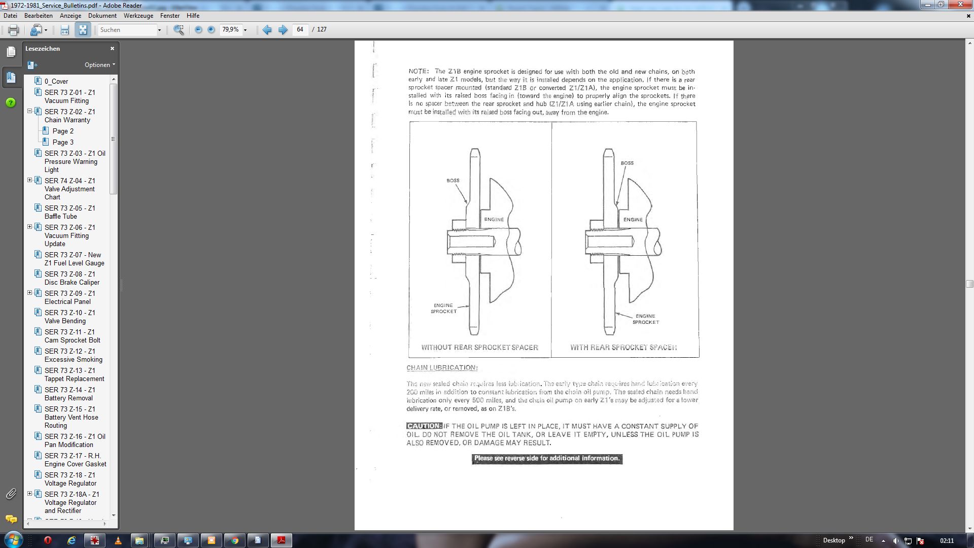

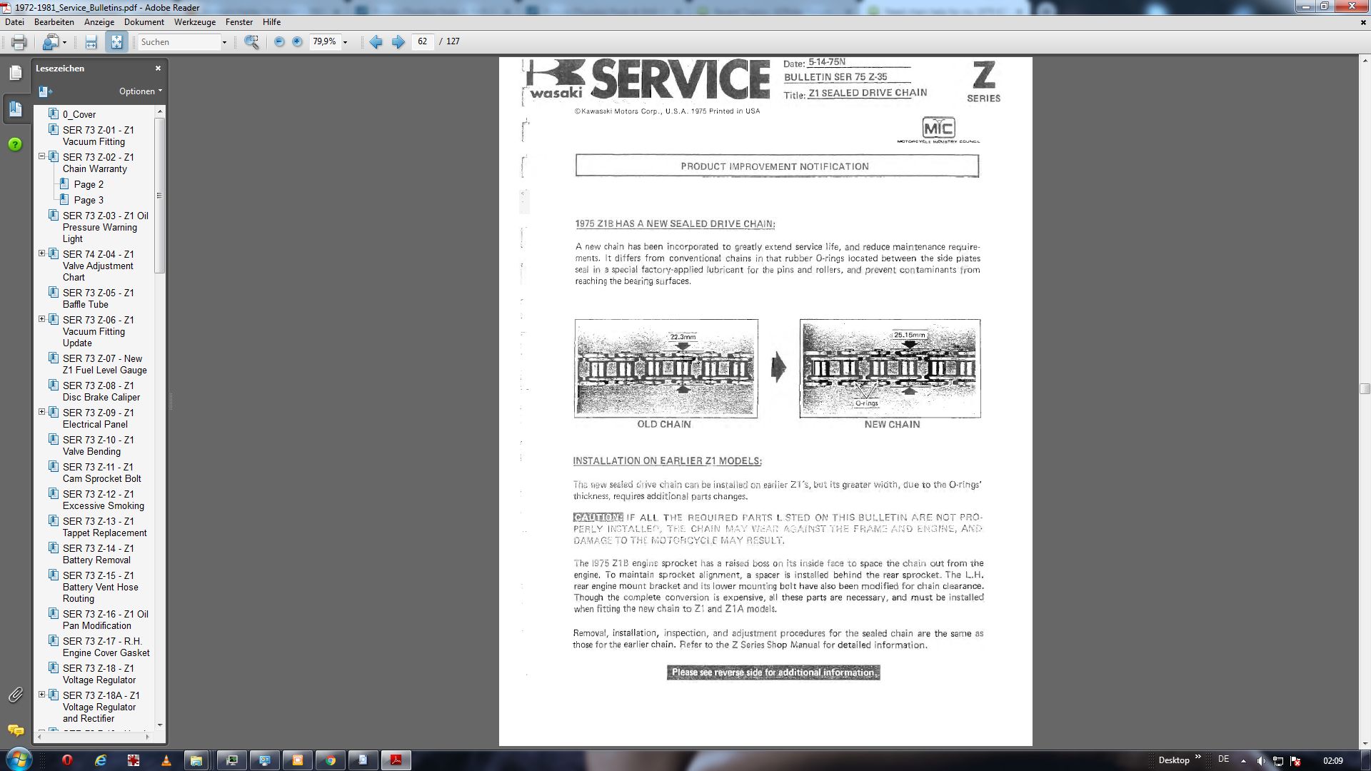

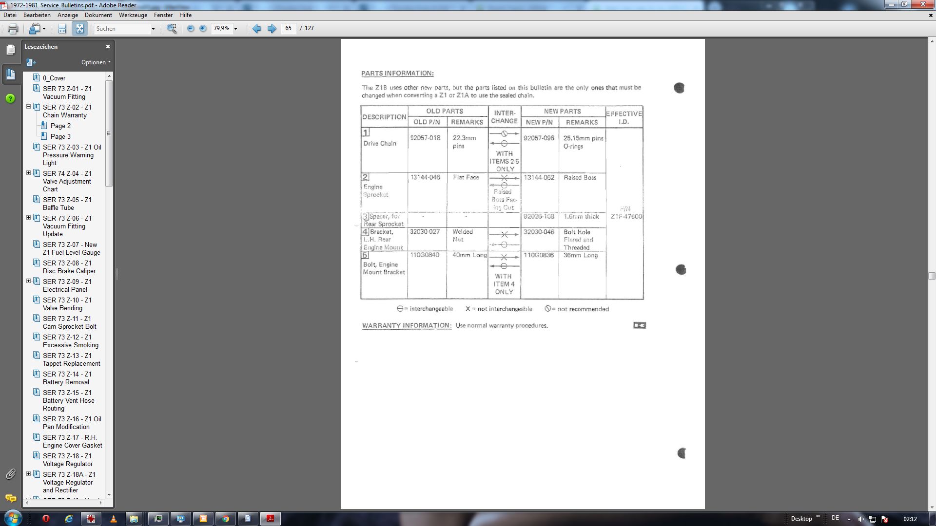

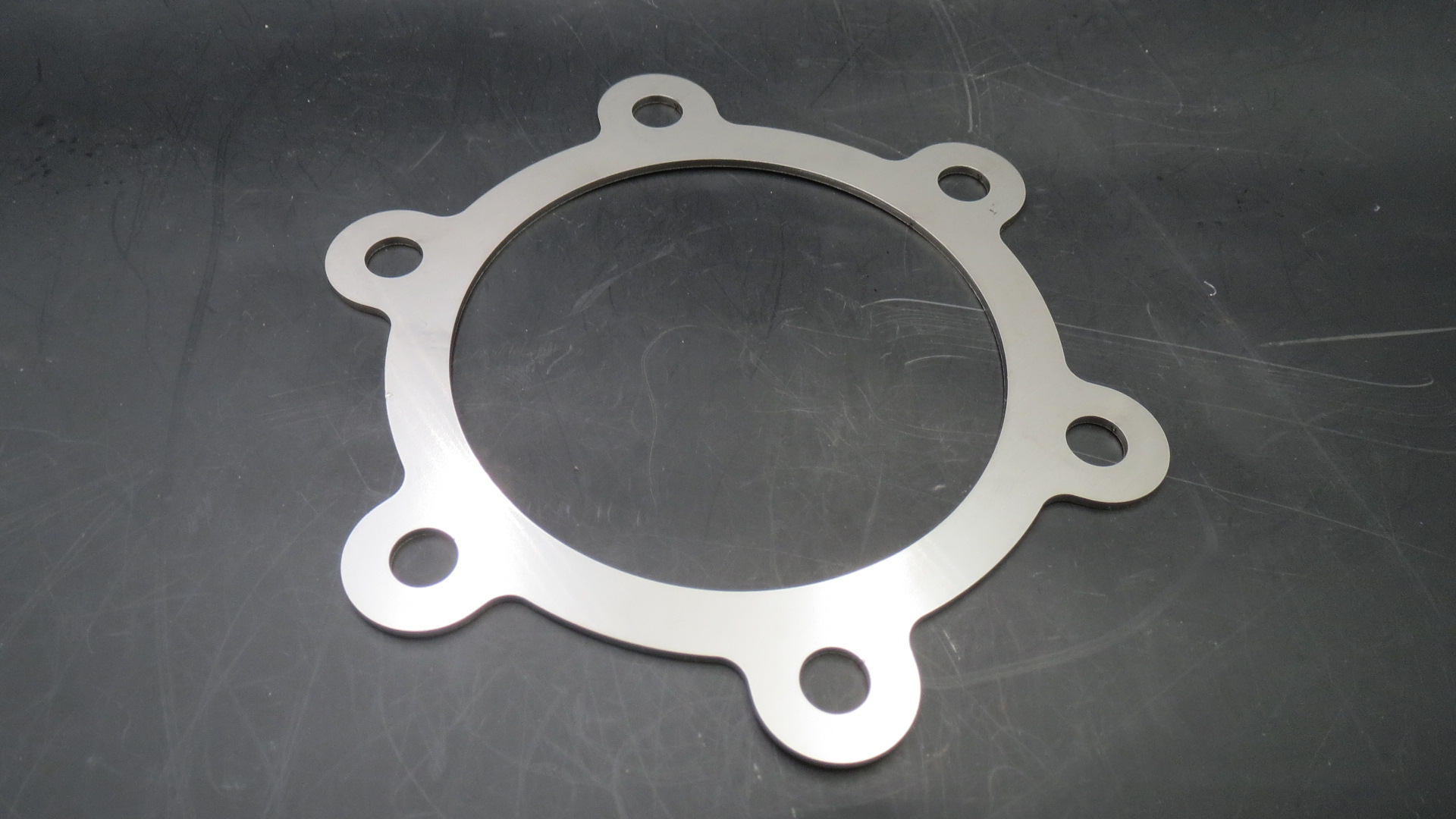

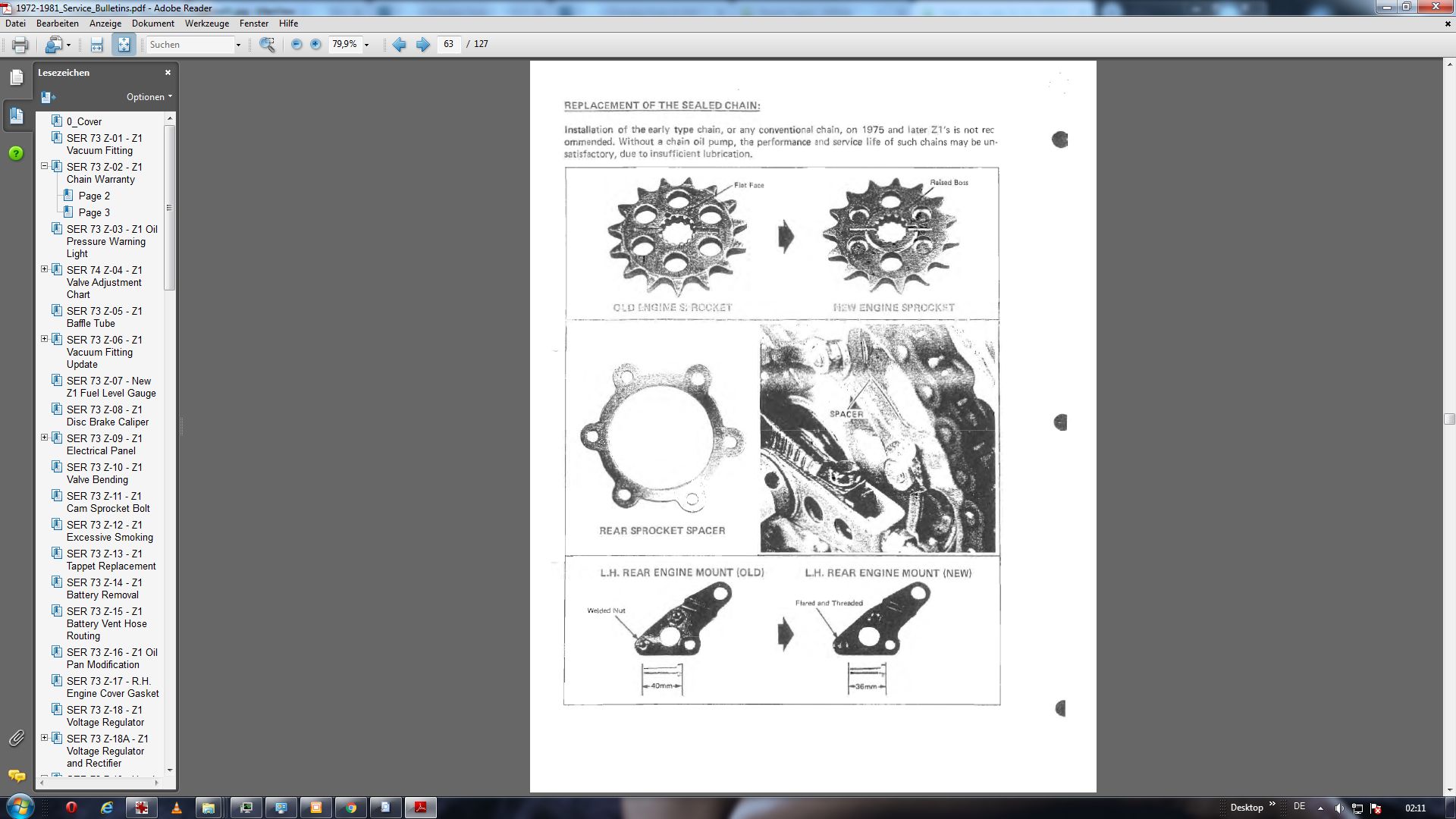

Read the service bulletin 1975 Z-35!!!
You need a front sprocket with a rised boss and a spacer for the rear sprocket.
