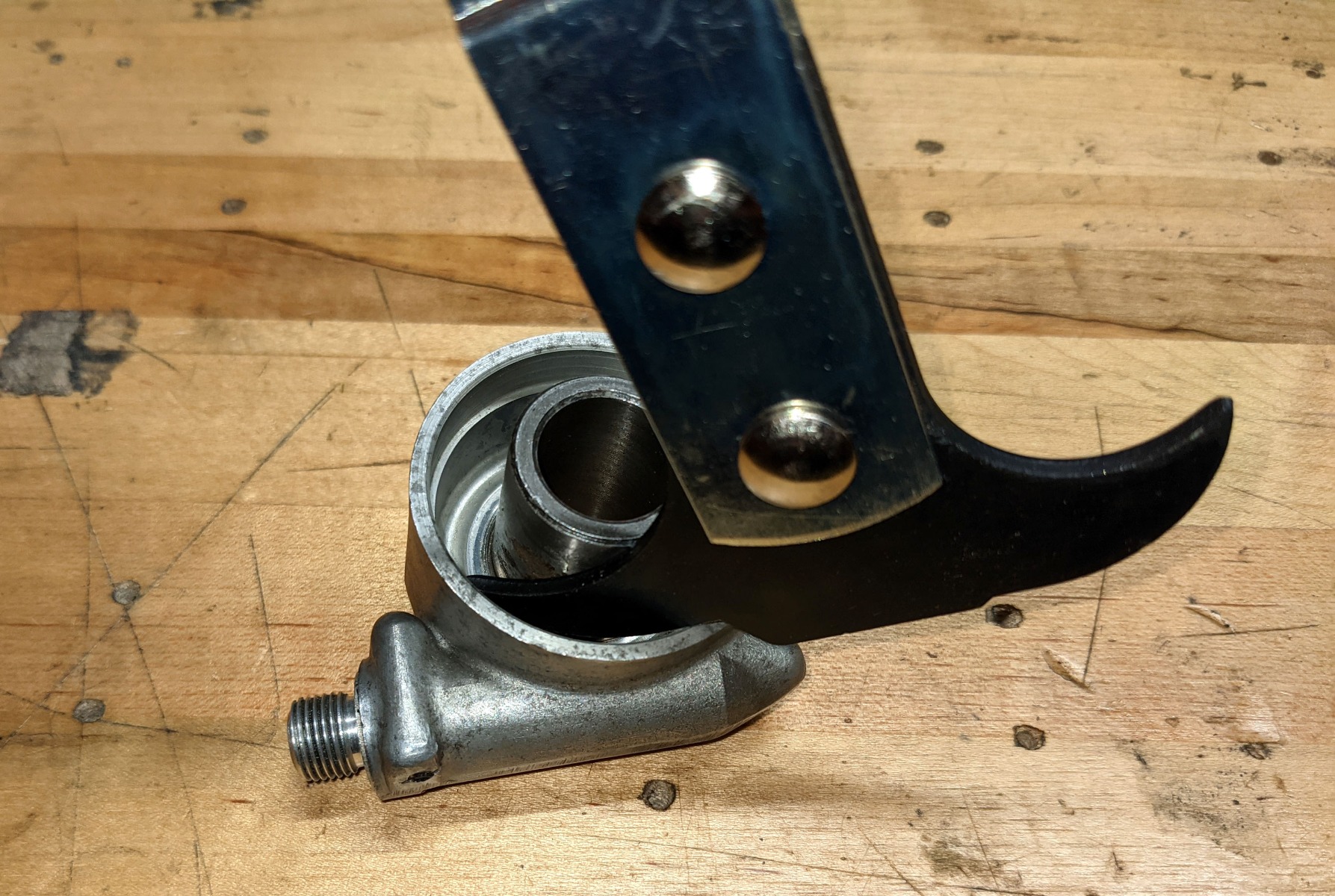

29 May 2021 20:08 - 29 May 2021 20:09I went after this seal today. I don't know what you did with a screw. That wasn't working for me.Mikaw post=841978You can run a screw into the seal, use a small pry bar to leverage the seal out
I was searching amazon for all kinds of oddball pullers and eventually just went and got a cheap standard seal puller. I didn't think it would work, but it came right out. I just cocked it a bit sideways around the center boss.
Man it was very satisfying to clean all that old gunk and grease out of there. I'm glad I went for it.
