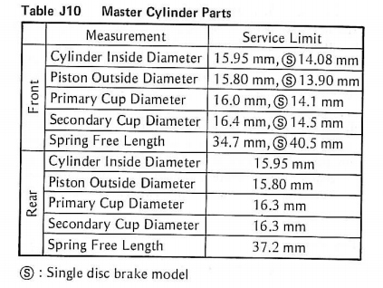

No eBay APP ID and/or Cert ID defined in Kunena configurationOkay, I spent a little time looking at the parts fishe and factory manuals and according to Partzilla the master cylinder piston/cup assembly is used on a wide range of bikes including single disk brake KZ550's, 750 twins, 440's, and the KZ650 B2-B3, (plus others)
www.partzilla.com/product/kawasaki/43020...731ecad49de27beda452
Looking up the service info in the factory manual for the 550 shows that the single disc bikes used a 14mm piston master (dual gets 16mm.)

To visualize what's happening realize that in order to create a specific amount of braking force the caliper piston must move out of it's bore by a certain amount (call it X.)
To move the caliper piston X amount we need a specific volume of fluid pumping through the system.
If the master bore is made smaller than the original size that means that in order to pump that specific volume of fluid the master piston needs to travel further then before.
So in the end, using a smaller bore master will require more lever travel, the lever force will be lower though so it's a trade off. Less travel required but more force OR, more travel and a mushier handle feel. That's the trade off.
