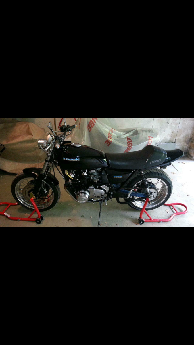

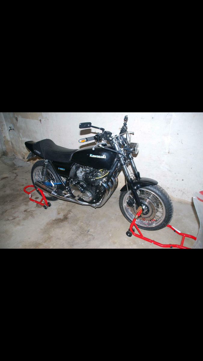

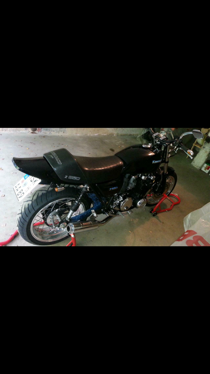

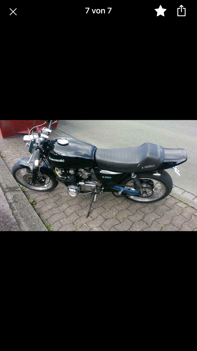

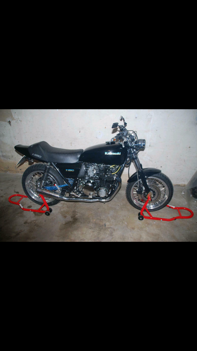

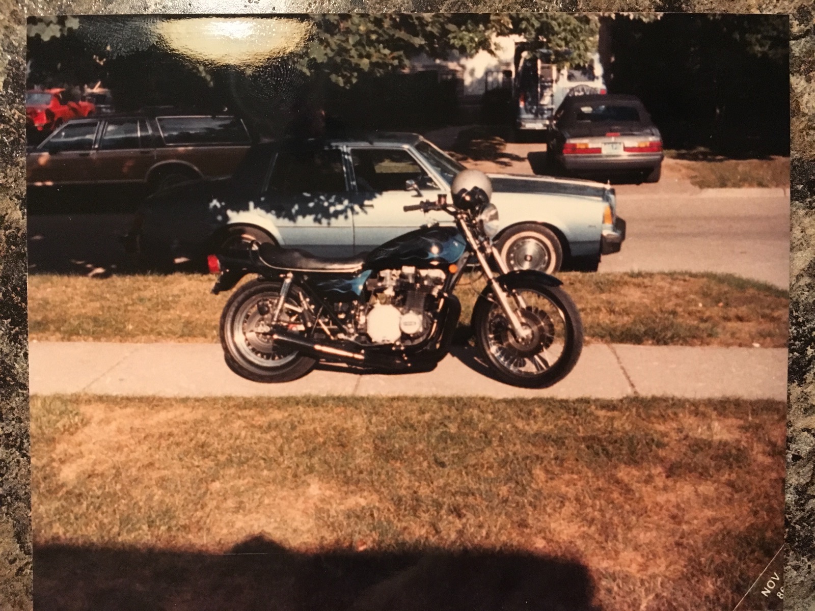

PHOTOS BELOW: KZ650 using my same K&J Swingarm - Front 18x3.50” Rim. Rear 18x5.75” Rim with 180/55-18 Tyre. With tyres this wide I imagine it feels like driving a bus... but yes it clears the chain and frame.
