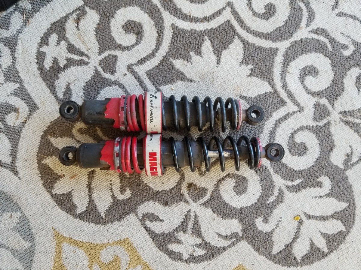

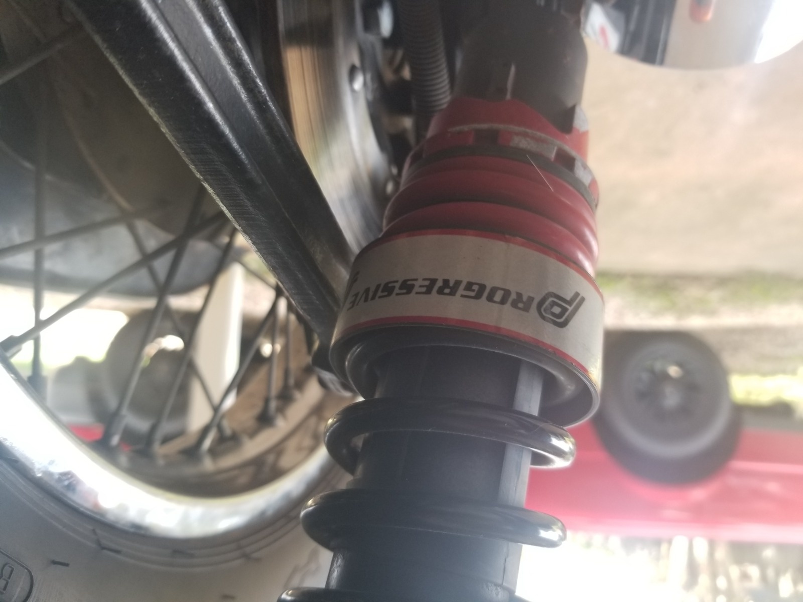

Hoping yall could point me in the right direction of someone who rebuilds old shocks. I already contacted progressive and they dont have a rebuild kit for me.
I tossed a set of hagons on to get me through the rest of riding season. But i really dig the look of these. I knew something was off when i was riding her, but I would've never guessed it was this bad!

Those shocks are not rebuildable other than cosmetically.

If restocycle can't help you, you might be able to just buy some new progressive 12-series shocks and swap over your springs and hardware. They come without springs anyway.
I have some 12-series shocks off of the bike and can make some measurements if you need them.
