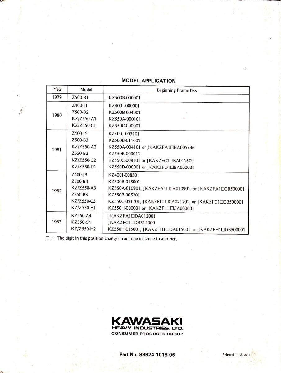

The vin, or frame number, is stamped on the steering neck. There should also be a decal next to it with the date of manufacture. Keep in mind that the model year production does not match calendar year. For example, Kawasaki began building the 1978 models in The summer of 1977.
There is a PDF copy of the 550 service manual under the Articles tab here on KZR. On the back cover, there is a chart showing the vin range for each model year.
