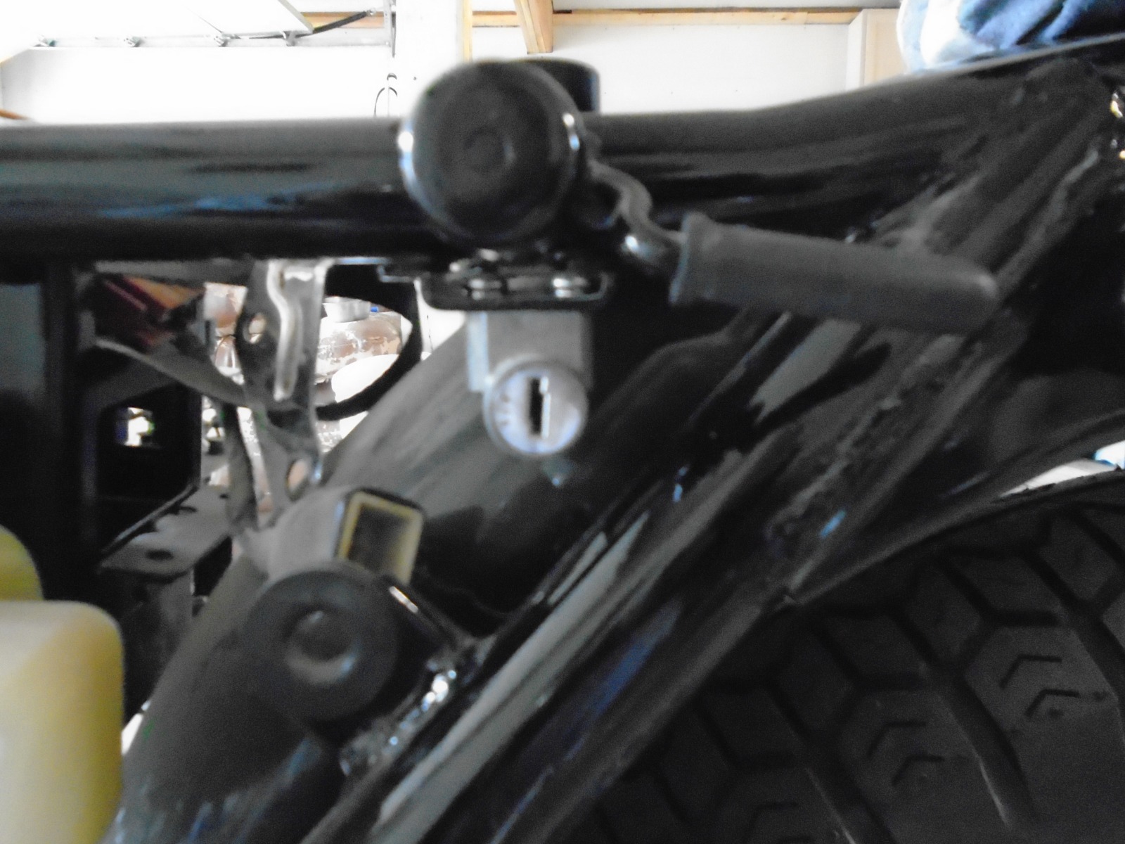

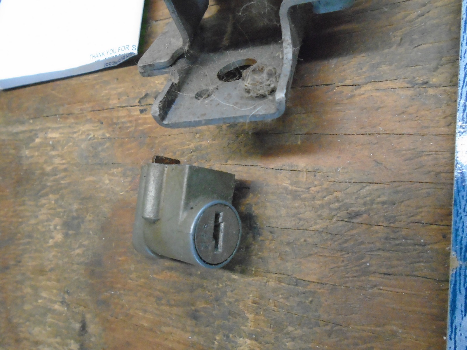

? No wafer locks, don't know what that is? These are seat locks that differ from the 76 and up seat locks, i have a bag of the 76 and up seat locks in various key selections. See pics.

OK so I took a look at the only seat lock I have for my KZ900. Its a matched set so I'm not going to tear into it BUT there is a roll pin located on the bottom of it and I'd assume its what retains the core in the housing. Its pressed in flush with the housing so im not sure how you would get it out, maybe a screw extractor and it might twist out. So that being said without seeing a Z1 seat lock Im just talking out of my backside but it should come apart. If you can get the core out of the housing and you have an extra lock with a number 2 in the key code you could swap it into the 755 lock.
