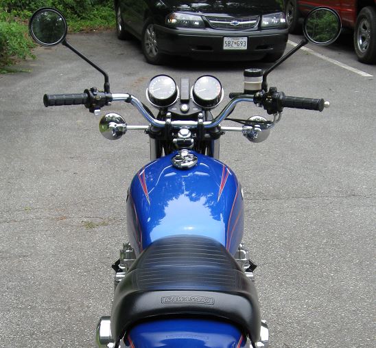

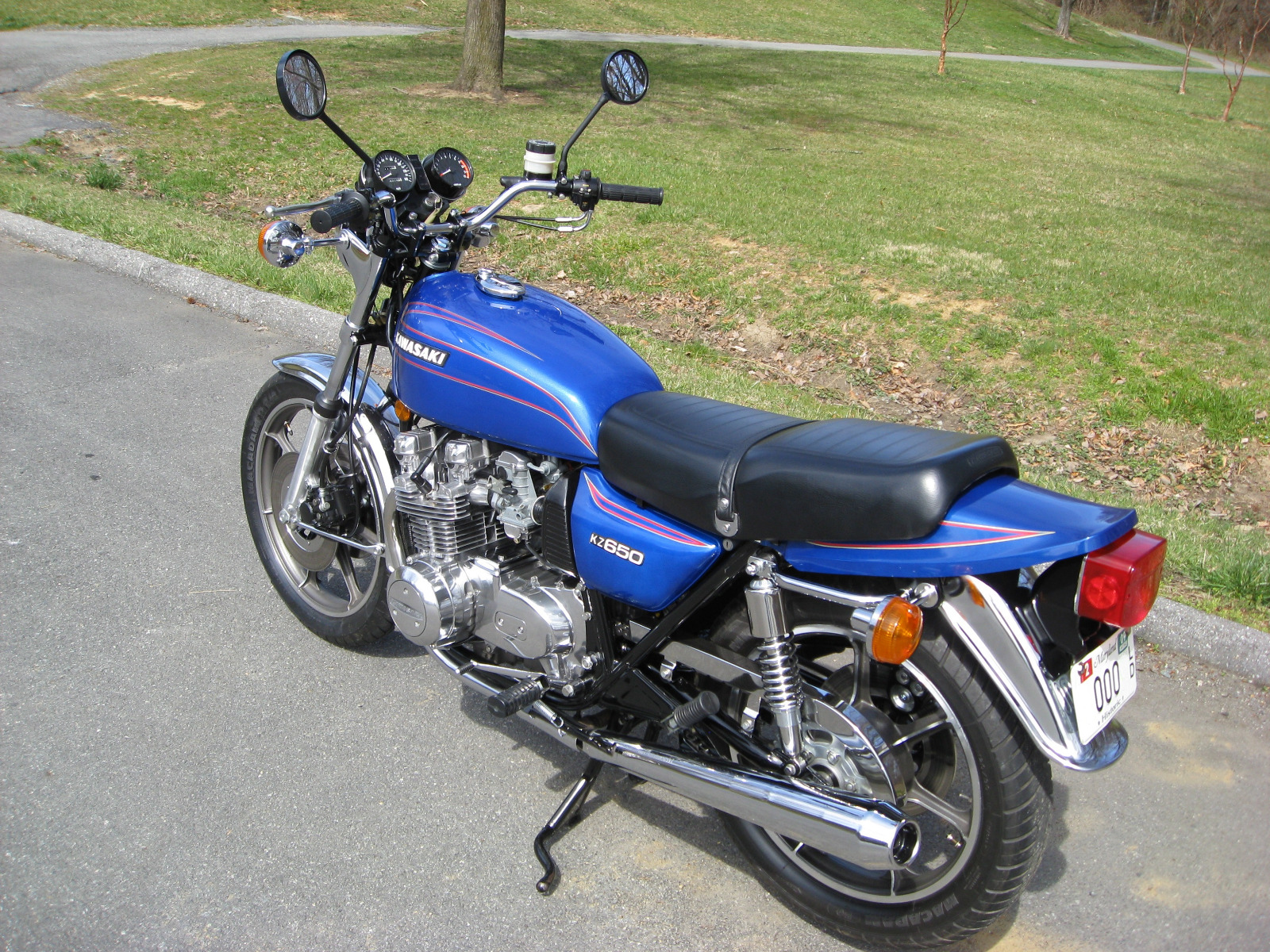

For reference, here's a couple pictures stock 1977 KZ650 handlebars. I'm 6 feet tall and find them very comfortable. Ed
