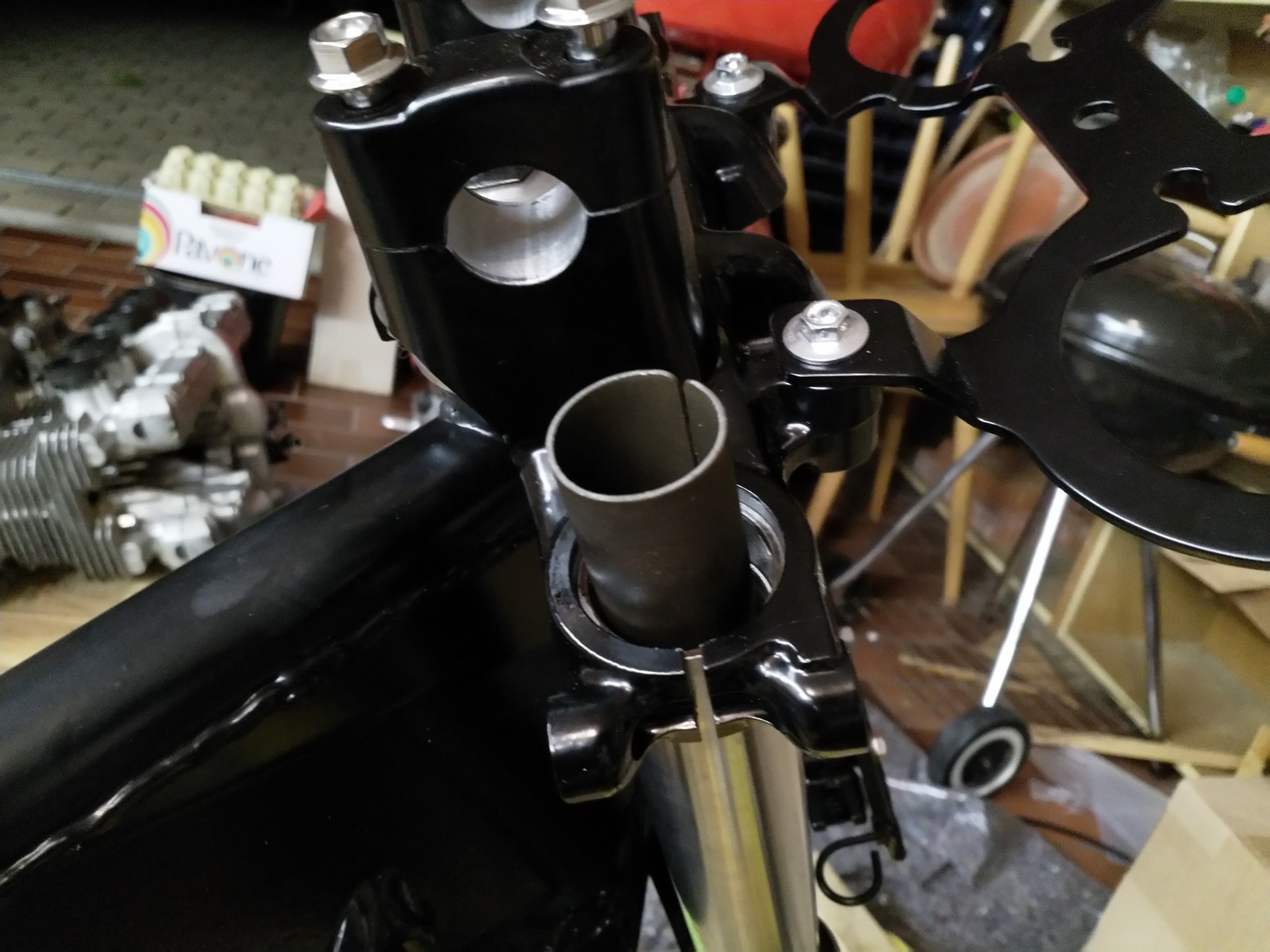

I replaced the springs in my 750H forks with YSS progressive springs but stuck to the standard oil (10W) and level (436mm from top with fork extended). It seemed pretty stiff so I didn't put any air in them.
The problem I am having is the forks are audibly topping out when riding. I thought about putting some air in but that would only make things worse (even more pressure on the extension stroke). I'm pretty sure I just need heavier and/or more oil. Does anybody have a starting point for me? I'd prefer to just top up the oil but if I need to replace it with 15W or 20W then it would be good to know if I stick to the standard oil level.

Sag is OK. To be honest I don't think I could get the top cap on with a longer spacer (the new spring was slightly longer than the original one).
The problem isn't bottoming out but rather that the stanchion is slamming back up into the rebound spring on the damper on the expansion stroke (to much rebound). It just needs more damping but I don't want to risk putting too much oil in. How can I tell what the limit is (to avoid hydrolock)?
At the moment I'm thinking of putting some 20W in there with a level of about 400mm.

20w oil is really thick and will make the forks feel harsh on compression. I'd try 15w first. Before that though I'd make sure that your springs + spacer don't sit proud of the top of the tube with the forks fully extended. If they do you are applying too much preload which can cause your topping issue.

31 Aug 2020 06:41 - 31 Aug 2020 06:42Nessism wrote: Before that though I'd make sure that your springs + spacer don't sit proud of the top of the tube with the forks fully extended. If they do you are applying too much preload which can cause your topping issue.
Mmm... This may be my problem. I did wonder when I assemble the forks but talked to some local guys and figured it would be OK. Thanks Ed!
Guess I need to make some shorter spacers. Should they be flush with the end of the tube?
