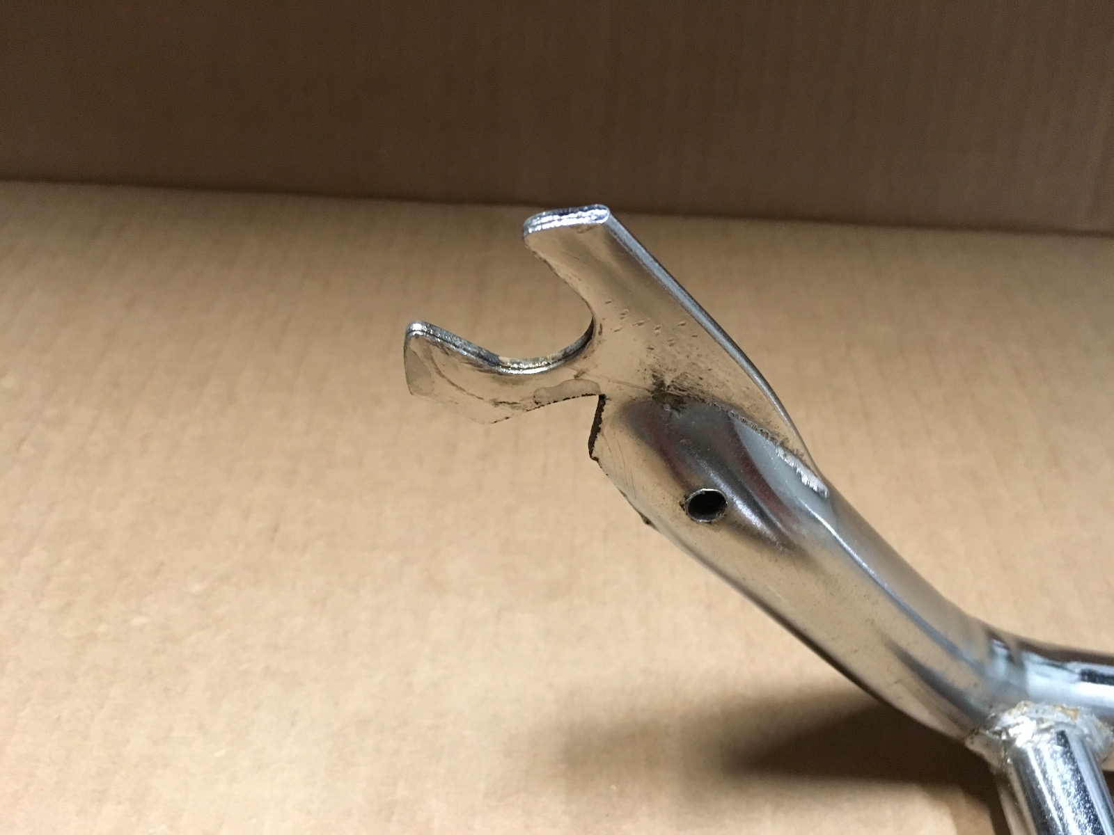

I have one, I’ll post pictures after work today. There is a “V” notch at the flattened area that mounts to the shock upper mount. I think they did it to clear aftermarket shocks. It can be welded up if your painting it. Won’t be offended if you don’t want it.

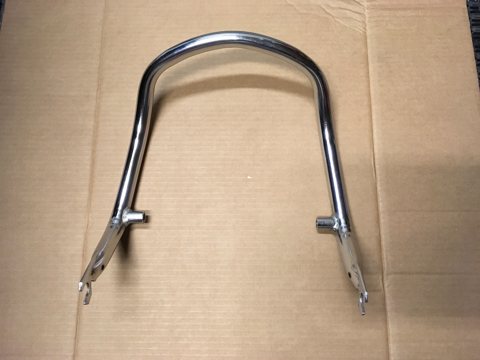

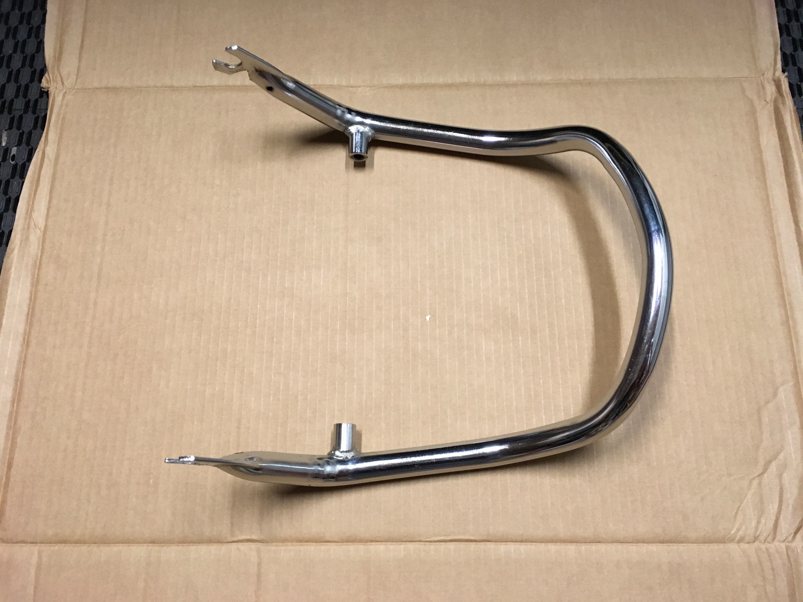

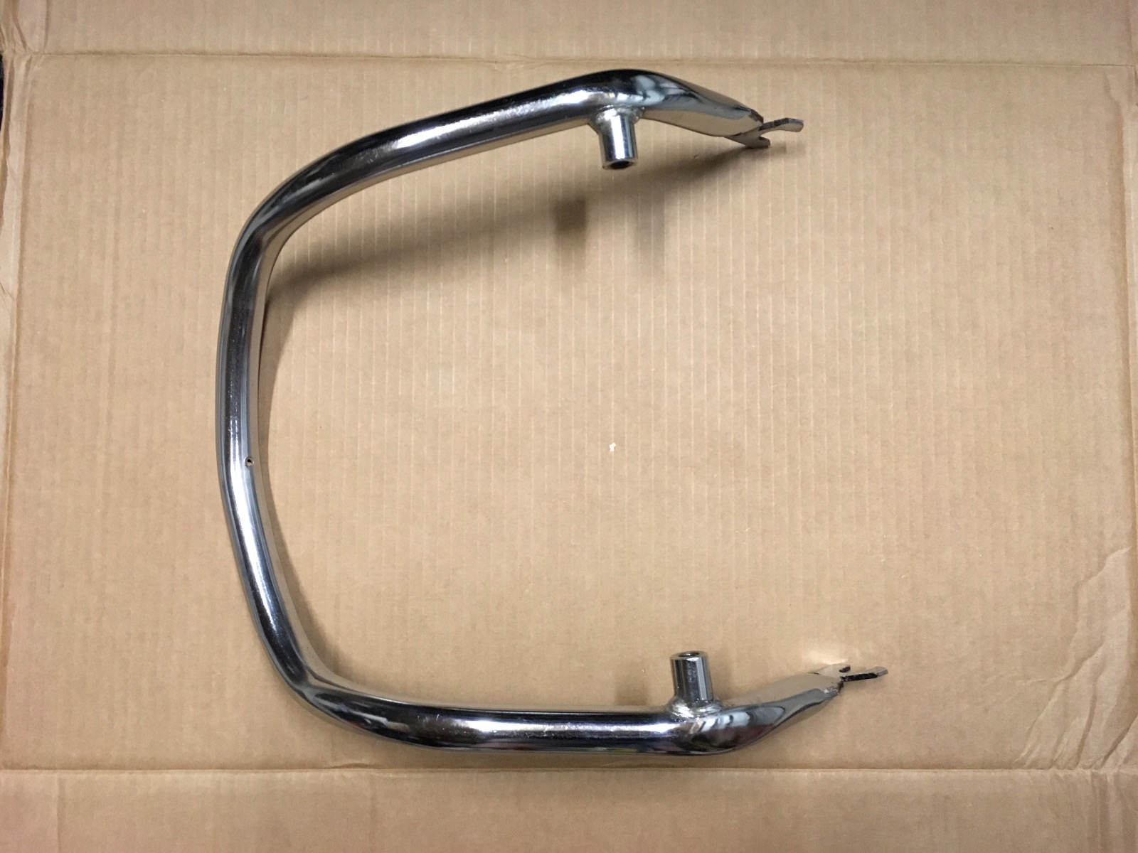

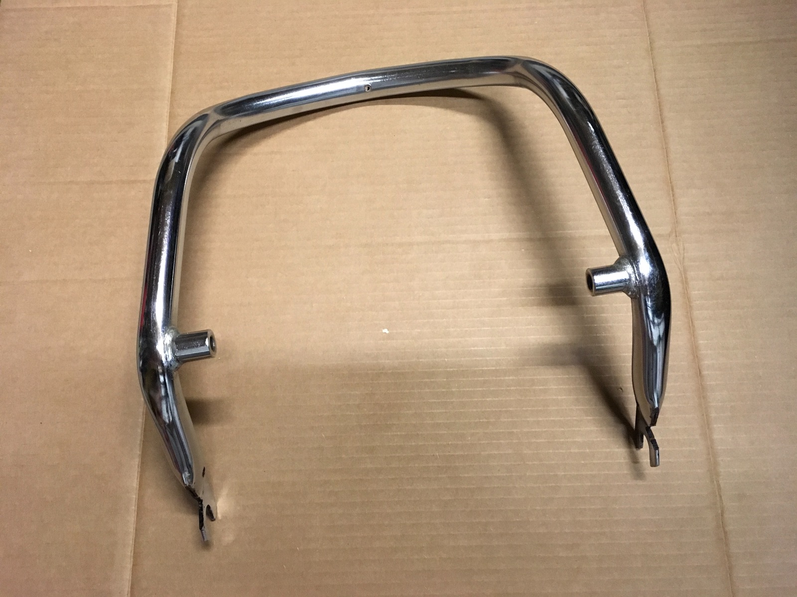

Cleaned up really nice. Not a single heavy scratch. A little surface rust around the mounting boss. What a shame it use to be owned by Bubba! I couldn’t figure out what to do with it so it going to a good home if you accept?

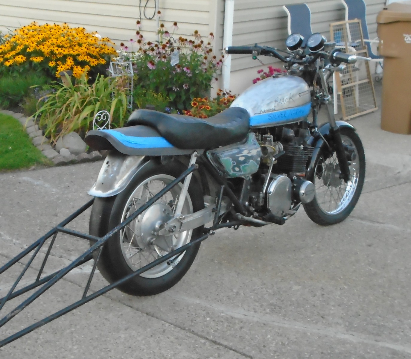

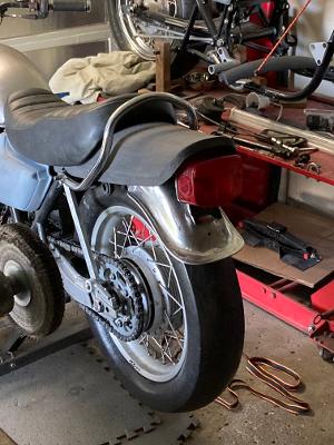

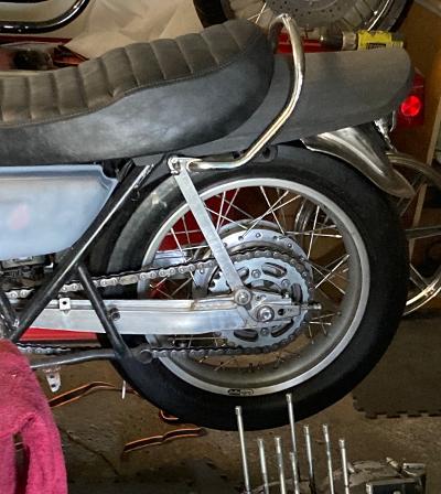

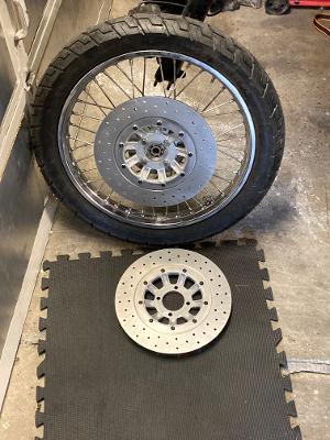

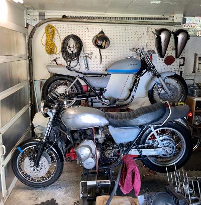

Hi Matt! Forgot to mail you. Bar came and is so nice, I'll leave it chrome. But? Yes for the Red Neck Engineering? I'll give them credit! The cut lines were nice and clean! :laugh: I got this simple look going. I am going to take apart and rake frame this winter. Plus, paint before winter sets in. I put another $20 1978 KZ400 18" rim for front. Did another disc project. I took the 1C rotors I had and ground them down to 5mm from the single 7mm. size. Ben Beasly ( He still makes fiberglass parts) sent me an old school Z1 18" drag bike fender! Stuff all looks good together, I cut back the tail light bracket in 1/2 and re-welded it to tuck in. And My luck! The way the sprockets are! The bike came with a 13 tooth counter shaft already! I was going to downsize it. Already was. 4 gears in the 1/8 mile! The chain adjusters are all the way forward tight! I'll have to down the rear to take advantage of that extra inch of swing arm. Thats what I wanted the GS arm for to bring wheel back a little more. I'll take care of it. Here's a couple pics. Sorry to babble on!

Marty. Funny you posted today, I just had a memory flash wondering if you received the bar. I was really disappointed when I removed the shock nut and the large washer and found the cuts. It was a really nice stay but for the hack. Happy to pay it forward.

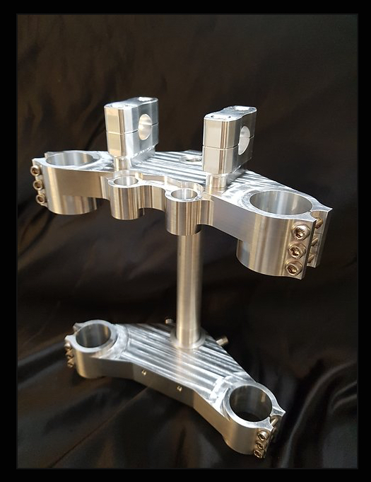

I love seeing the GS 1100 e swings arm. Along with the ‘76 900 project, I’m gathering parts for my next custom build. Using a ‘77 Ltd 1000 frame with the 1100 e swing arm and a ZX9R front end that Billet Bike Bits is making a custom triple tree for the conversion.
