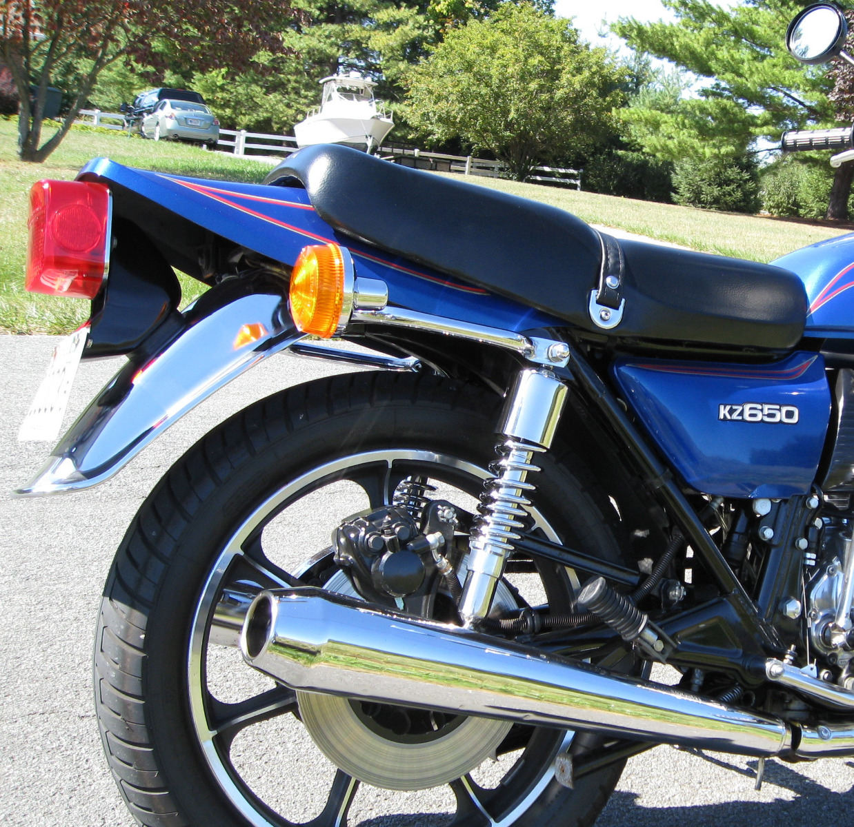

The original shocks on my 1977 KZ650 wore out in less than 10,000 miles (I'm the original owner). I have Hagon shocks (see image below) on it and they work GREAT! I've had them on it for more than 17,000 miles and they still work like new.
