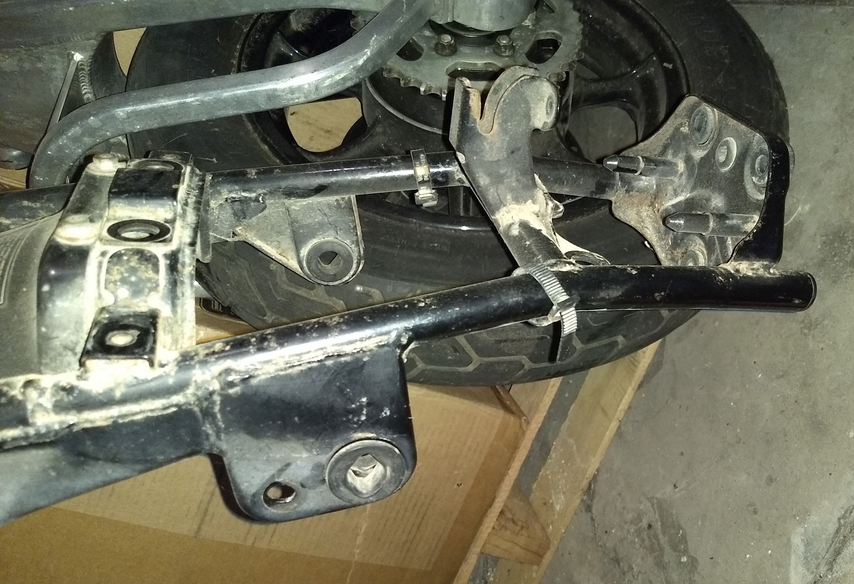

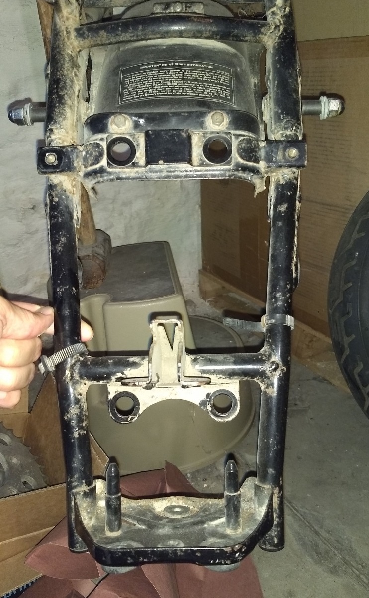

Here are two (poor) pictures of the tail. The seat latch, the rear fender, the taillight, and the rear cowl all mount to the tail section of the frame. But the shape is not that complicated. If you wanted it to be functional, and you had a reference to base it on, you could fab something hold everything in place. And once it's assembled you can't see the brackets. How much is missing? Are the turn signal mounts still present?

Thanks for the pics. That clears it up a lot!
The indicator brackets are still there but it's missing even more judging by your pics.
Is that for the seat to latch?
If it's functional that would be fine by me. just so I have the right dimensions.

28 Jul 2020 14:41hvdm wrote: Is that for the seat to latch?
The part you circled is the base of the seat latch bracket, but it looks like most of it has been cut off.
It still has the fender mount, so that's good.
