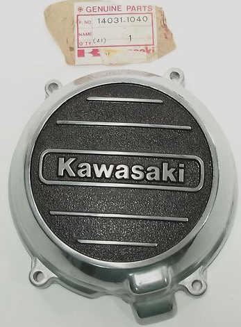

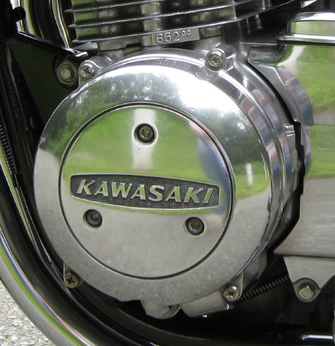

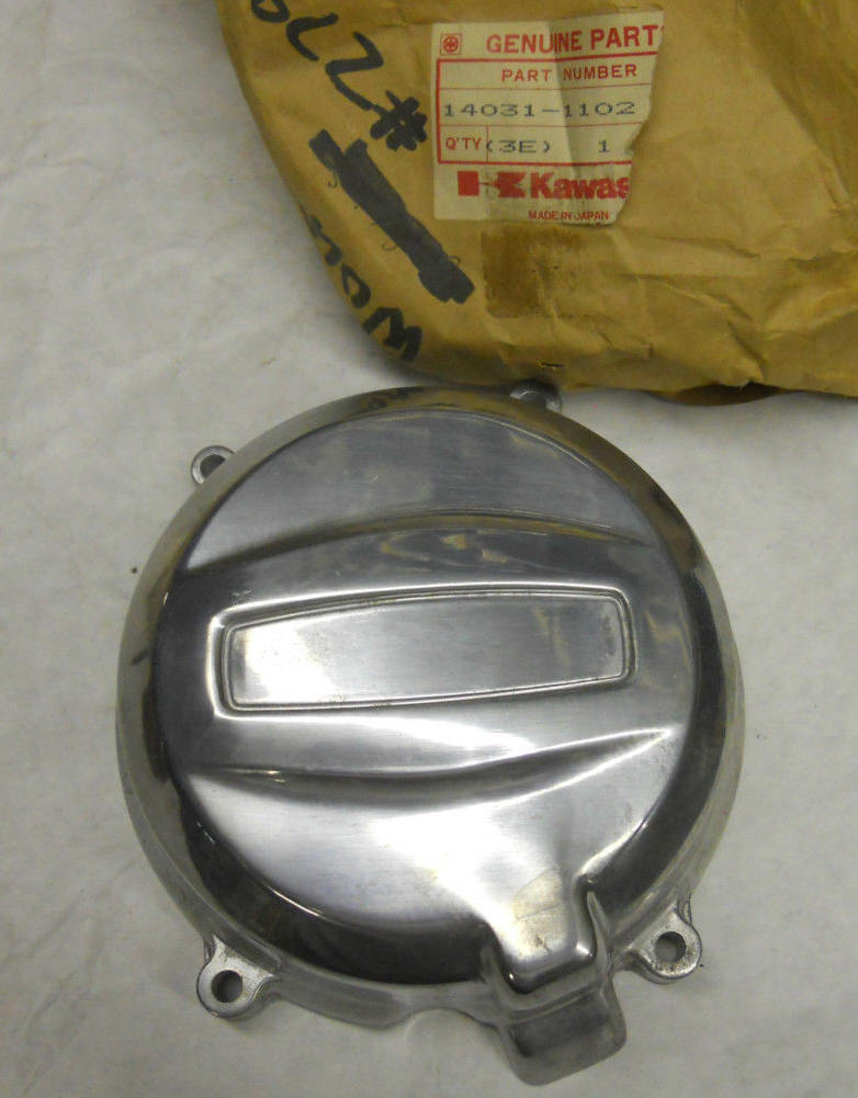

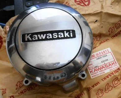

Your frame number as shown is 046217. That number falls within the 1977 KZ650-B1 frames as shown at the models.kz650.info/index.htm site. The red paint is absolutely normal for a 1977 KZ650 as it was one of the two colors available on the 1977 KZ650-B1 models; the other color was green. That same site shows that your engine number BE092109 appears to be from a later bike. Take a look at the left side of the engine and compare it to the images below to see if the engine is that of a 1977 model. Ed
1977 Generator Cover
1978 Generator Cover
1979 Generator Cover
1980 - 82 Generator Cover
1983 H3 Generator Cover
Last edit: 27 Jul 2020 09:55 by 650ed.
