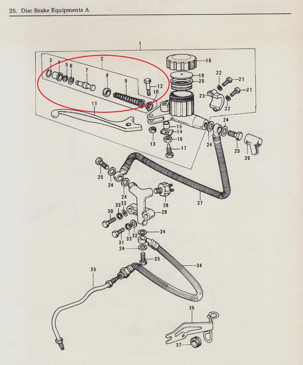

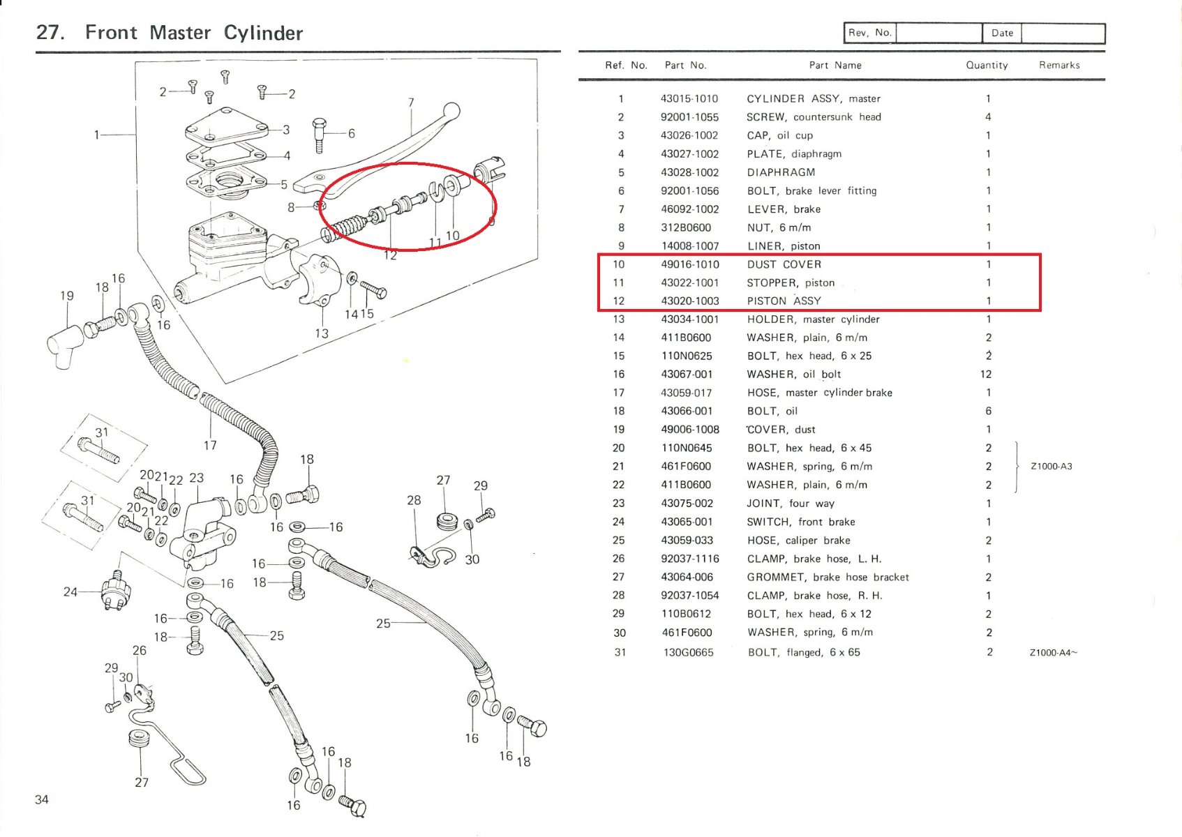

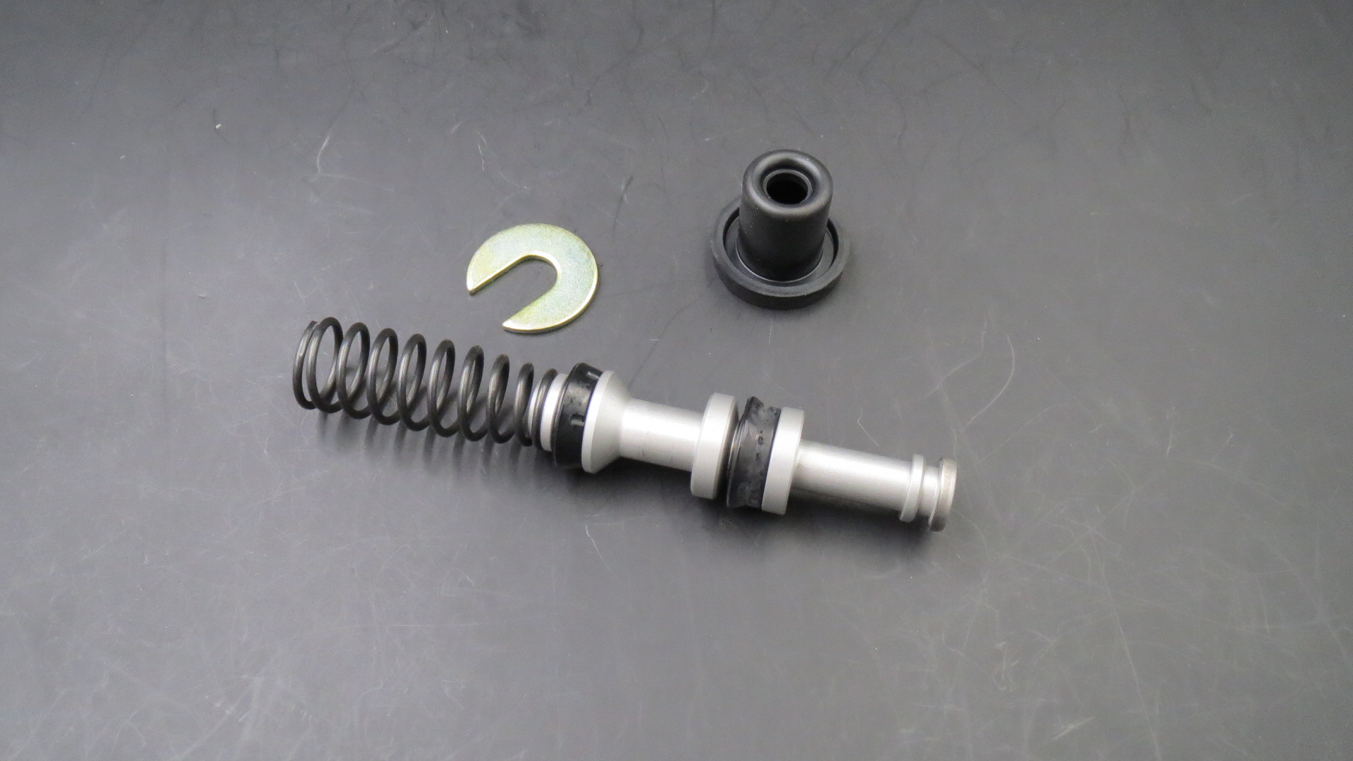

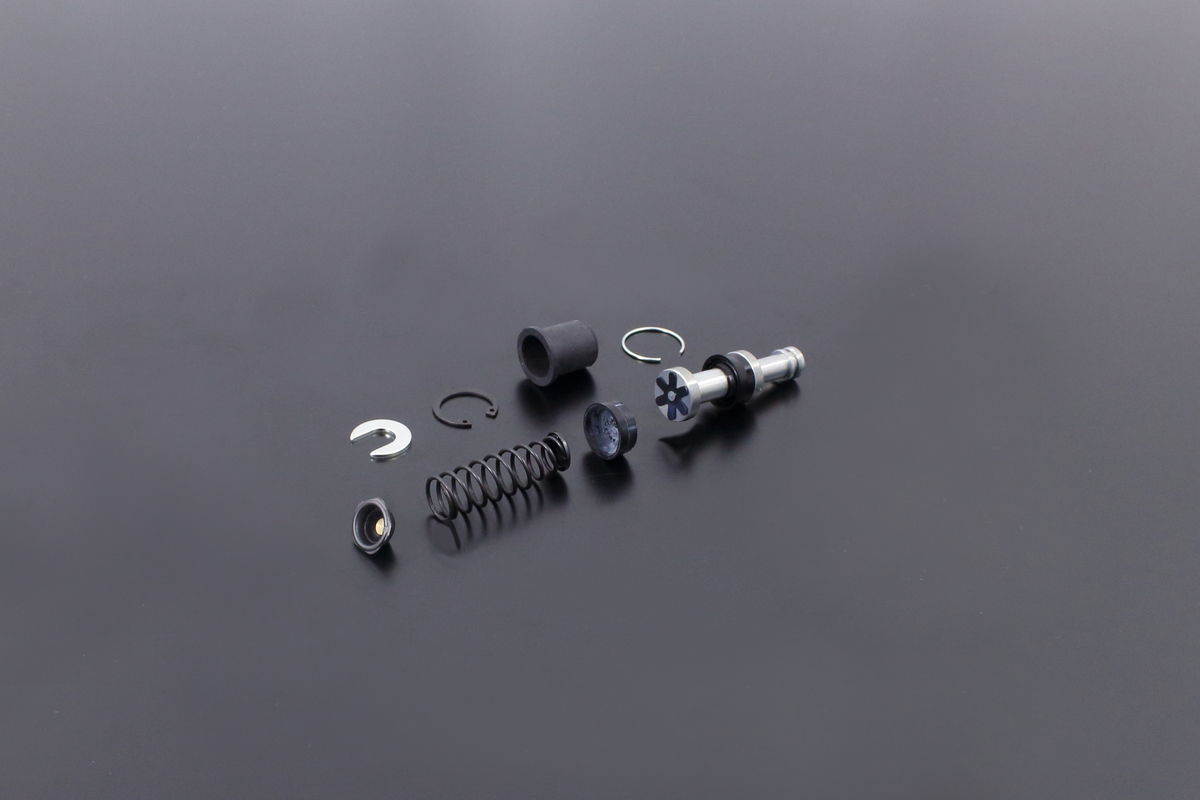

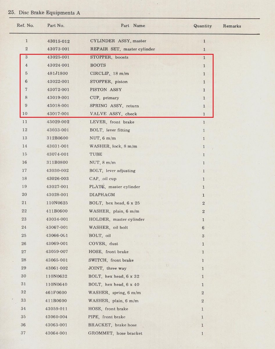

The master cylinder has two seals. The front one holds the brake pressure. The rear one keeps the fluid from leaking out of the back of the piston.
Yes, a rebuild kit will replace both seals. Unless the cylinder bore is pitted, this should make it work like it's supposed to.

Single disk with 14x52mm (diameter/length) and round reservoir cap.
double disk with 15,8x62,7mm (diameter/length) and trapezoid reservoir cap.
