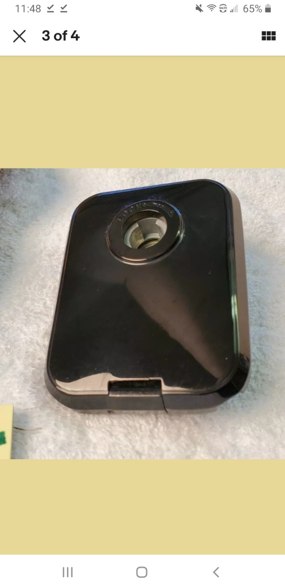

Wondering if someone know how to replace the key lock rotor from the fuel tank
Fuel cap 51049-1084 kz1000 police
81 kz1100 broken girl

No eBay APP ID and/or Cert ID defined in Kunena configurationDid you try disassembling the fuel cap yet? There are a several screws on the underside. keep in mind that when you take it apart there's a latch spring that could go flying.

No yet, I just got the fuel cap. I was going to check that it can be install on the kz1000 tank I have.

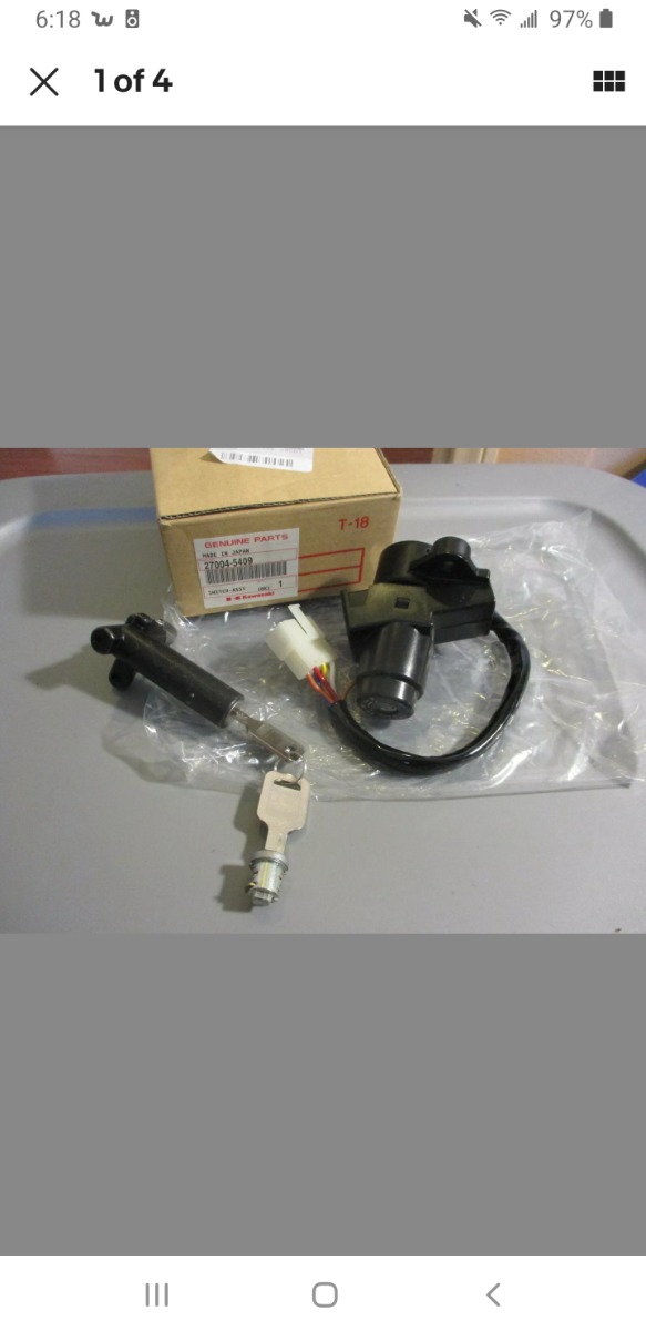

I need a new ignition switch for my 82 kz1100, I was able to get this set
27004-5409
Which it come with a key lock rotor. So I just bought a police fuel cap.
Now I have a ignition switch and gas cap work with a kawasaki key
27004-5409
