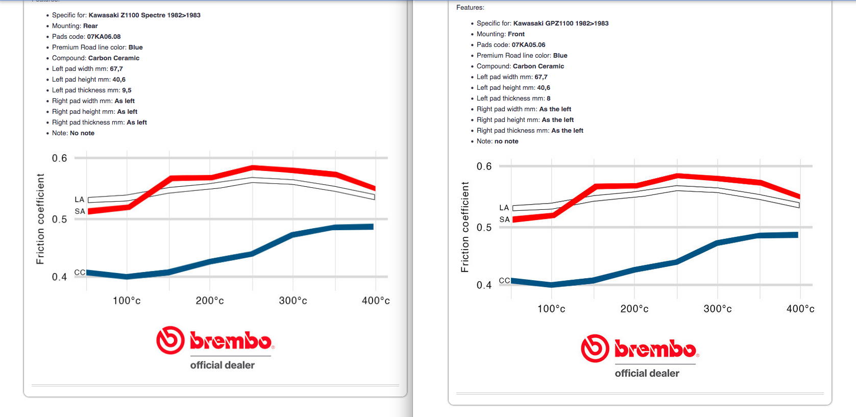

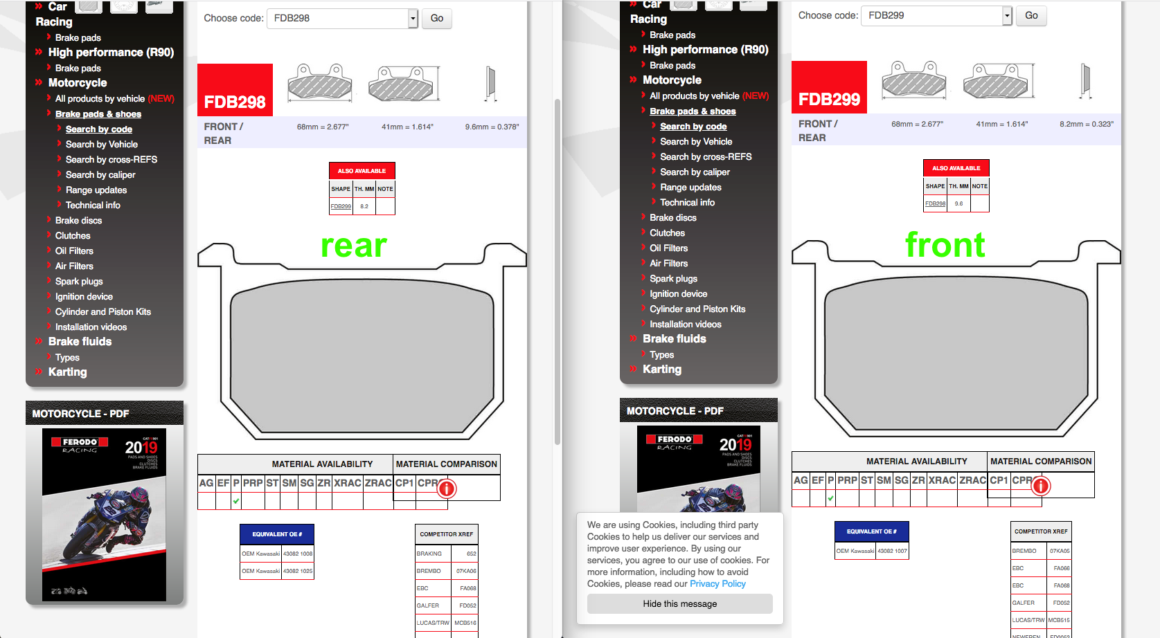

rear is 1.5mm thicker than the front
photo: ecat.ferodoracing.com/product-line/motor...nd-shoes/code/FDB299
Photo: www.omniaracing.net/en/brembo-front-brak...821983-p-169688.html

Ah, so it's the thickness. Huh. I never noticed. I'll have to see if I can find specs on thickness in the manual somewhere. I wonder if aftermarket universals are averaging the two or just going with the thinner spec, or even the thicker spec.
