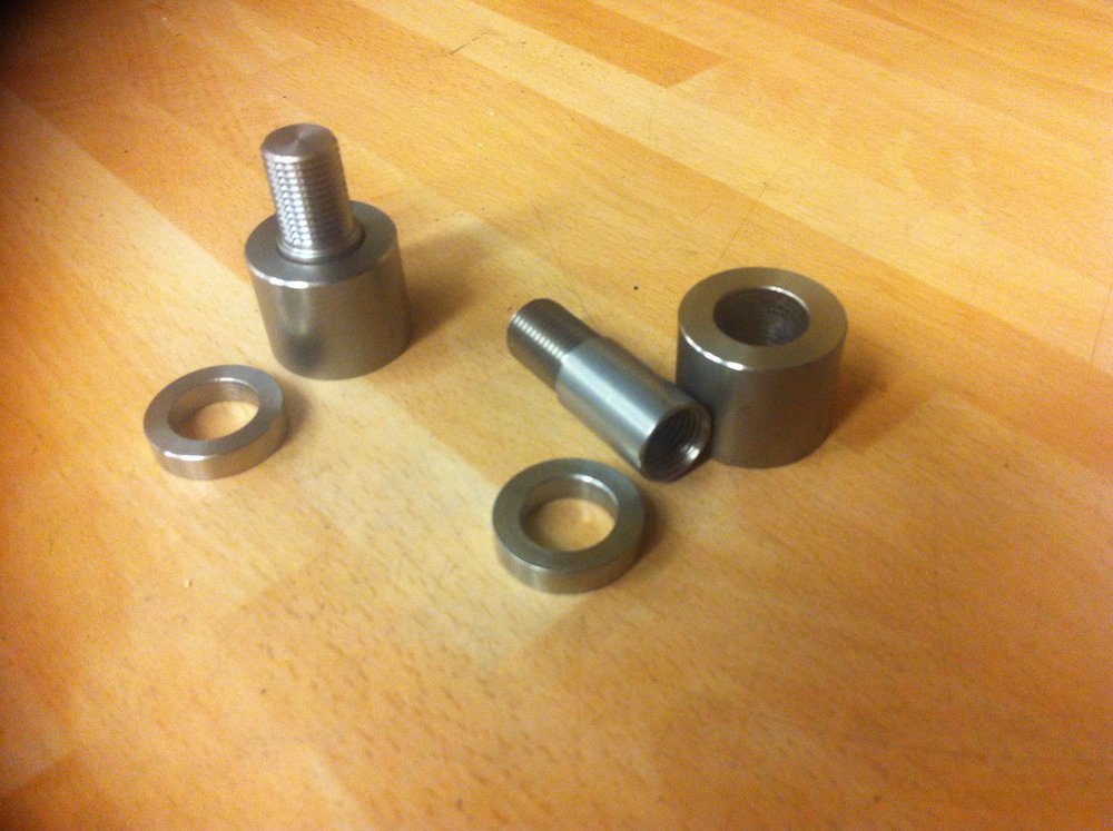

This is what you need.
These are made by a Z1 GB forum member but anyone with access to a lathe should be able to make you some.
z1ownersclub.co.uk/phpBB3/viewtopic.php?...lit=shock+extensions

If you do not have a local favorite, I suggest contacting Les at PDM. There is a link at the bottom of the page. He is a long time KZR member and has mad skills.
