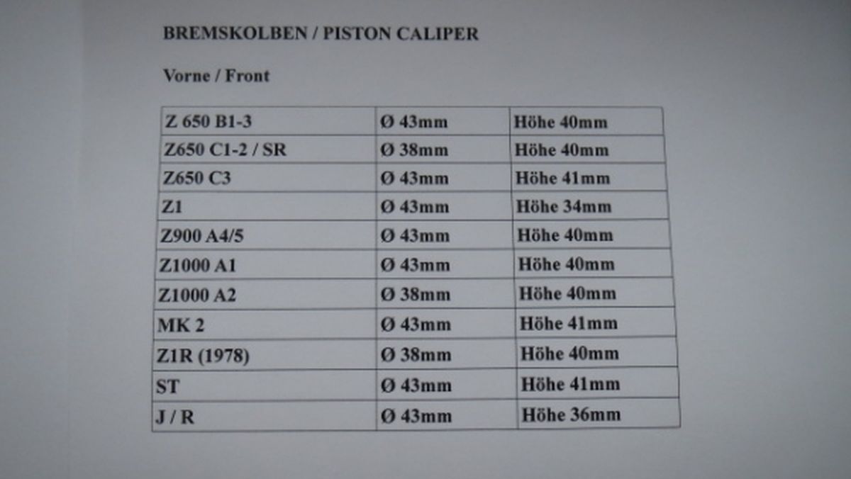

Just some caliper piston and model chart. (Höhe = high or length of the piston)
Last edit: 01 Jul 2020 19:26 by Scirocco.
